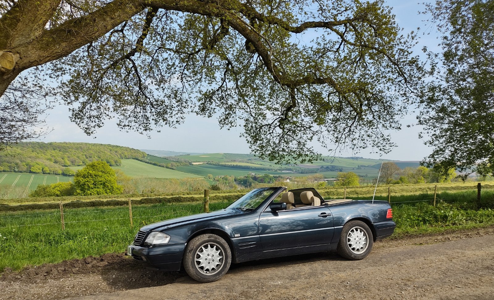

Only a small update - I'd fitted the second hand Lithuanian air conditioning condenser the other week but only managed to get it into a garage this week to get the aircon system vac'd, tested, and filled. I'm very happy (actually, relieved !) to say the aircon all works as it should now :)
Obviously, over the last two days it's been absolutely necessary for me to take it out for a couple of test drives to make sure the aircon still works :-D
Up on the Downs  - own work

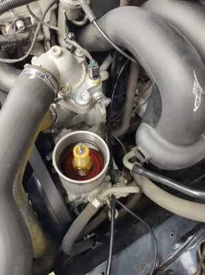

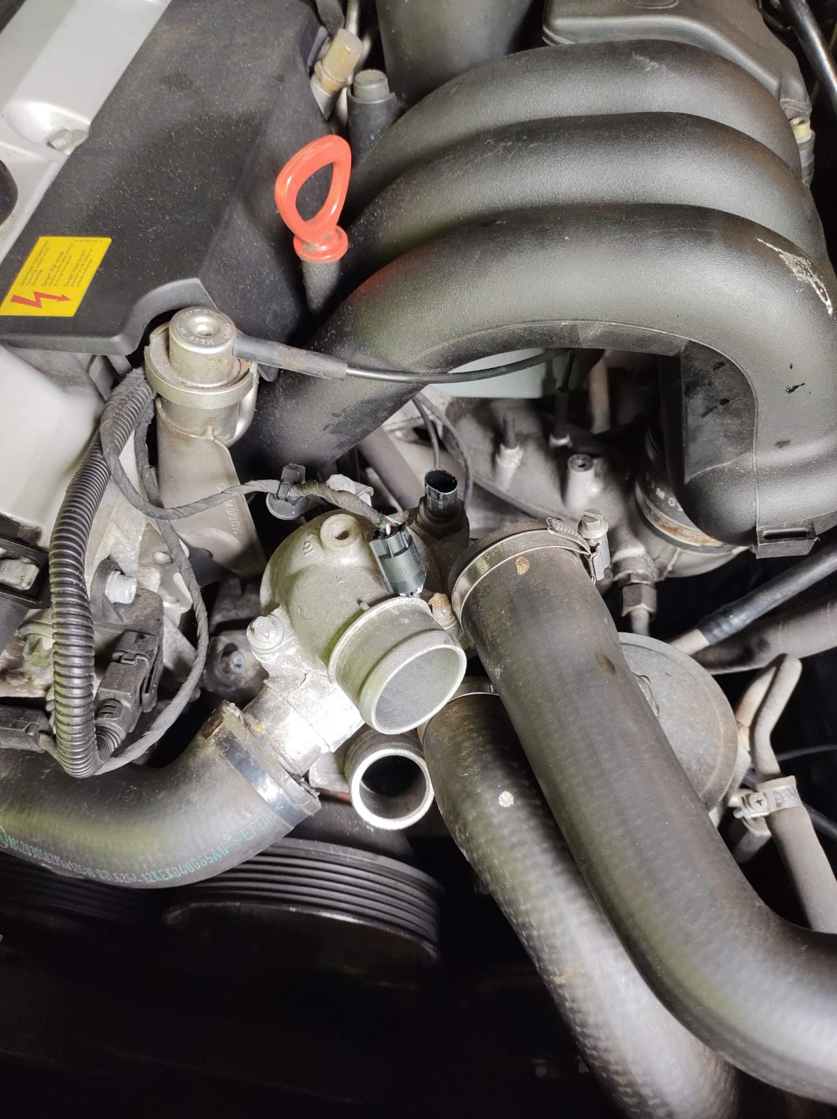

I'd noticed the water pump had a slight amount of play in it - no leaks, no unpleasant noises, just a bit of up and down movement on the shaft, so I thought it wise to replace it at leisure rather than replace it in desperation. I used an INA Schaeffler one as it didn't seem wise to go cheap.
Not too bad a job actually. The drain down point at the bottom of the radiator was easy to get at and the bung undid without any problems, all the nuts and bolts holding the water pump on just undid like they were only put on yesterday, and the internal waterways were spotless with zero signs of corrosion and muck. It all seems too easy - I'm not used to this sort of thing happening :lol:
There's a water pump under there somewhere - own work

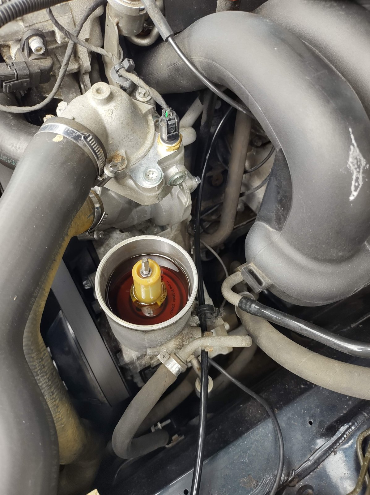

Another job was replacing the power steering fluid and fluid filter. You can remove one of the power steering pipes and pump all the fluid out and replace it...... but the more enlightened bodger home mechanic sucks all the old fluid out of the reservoir and drops in some new, then runs the car for a minute whilst doing a bit of steering, then sucks out the fluid and repeats the process until you've gone through about 2 or so litres of PS fluid. No leaks, no mess, no fuss. Perhaps I should have dribbled some PS fluid all over the place just 'for old time's sake' as it all seemed to go remarkably well 8-[
Power steering reservoir with new fluid, and new water pump behind - own work

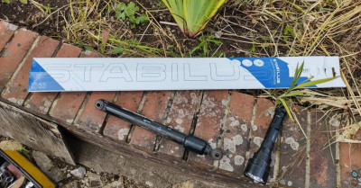

Now for a more grubby job that surely must throw up some issues. I wanted to fit a new replacement steering damper to see if it improved the steering along with the new PS fluid. I put the car up on some shallow ramps to see what I could curse at find. Oh !..... I can get to each nut and bolt of the steering damper from each side of the car without fully having to get under the car and without removing any under body gubbins..... and each nut and bolt undid easily and nothing was seized.... and the old damper easily came out.... and the new one easily went in. Clearly I'm operating in an alternate universe. Car things never go this easily [-X
Old steering damper, not too bad condition.. New damper box. - own work

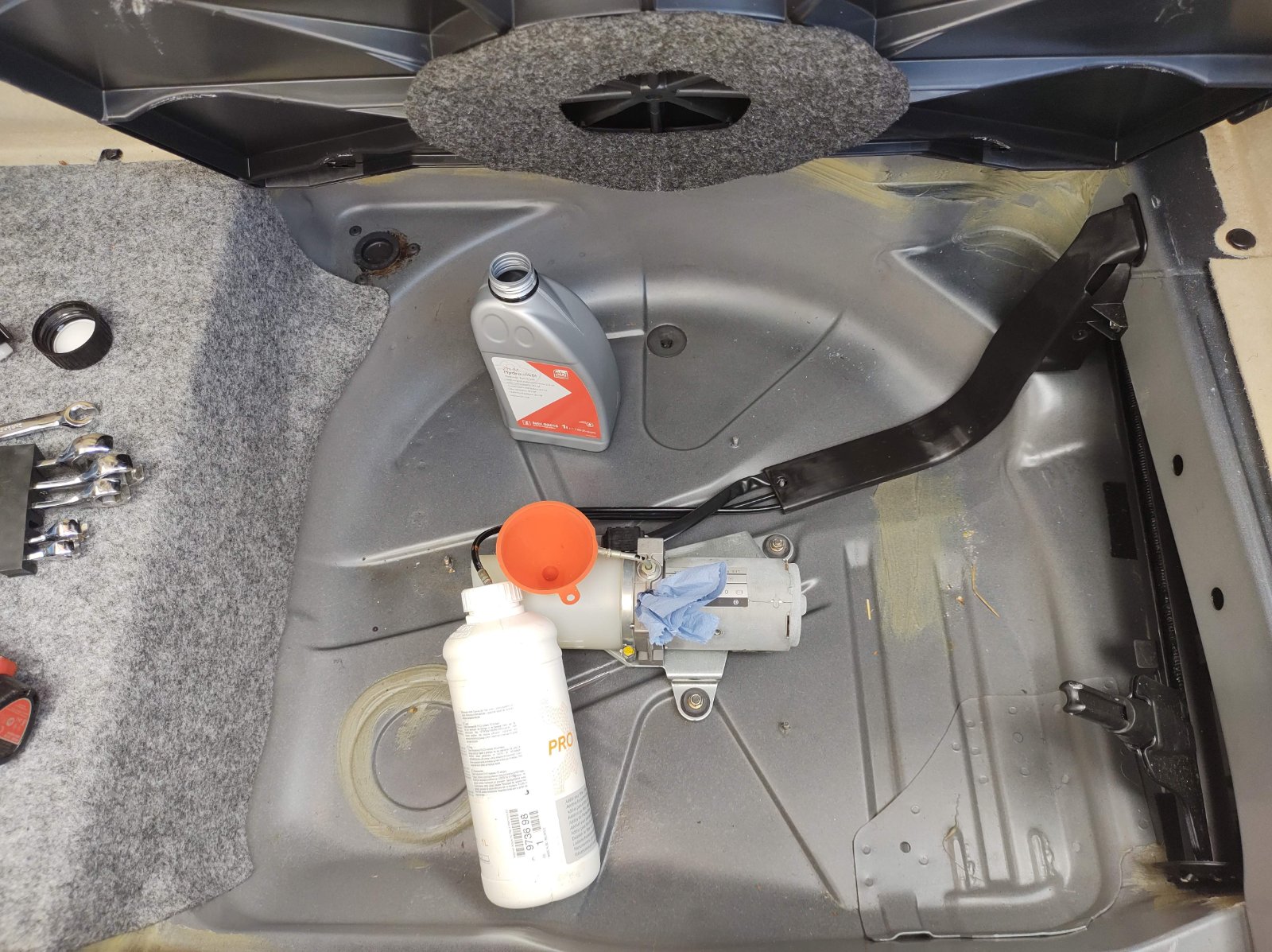

So now for the bit where it all goes wrong and messy. Replacing the hydraulic fluid that runs the roof mechanism and roll over bar.
Hydraulic pump for the roof - own work
As the hydraulic fluid that runs the roof mechanism has never been replaced (to my knowledge), I thought it best to do so as the old stuff was 27 years old :roll: The pump is located in the boot, under the spare tyre, under a plastic cover, and the last person to look at it was probably Dieter oder Hans when they fitted it in the factory :wink: You get a choice of two pipes to remove from the pump - one supplies the high pressure feed line, and one is the return line. I want the low pressure return line so I can feed it into a bottle and collect it before it goes to the reservoir. Eeny meeny miny moe.
Well would you look at that ! I only got the right one :-D Numerous cycles of roof up - roof down whilst keeping the reservoir topped up and I purged 2 litres of fresh hydraulic fluid through the system and barely spilled a drop. I've heard of other people removing the wrong pipe.... you can imagine the carnage :shock: #-o

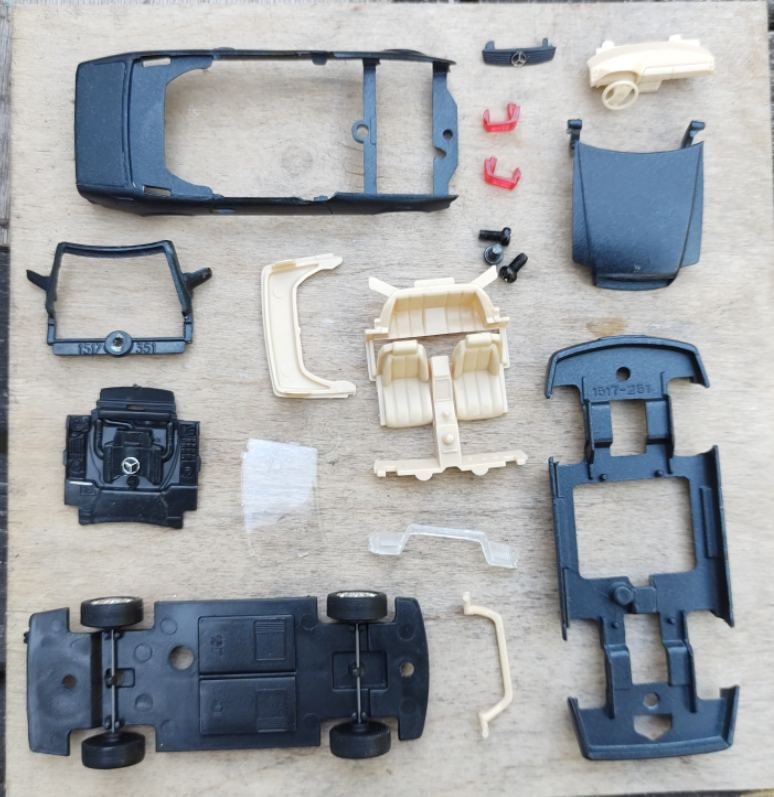

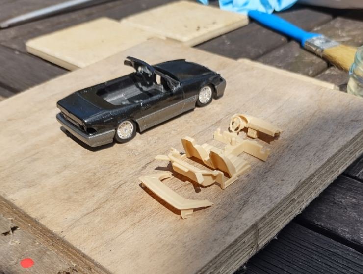

I had a bit of fun with another Mercedes SL today - I decided to completely strip the paint off of one and repaint it with a rattle can to see how it would look :-D
Here it is before I removed the paint...
R129 SL in original colours - own work

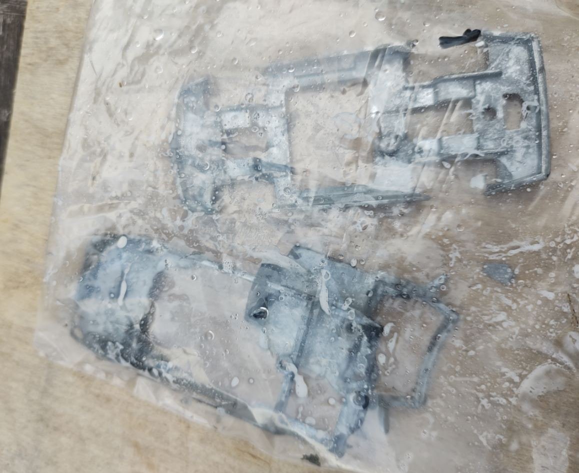

Paint removal in progress - slap it all over then place it in a bag to do its job.
Paint stripper doing its thing - own work
All the components after the body had been sprayed.
Exploded R129 - own work

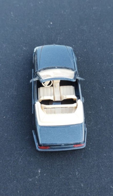

Finished article. Not bad for a first attempt although I knocked a bit of paint off on the reassembly. It's been painted the same colour as mine - Smaragdschwarz, or GreenBlack, or even GreenOpal ! It's a pity it's a left hand drive, but it's the nearest I could get without spending more than a tenner :lol:
Finished side - own work
Finished front - own work
Finished top - own work
