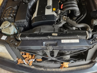

That collection of leaves and rubbish comes courtesy of some mice. It leads to.......

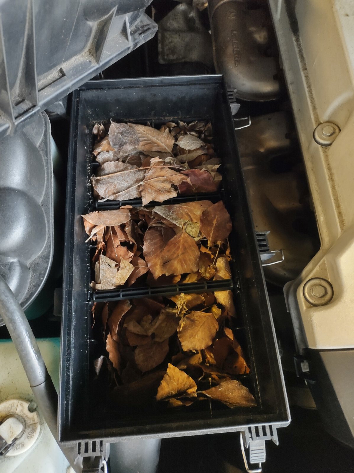

Air filter nest - own work
I think I'd call that full. That's the air filter housing :?

I started by cleaning the engine bay to remove as much evidence of mouse as possible. I sneaked a bit of time during the week with some TFR and a paintbrush followed by a gentle spraying off with a pressurised garden sprayer - all this meant it was in an acceptable condition for me to have a closer look at the wiring and other bits today. Out of all the wires that could have been chewed, they appear to only have got at the power wires for the small fan that cools the ECU compartment in the back corner of the engine bay. It was still a pig to get at though.

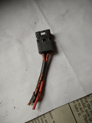

Instead, I cut off the chewed wires, de-pinned the plug, made good with new wires, and re-joined the wires back with soldered joints. It was a struggle as I've got large hands and there's bu88er all space to do anything - especially when you need 3 hands to join two bits of wire and hold the soldering iron.
Mouse damaged wires - own work
One thing I noticed - these two wires were the only ones I could find that weren't wrapped in waxed (or doped ?) loom tape. All the properly wrapped wires hadn't been touched by mice, whereas this one section of plastic sheathed wire had.

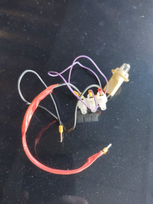

I built myself a blink code reader out of random bits of electrical stuff lying in the back of a drawer :lol:
Blink code reader - own work
It worked ! Or at least it showed no faults were present, so either I was doing something wrong.... or no faults were present. I also tried the 38 - 16 pin converter and plugged it into my Topdon 800BT OBD reader and surprisingly it found the correct protocol in the end and reported a very basic diagnostics with no faults. I'll take that as a result. No critical mouse damage and no faults found. Hurrah ! :-D

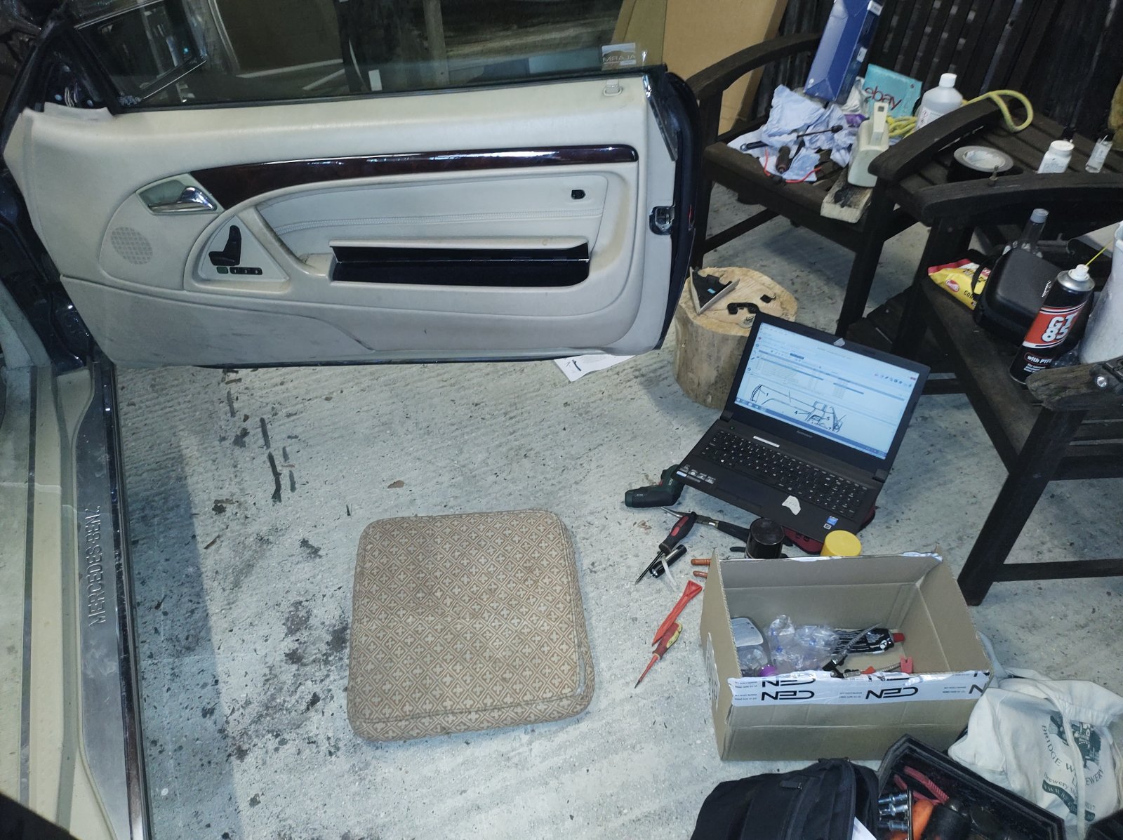

First up - both front windows were protesting when going up and down. A general slowness along with a few interesting noises were diagnosed as dry window runners, so door cards needed to be removed. A remarkably easy job to do - all things considered. A few screws and bolts tucked away which were swiftly undone, and a heave-ho on the door card in an upwards direction and it came off.
First - read the removal instructions on your dodgy copy of the MB workshop manual - own work
Second - reveal the inner workings of the door - own work
Silicon grease was liberally applied to the runners and winder mechanism, and in the process of grovelling in the door innards I came across an orphaned bolt. Easy enough to find out where it came from though. Shocking build quality though - after 27 years a bolt has come loose #-o :-D

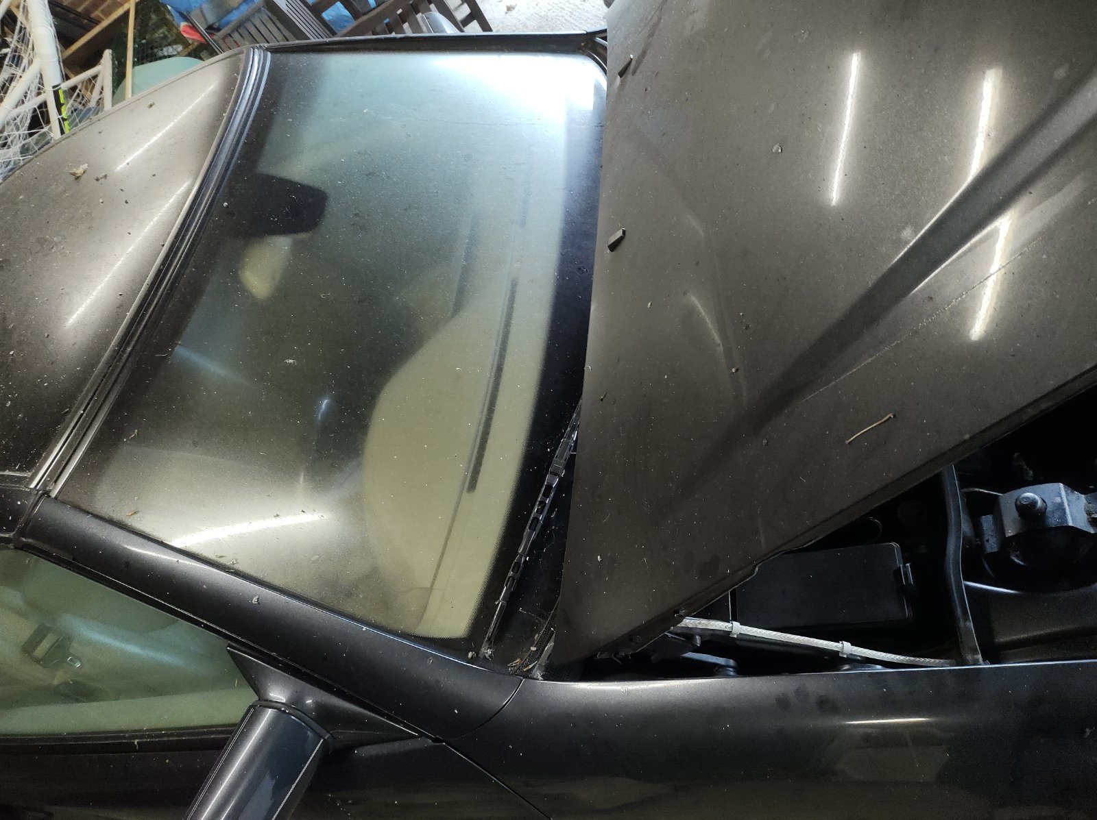

Next was onto the radio aerial. It'd steadfastly refused to retract all the way back so off it came for some benchtop encouragement.
A nAerial - own work
I stripped it as much as I could, and gently heated the mast whilst <ahem> tapping it home with a blunt object. Success - although it still protests a bit when fully retracting. More grease and lube was applied to the internals of the mast and gearbox and it was reassembled and put back from whence it came.
