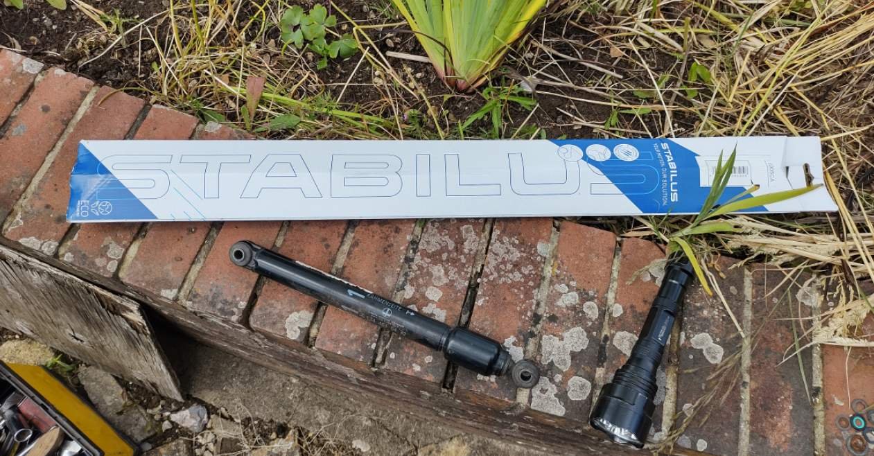

Now for a more grubby job that surely must throw up some issues. I wanted to fit a new replacement steering damper to see if it improved the steering along with the new PS fluid. I put the car up on some shallow ramps to see what I could curse at find. Oh !..... I can get to each nut and bolt of the steering damper from each side of the car without fully having to get under the car and without removing any under body gubbins..... and each nut and bolt undid easily and nothing was seized.... and the old damper easily came out.... and the new one easily went in. Clearly I'm operating in an alternate universe. Car things never go this easily [-X
