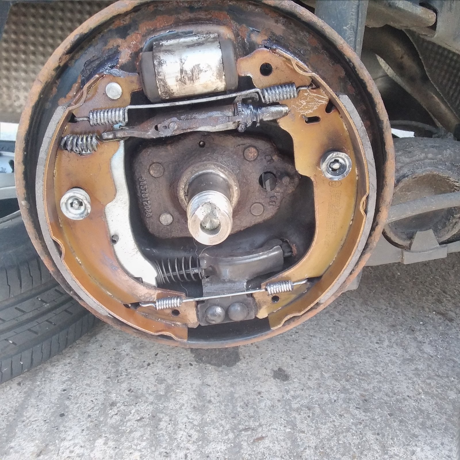

Adjusted the rear brake shoes , slackened off the handbrake cable first when i removed the drum what a pleasant surprise both sides revealed ,so the adjusting was done as by the correct way , now i can feel all the brakes doing that nice squeeze they do
Pleased by this?  Yes i was !

As above, everything was lightly grease that had movement springs were lightly coated and them horrid spring clips too
