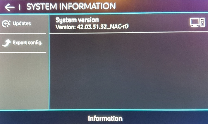

Re: PSA NAC RCC Updates
1. Press the cog icon at top right of screen
2. Options
3. System settings
4. System info
5. OK
You're looking for a screen like this:

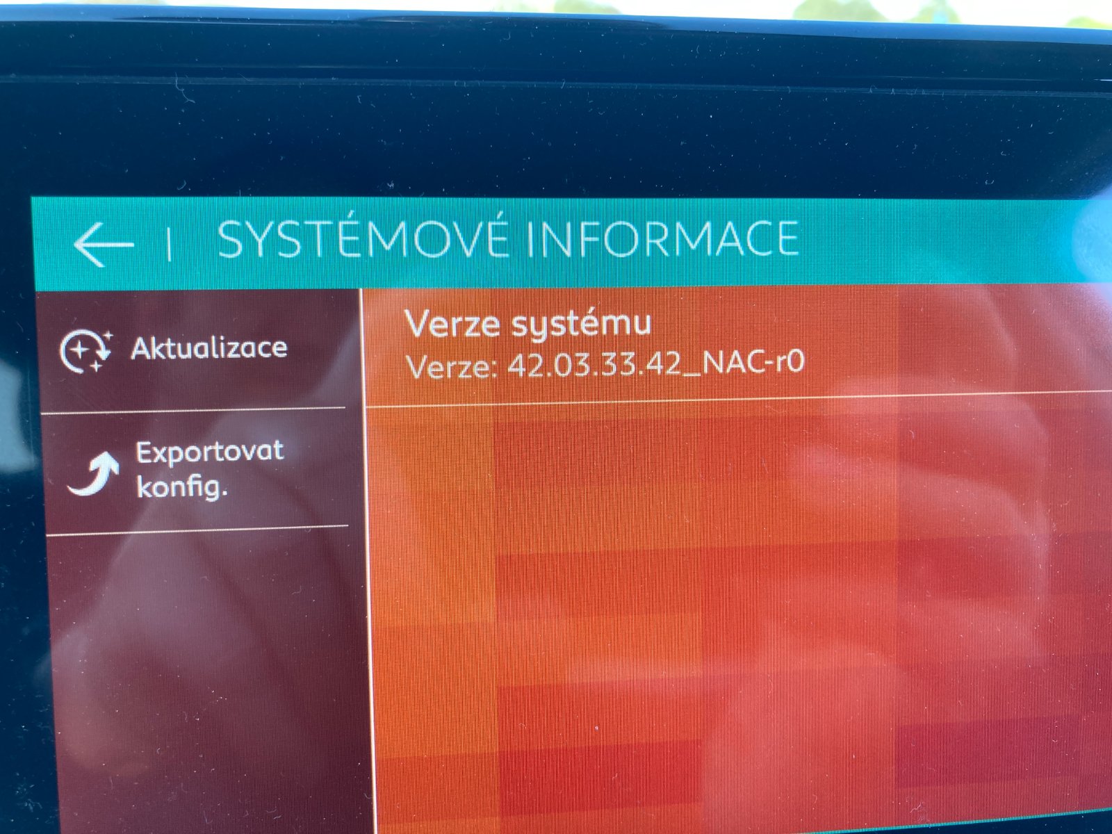

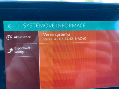

Managed to get info ,
version is 42.03.33.42_NAC-r0
dated : 2021-05-31
Gremlin

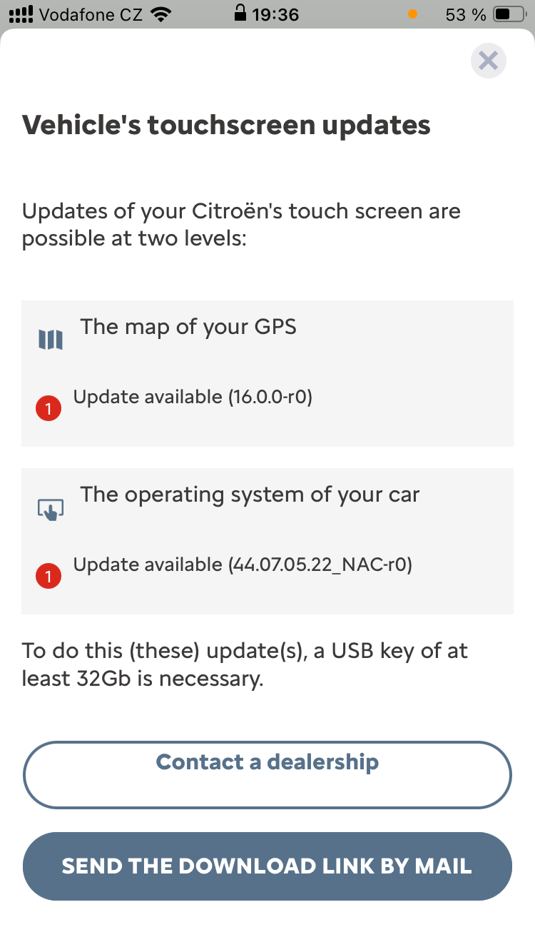

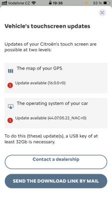

corinnesv
Posts: 2
Joined: 12 May 2024, 11:03
Unread post by corinnesv »
Hello GiveMeABreak,
I have C4 Cactus 2018, VIN: VF7**************[VIN obfuscated, can be read by forum staff].
according to my mobile application My Citroen updates are possible.
Map update available (16.0.0-r0)
Operating system update available (44.07.05.22_NAC-r0)
But I can upgrade using Citroen_Update_Setup_0.1.24.exe only to 42.03.33.42_NAC-r0.
can you help please
