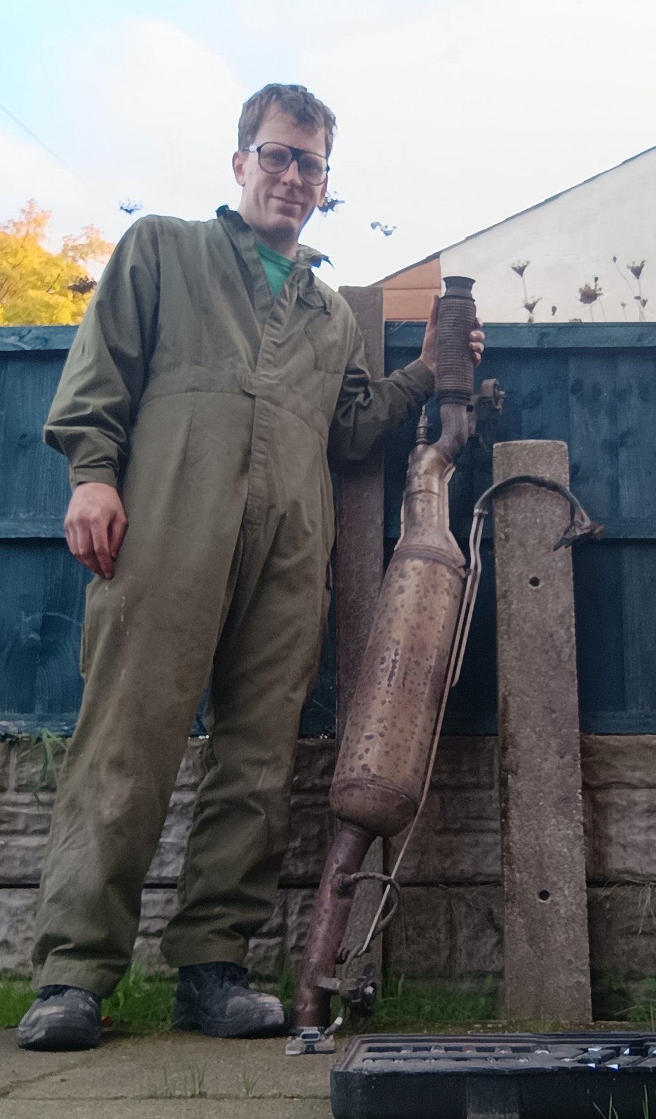

Thanks Husky - unfortunately that's not the right type - with mention of Euro 5 I suspect that's first generation 308. On my 2016 model it looks like this:
Berk for scale
Berk for scale
DPF one long piece, not "half and half" like that one.
Lots of rusty fittings tackled today, DPF off the car. Clean out tomorrow hopefully

Huskyxantia wrote: 17 Oct 2026, 18:06 Looks like a torpedo
It's a big heavy lump! I thought DPF and catalyst were both in this unit, but there's another "lump" in the exhaust further up towards the engine - perhaps that's the catalyst?
Adblue injector clip is retained with a 4mm alien head bolt, not rusty (stainless I think) but not budging at all, so to tackle off the car.
Oil drained. Oil filter stupid tight, not defeated that yet. Need to find my strap oil filter wrench (it's rare I need to use it, I can normally get the filters off by hand - not this one!
