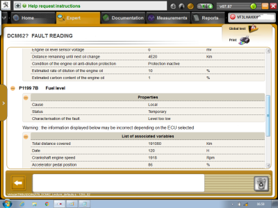

Engine faults
1
1
2
2
3
3

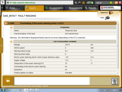

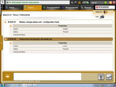

BSI faults
BSI faults
BSI faults
Power steering overheating, ages ago!?!
PAS
PAS

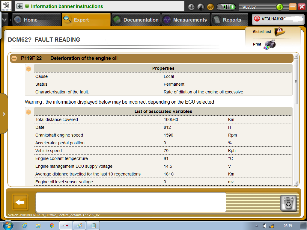

Rate of engine oil dilution excessive,
Estimated dilution rate: 10%
I'm fairly sure it's about 6 litres of oil in the sump, so 600 ml of diesel from failed regents!? Seems a lot. Not aware of any other mechanisms for oil dilution.
Oil change at the weekend as first step.
Think "last 10 regents average" was something like 180 km, not ridiculously short.
All thoughts welcome! :)

MattBLancs wrote: 12 Oct 2026, 19:52 Rate of engine oil dilution excessive,
Just a few potential reasons Matt. Bad injectors, worn rings, worn bores, worn pistons.
I'm intrigued to know how the system determines this... Oil level perhaps?

CitroJim wrote: 13 Oct 2026, 08:26
Not raving about that list of possibilities! :rofl2:
Quick googling at lunchtime:
Yep, high oil level + number of incomplete regen attempts is apparently the trigger.
Oil change, reset codes and see how it behaves is my plan.
