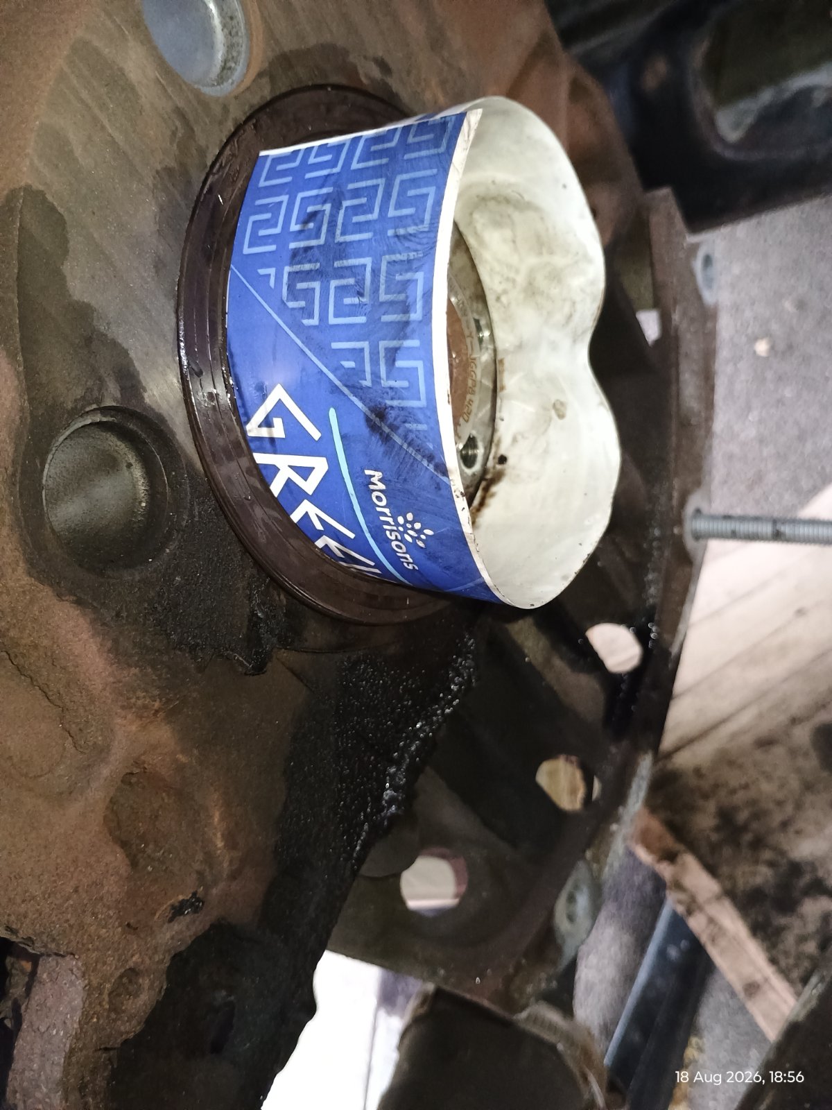

Angle grinder plus old flywheel bolts = chase out the thread locking compound.
Crankshaft oil seal installation tool from the Morrisons Greek Style Yogurt range
90x110x7 "from stock" due to hoarding tendencies...
Knackered, more tomorrow :)

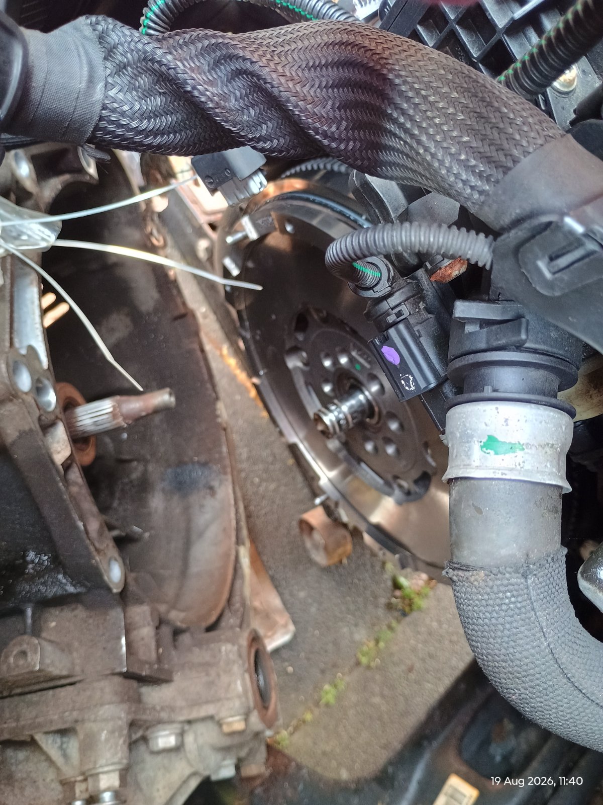

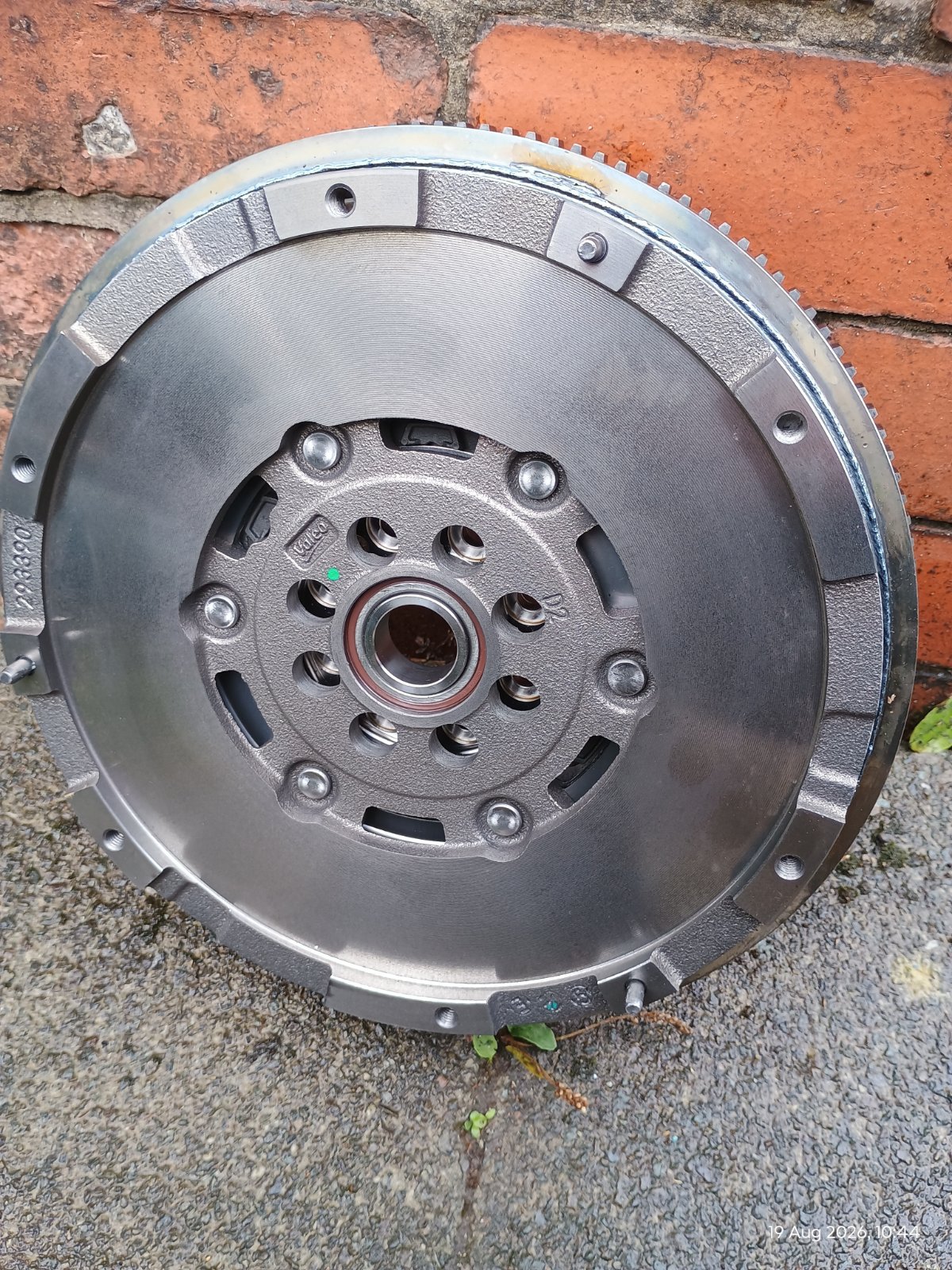

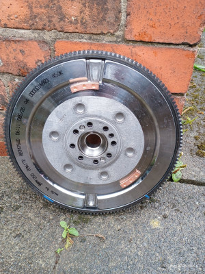

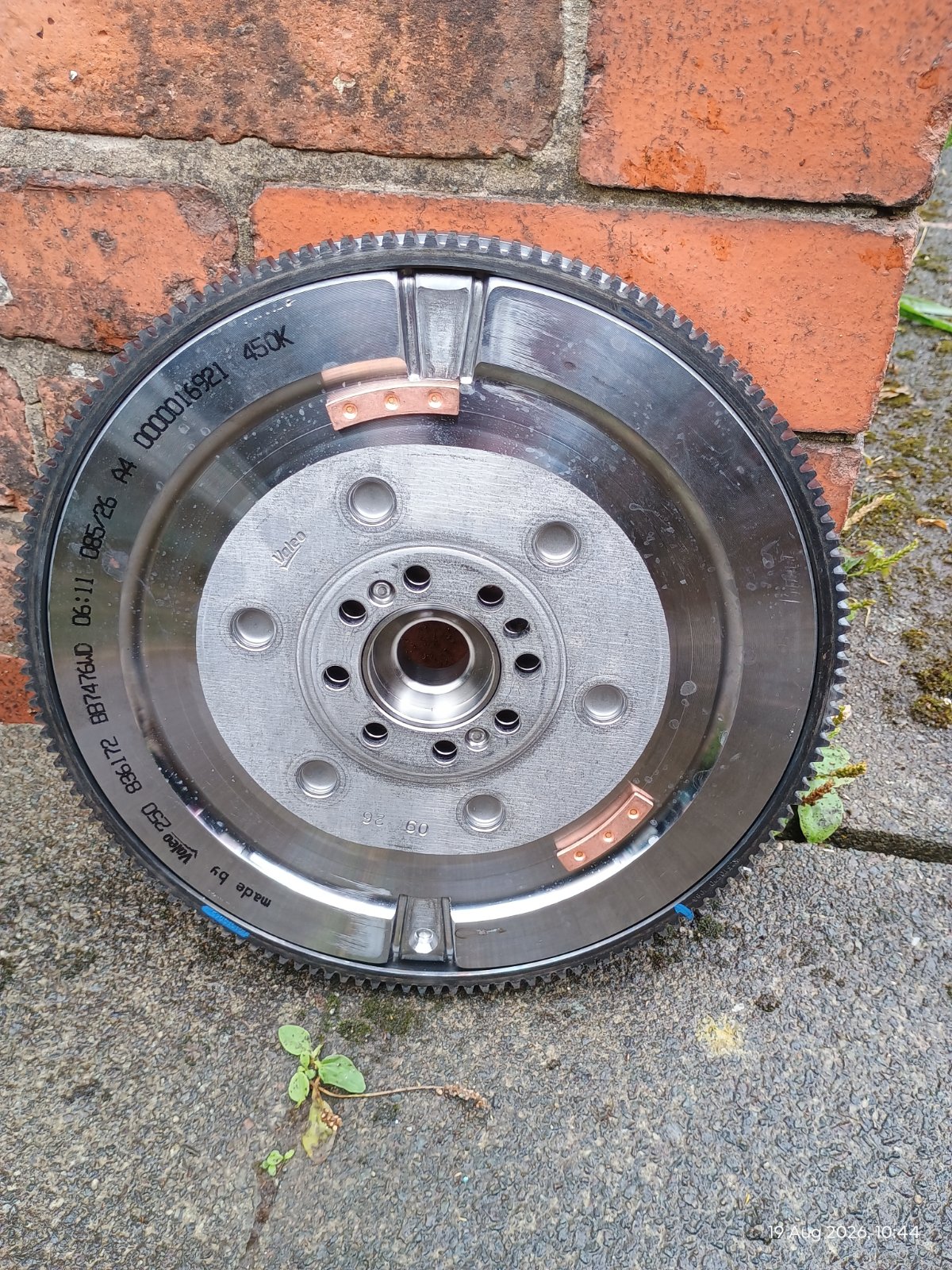

New flywheel on.
A deep socket a good fit in the flywheel spigot hole is a MASSIVE help as trying to precisely align the flywheel (8 bolt holes but also a dowel pin too. Which is a stopped hole in the flywheel and hence not visible from the front!) quickly becomes an arm aching patience test. Thusly:
ENDING NOTE.
Brilliant set of photos and info here Matt this may well could be of use to someone one day with the same job . Top work.
Thank you! :)

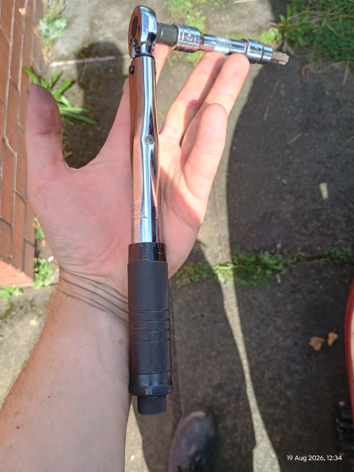

Nipped inside to grab the (previous generation) torque settings for flywheel bolts. T50 torx, from the Haynes:
Stage 1 is 25 Nm
Stage 2 is fully loosen
Stage 3 is 8 Nm (can't see the overcoming the loctite personally! Will need to break out the 1/4" inch drive torque wrench as my 3/8" drive just not go below 20 Nm!)
Stage 4 is 30 Nm
Stage 5 angle tighten 90 degrees
Stage 6 is drop torque wrench and try to reconnect arms back into sockets :-D

ozfrog wrote: 19 Aug 2026, 12:16 I like Stage 6 the best.
I'm looking forward to that bit!
8Nm is 71 inch-pounds (as that's what my little cheap 1/4" drive torque wrench uses)
