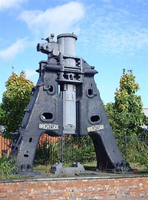

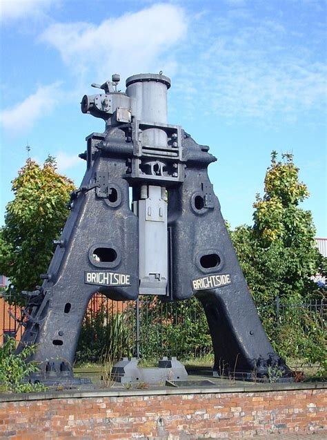

That may well be the case bobins but how do you get one of these under the car?bobins wrote: 12 Feb 2023, 12:35I think you'll find the more refined mechanic uses percussive maintenanceDormouse wrote: 12 Feb 2023, 10:08 In much the same way as I was taught "to tighten a bolt until it broke then back a half turn", I was also taught PFV.

You place the car under it!

Now then. Just because my knuckles drag on the ground.bobins wrote: 12 Feb 2023, 12:35I think you'll find the more refined mechanic uses percussive maintenanceDormouse wrote: 12 Feb 2023, 10:08 In much the same way as I was taught "to tighten a bolt until it broke then back a half turn", I was also taught PFV.

I think by that stage you are more into the realms of "teaching the car a lesson for daring to defeat you" rather than whatever the original task was!mickthemaverick wrote: 12 Feb 2023, 12:49 That may well be the case bobins but how do you get one of these under the car?![]()
- Spoiler: show
You know, this stage:

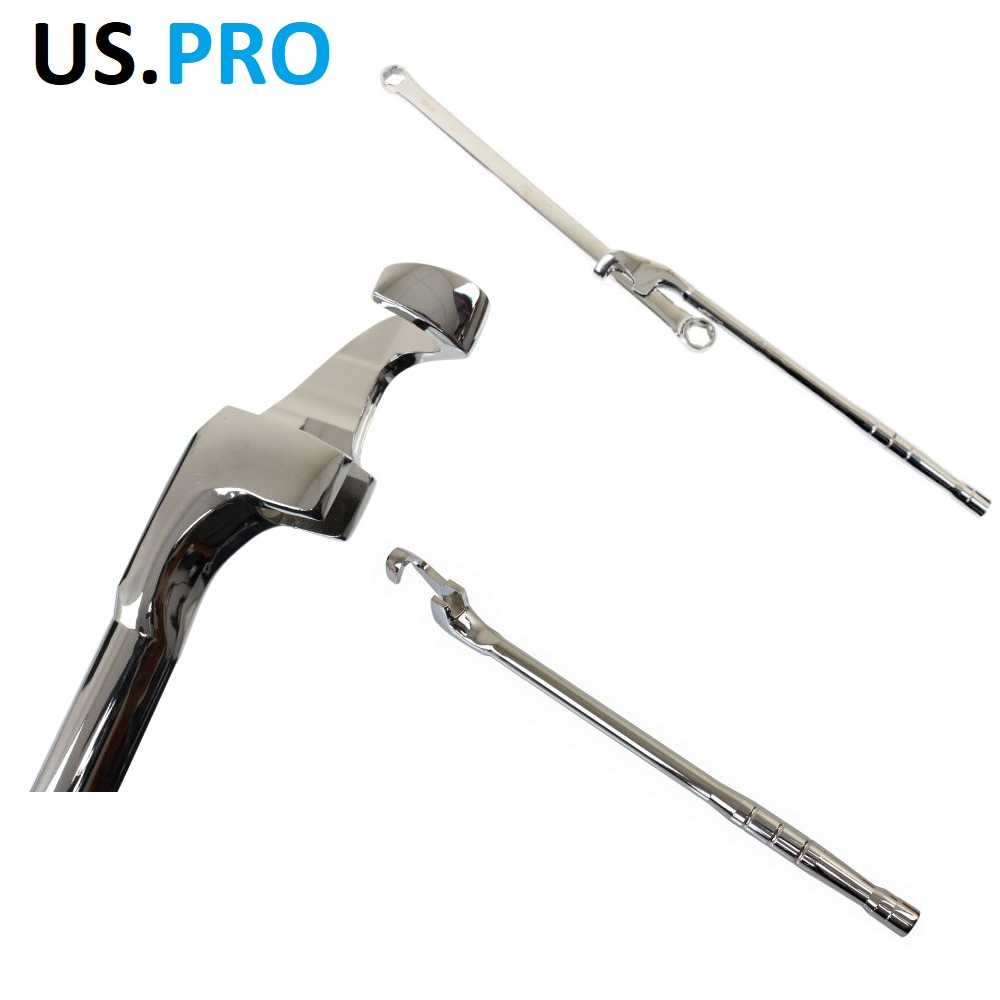

As I grow older, I'm slowly realising that "Lifetime warranty" does not necessarily mean "(oil) rig-mechanic-proof", so I'm trying to get out of some of my guerilla tactics, but I bought one of these:
...which is kind of meta, it's a pucca tool to enable you to guerilla the foxtrot out of a spanner, aye, ok.

That's a well useful tool Jay!
Better than my long ring spanner method!

- seems expensive for what it is (especially, like Jim, I do the ring spanner linking thing for free)
- I think I'll just break things if let loose with that!

I know what you mean, it does seem daft to buy somethicng shiny but spendy just to do something you can already do for free with basic tools. But, like I said, I'm trying to get out of my bad habits, and hooking the ring end of one spanner over the open end of the one that's actually on the bolt, presumably by its ring end, or it's a double open ender, simply isn't kosher. I'm also trying to drill myself out of using the side of a ratchet as a hammer, or a screw driver as a prybay/chisel.
But, yeah, I've got a highly questionable, but highly effective "tricks" that I've used over the years, such as pitting a shackle through the end of a stilson, attaching a leverpull "come along" chain hoist to it, and pulling the stilly with about 3 Tonnes of force. Another cool but "would get me fired" trick was rigging up a 30t Enerpac hydraulic cylinder (industrial jack) to push a flogging spanner,. I took the locking wheel nuts off a discovery we had a few years back by putting a bolt in a set of point nose mole grips, clipping the earth clamp to the mole grips, and srick welding the bolt to the locking nut.

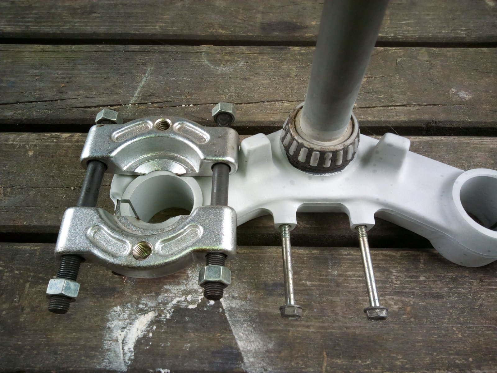

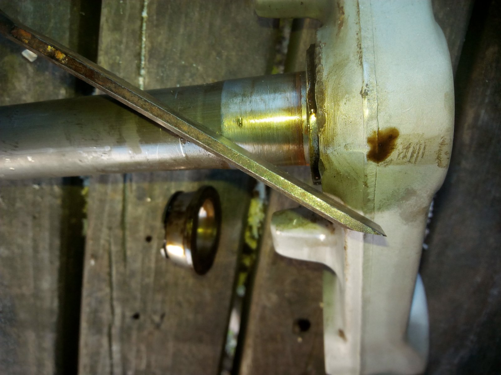

Inner race bearing extractor. The real one doesn't work due to the lock stops.
This does (and was the advised method on the Z1OC) A very overly sharpened old wood chisel and a tapometer.

I have a couple of different size pairs of old-school car-size tyre levers that do sterling service in that role Pete
