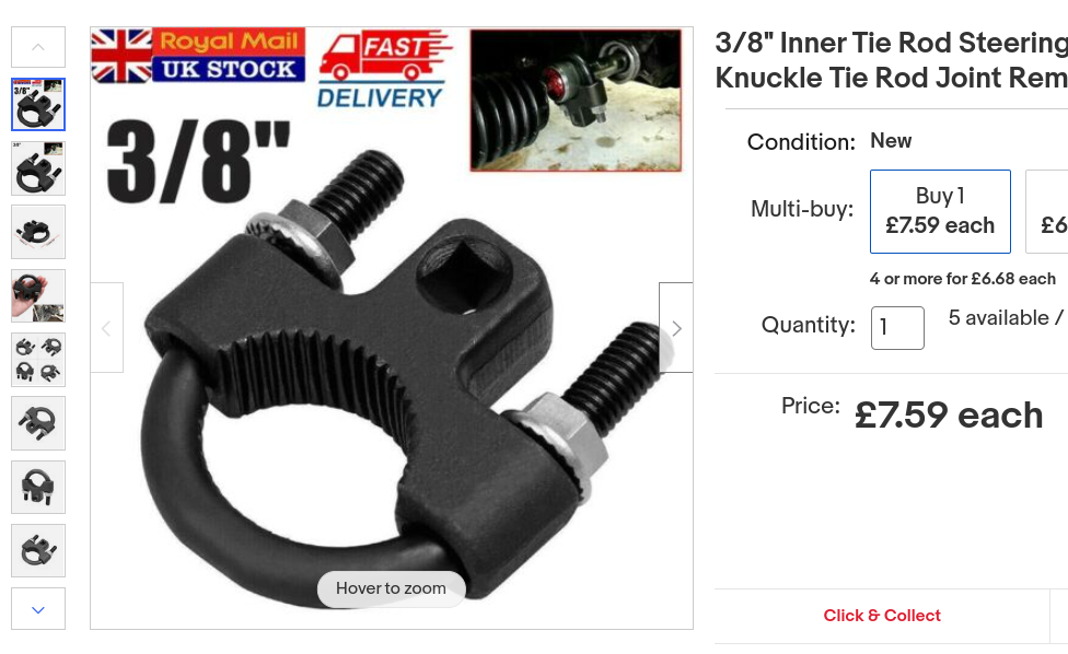

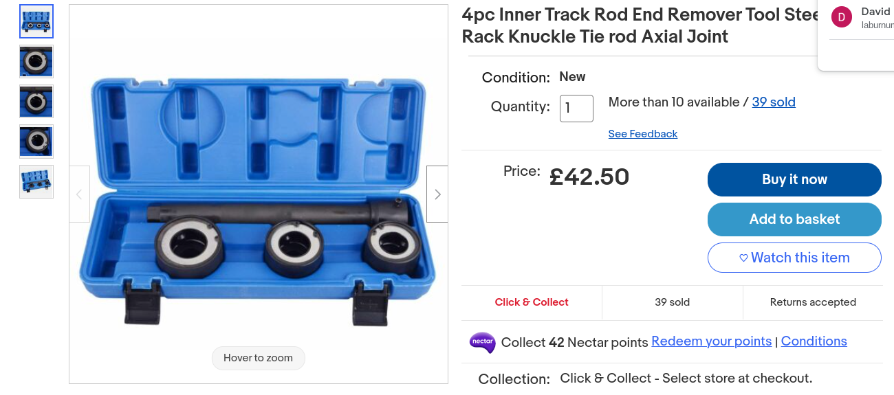

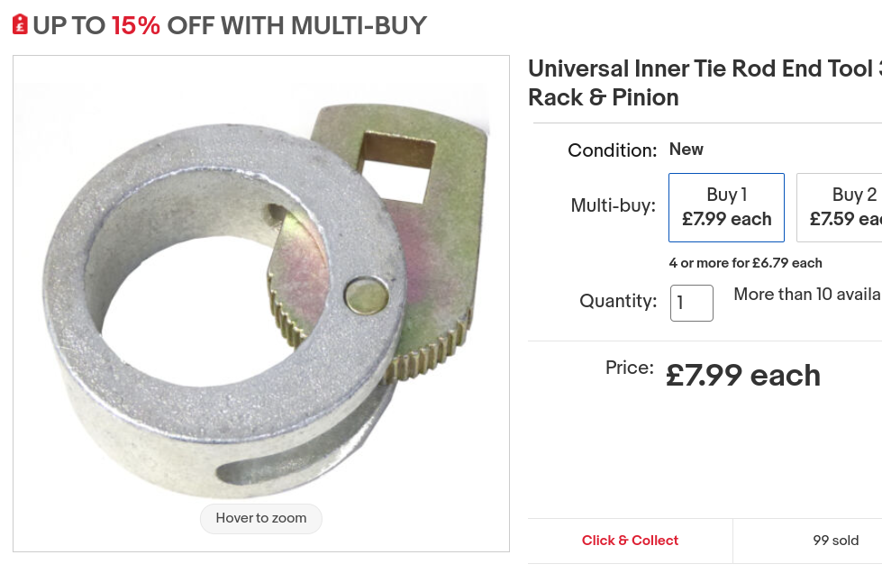

You might want to consider these tools which clamp over the inner joint nut and are driven by a long extension and a ratchet/power bar.

OOOHHH!!!! Shiny!!!Dormouse wrote: 10 Feb 2023, 09:29 You might want to consider these tools which clamp over the inner joint nut and are driven by a long extension and a ratchet/power bar.
Didn't know of those tools, probably going to push the button on those now...

The black 3/8" one is a bit hard on extension bars and ratchets. Better to use 1/2" with a good quality (Snap On ? ) 3/8th adapter on the end.

I don't recall them so freely available or so reasonably priced a few years back... Good find Dave!Jay-Bruce wrote: 10 Feb 2023, 11:55 Didn't know of those tools, probably going to push the button on those now...
One thing I'd advise is the ballcups on Xantia steering rack are somewhat larger than many and it would be wise to check these tools are big enough to do the job.
The last time I did this around 6 or 7 years ago at least, similar tools were available, much more expensively, but none opened big enough for a Xantia... Hence the Stilsons!
Be worth checking the sizes on your fleet too Jay, before hitting that button

Can't help but look at the black one and think, "hmm, repurposed exhaust clamp and bit of ingenuity..." (But then again, for the sake of ~£8?)
Are these compact enough to extract the inner track rod ball joint in situ (versus the Stiltons needing rack removal to get a clear swing on it) ?

The exhaust clamp thought isn't far away but you need a stouter base than folded steel. Trust me. My idea was to make the square drive bit from welded up plate steel with both wings slotted/ open ended to fit the U clamp of your choice. The U clamp needs to be fairly snug but only clamps and the plate steel bit needs a strong 1/2" socket plus serrations to give grip and drive.
You can have that design idea on me.

Ah, sounds like I'm underestimating the torque required, from your description plus the need for a quality Snap On reducer (else likely to have a snap off reducer! **) It's much more in the wrestling off with a big mean Stiltons territory than I thought.
