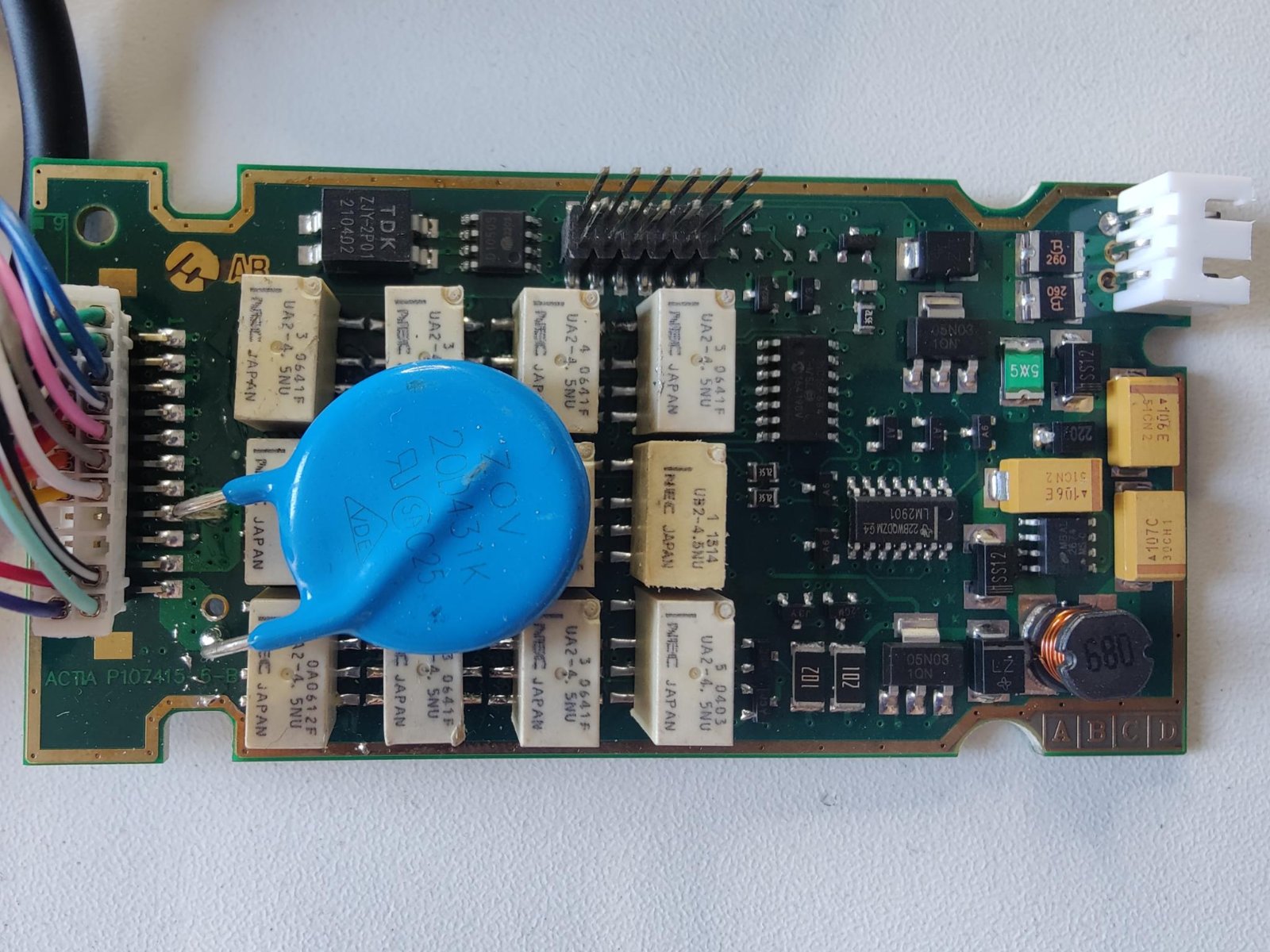

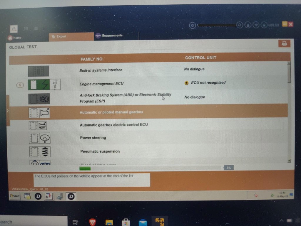

Entered my VIN and running a fault check, but I am getting the message "ECU not recognised". Ignition was turned on. I can even see on the car screen that it's running a diagnose-routine and I can hear the relays clicking inside the interface. I am attaching the photo of my interface and the message from Diagbox.

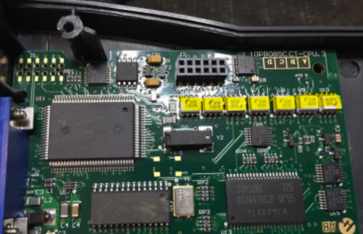

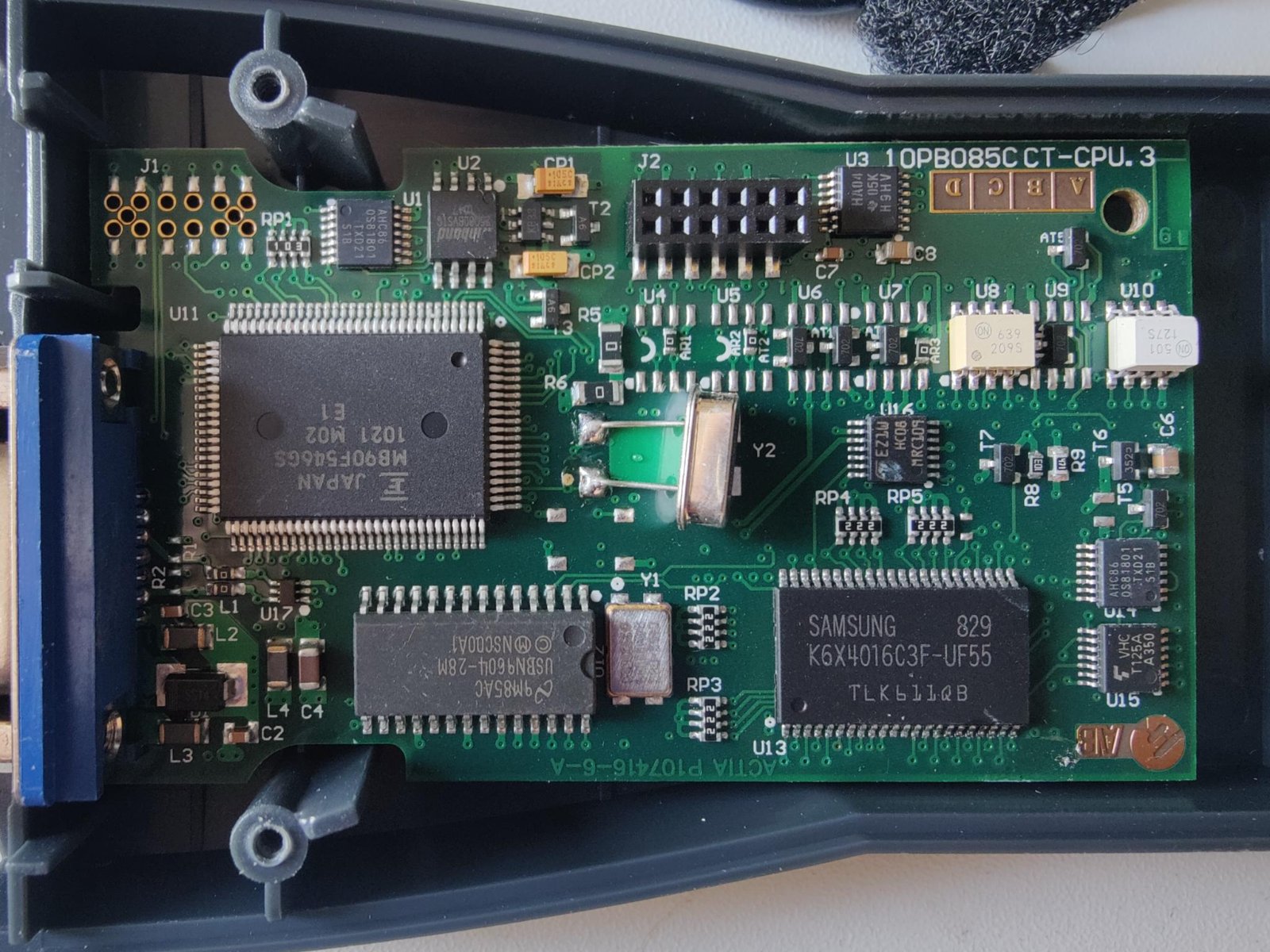

You've been sold a dud - most of the optocouplers are missing, so it's not a full chip and probably doesn't have other components on the other sides that I can's see.
See my picture here in this post of the missing parts:
viewtopic.php?p=625919#p625919
These are the missing optocouplers: The back of the board also needs to have the 10k resistor as shown in my picture here:
viewtopic.php?p=570919#p570919

Dear Marc, thanks for your prompt reply. Damnit! Any chance to solder them on my own (in case optocouplers are generic ones..)? I have a decent soldering station for doing SMD-soldering. The 10k resistor should be an easy fix which I can already try out!
Or would you suggest that it's better not to bother and to get a proper adapter (again 70bucks right?)? But then again, I'd need a trusted seller...

Trouble is there may be other components not fitted that I can't see, so my advice is send it back and get a decent one.
