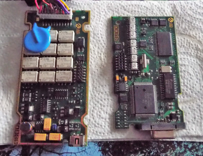

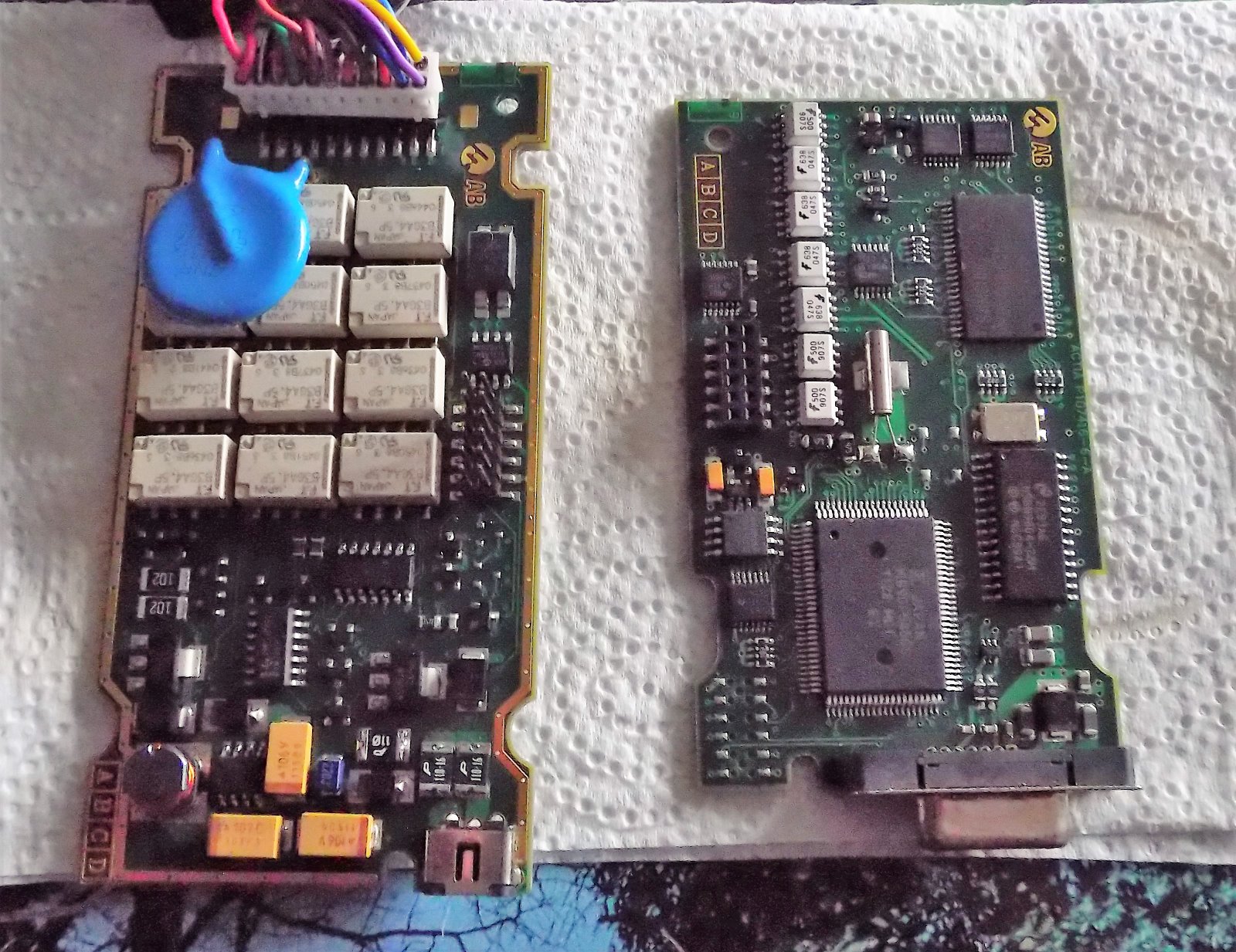

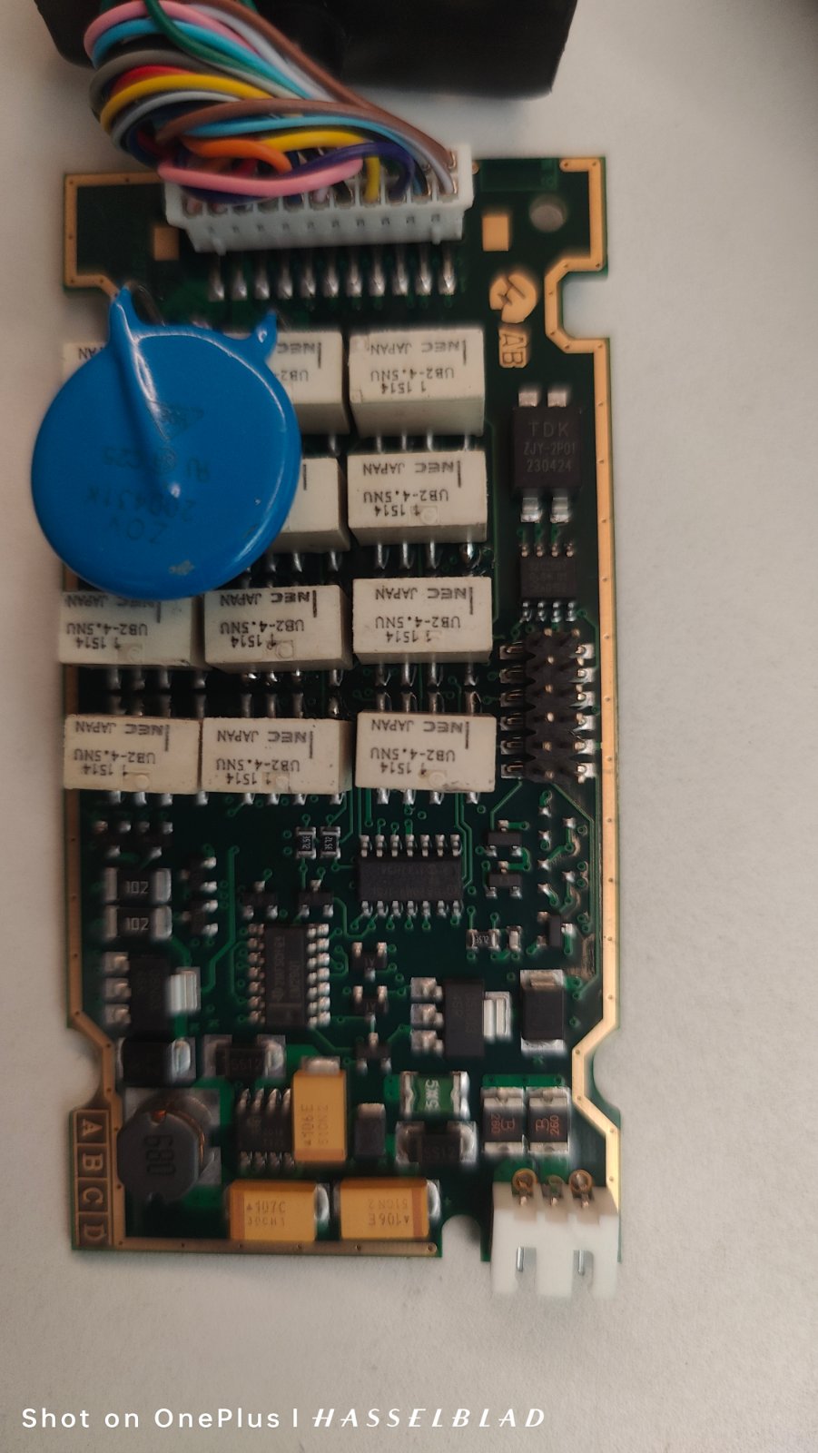

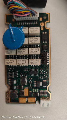

Is this 'full chip'?
x 6945
Re: VCI
That looks good to me Gibbo, all the octocouplers look to be there, if you can do a shot of the reverse sides of the PCBs, I can check for the 10k resistor.

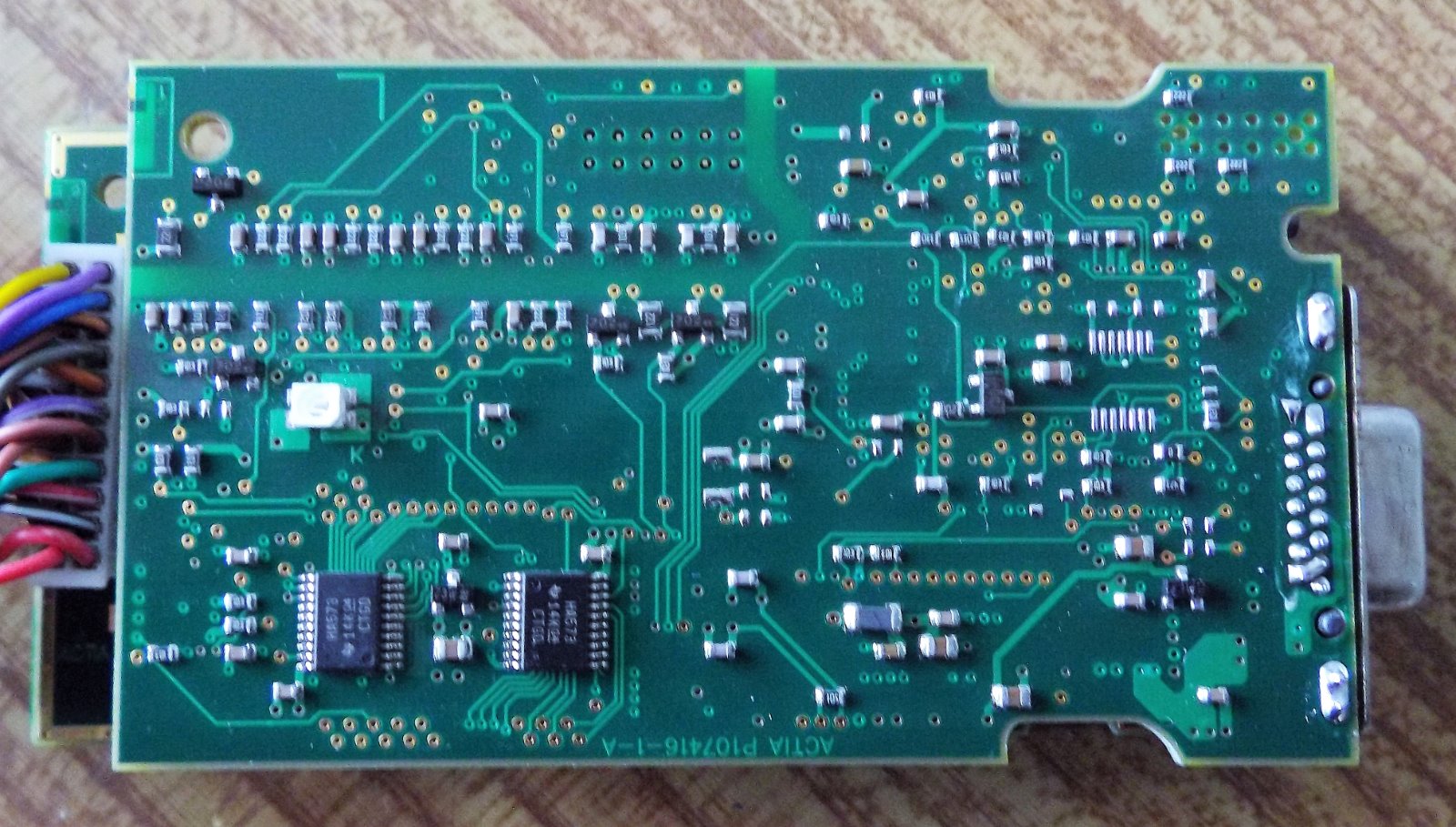

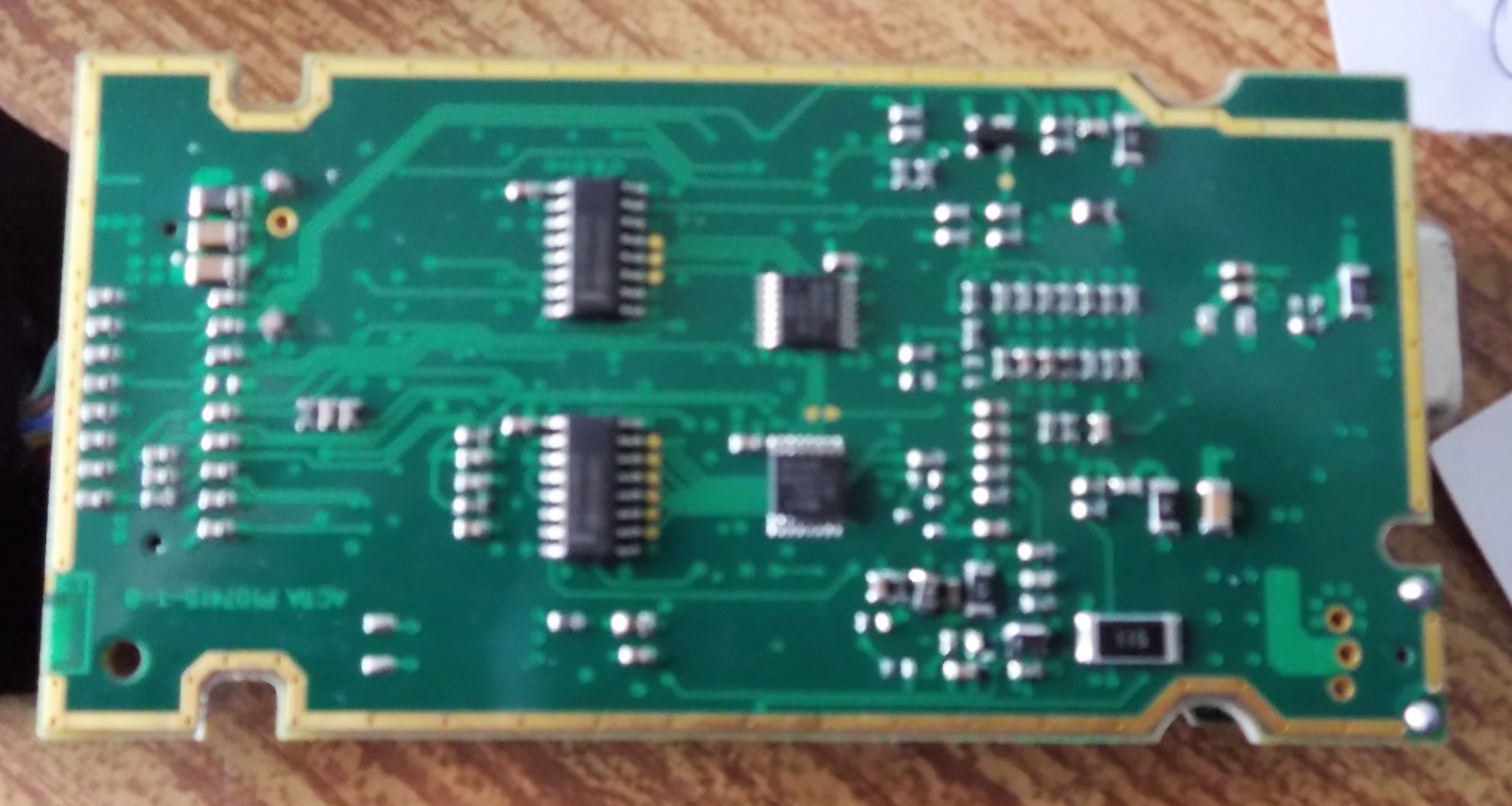

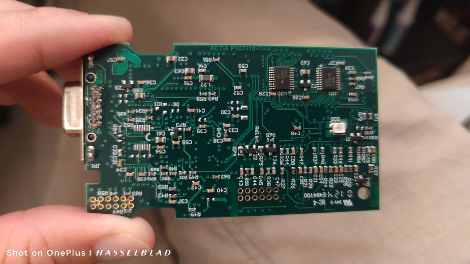

Here we are:
x 6945
Re: VCI

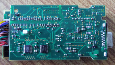

Ok, that's fine Gibbo - 10k resistor present - if this was missing it causes communication issues - especially on CAN systems.
10k Resistor Present

GiveMeABreak wrote: 26 Mar 2018, 11:22Ok, that's fine Gibbo - 10k resistor present - if this was missing it causes communication issues - especially on CAN systems.
So, are you saying that some so-called full chip VCIs don't have this resistor Marc? Is this the only example of a full-chip VCI that has another gotcha?

The lack of the 10k resistor is known to cause communication issues with CAN systems (depending on model), but there are a stack of chips, relays and Optocouplers that are not found in the full kits - something the Chinese makers did to reduce costs - which is often why they are much cheaper that the full kits. It becomes more of a problem on later vehicles and full CAN systems - so one has to consider whether it is worth the additional investment in a full chip kit.
I have to say, this is really model - dependent - as you have VAN, VAN-CAN and CAN-CAN :-D systems and of course those with no multiplexing at all, So you pays your money and makes your choice.
Then whole VCI clone thing is a minefield TBH, as once you have overcome the hardware, then there is the matter of getting the right combination of software and VCI firmware for the vehicle (s) you need to work with.
I'm pretty lucky with Diagbox switching to Lexia for the Xsara Picasso & C3 and Diagbox for the X7 and I have a good combination. If I was to use if for a 2016 vehicle, then I'd probably need to go to a much higher version to recognise the newer ECUs, that's why reverting back using the firmware changer is very useful as it can resolve some of the incompatibilities.

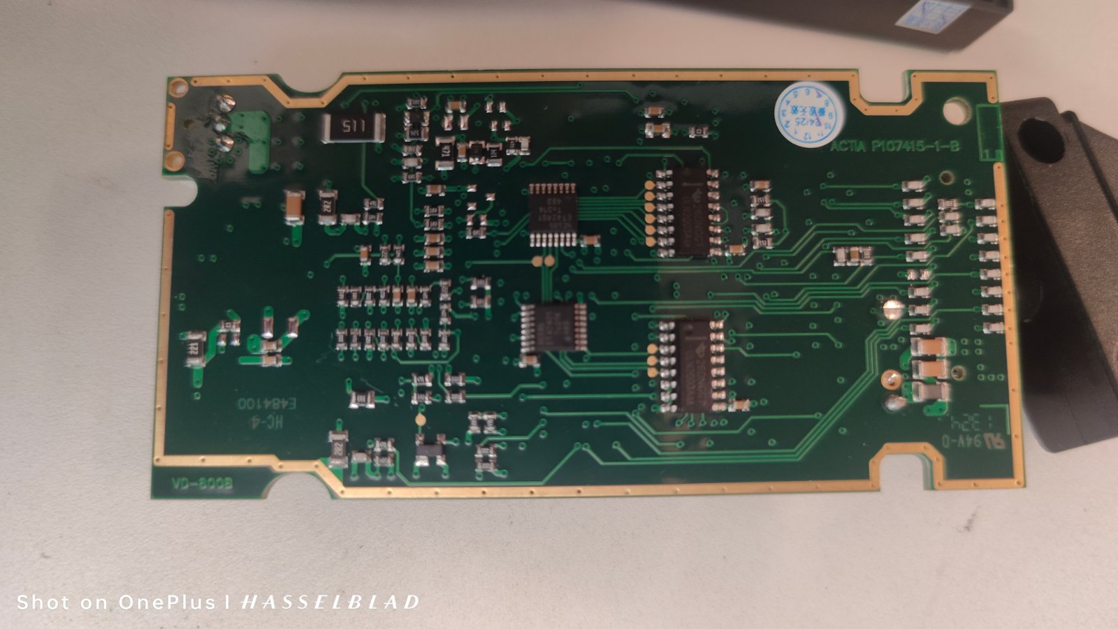

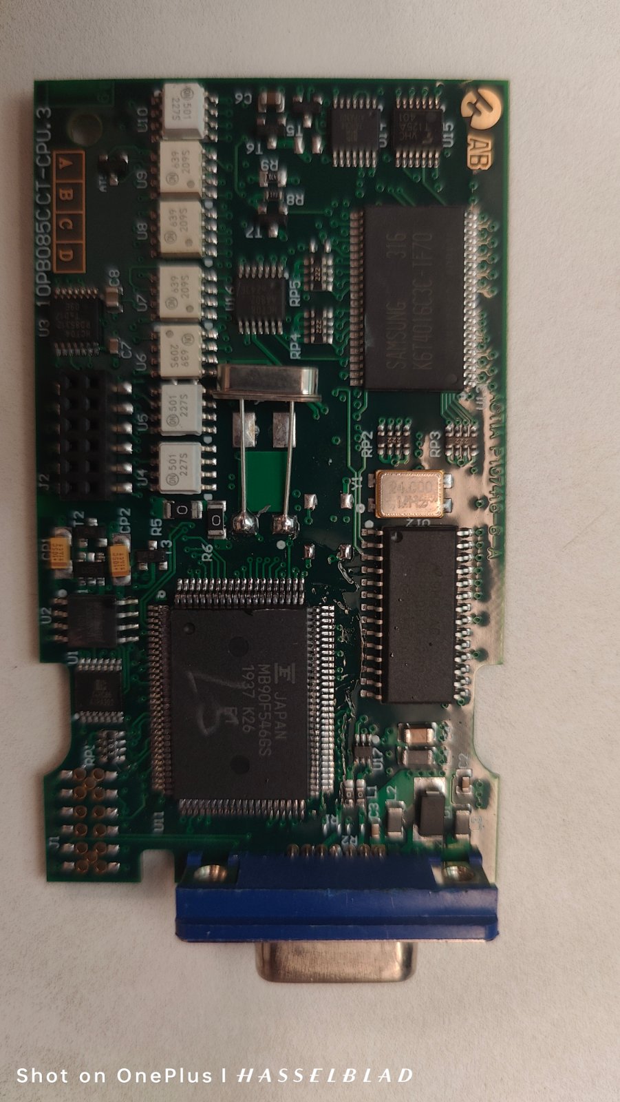

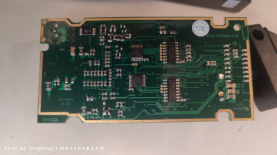

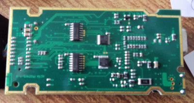

Hi, I got this VCI Connector from Aliexpress, I was told it is a full chip by the seller. Is this a full chip set? I am not too good with electronics, may I know is there a missing 10K resistor?
x 6945
Re: VCI
Missing 10k resistor on the last picture. But try it first and if it reads everything in the car, you may be OK.
