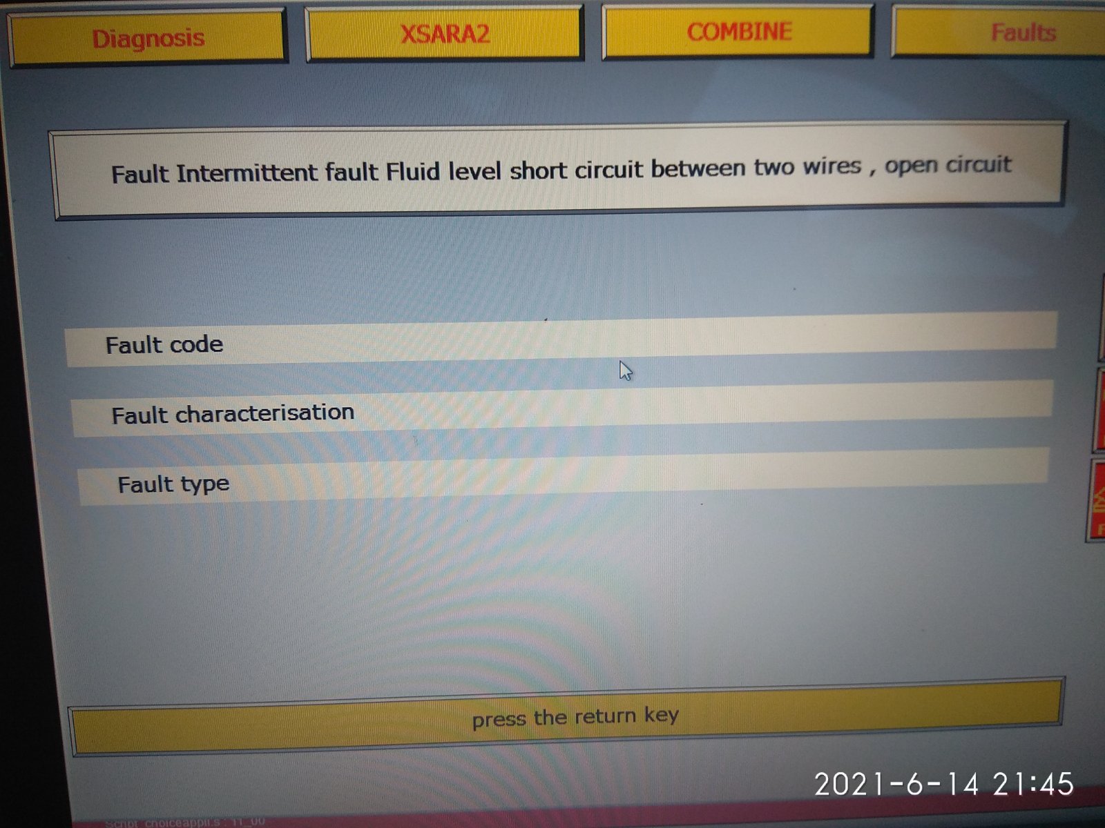

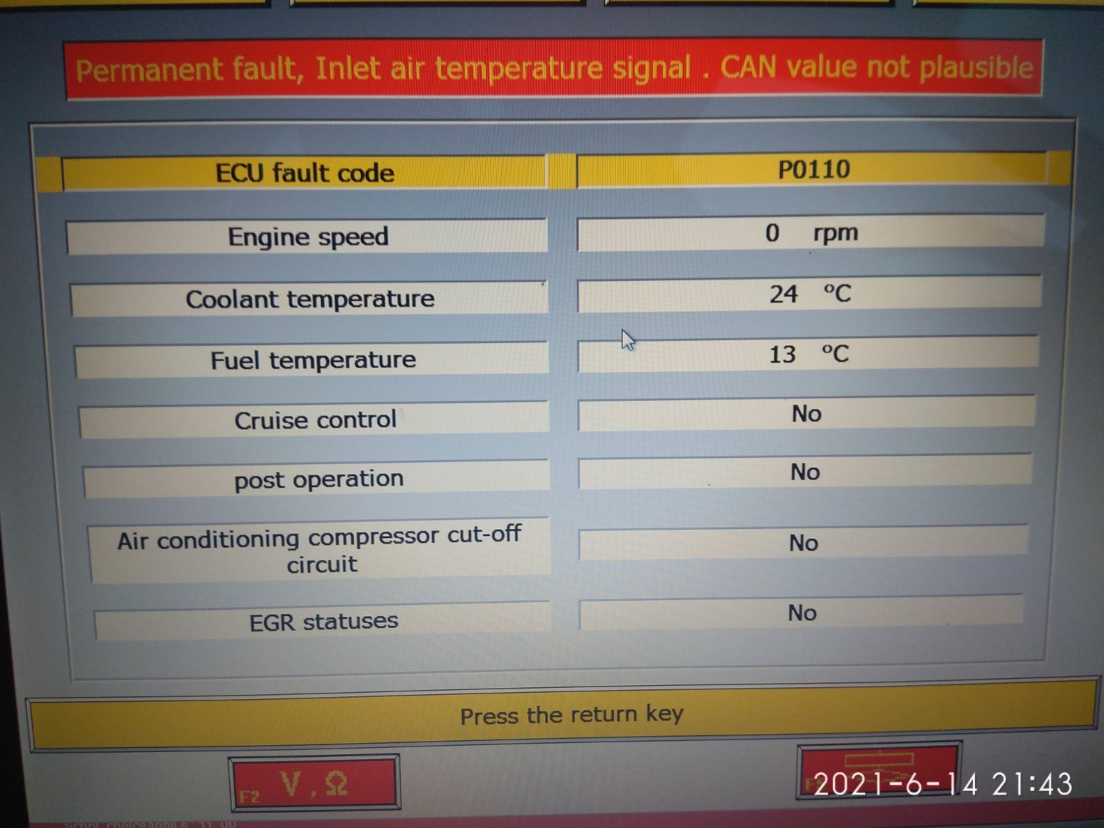

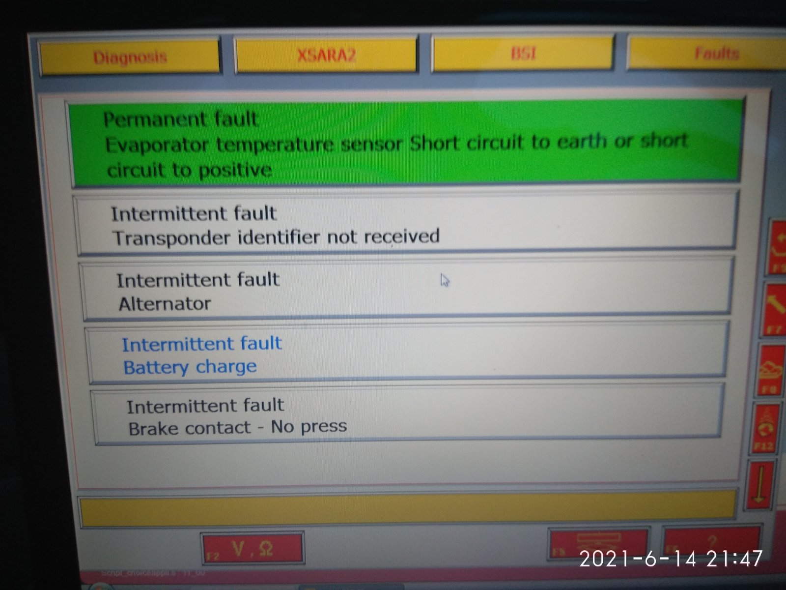

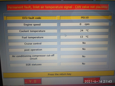

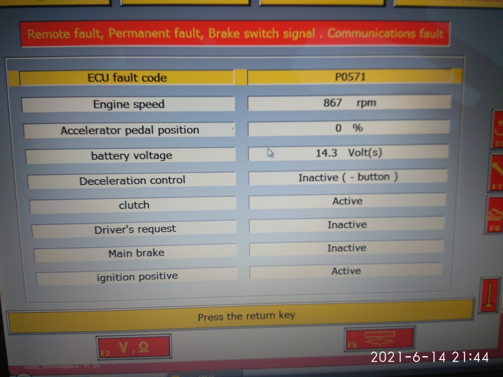

Got the call to help out in the end. What fault code would this trigger:

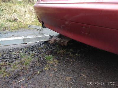

Next task now is to see how much damage the trailer has done to the rear of the car and remove the hitch setup and tidy it up.

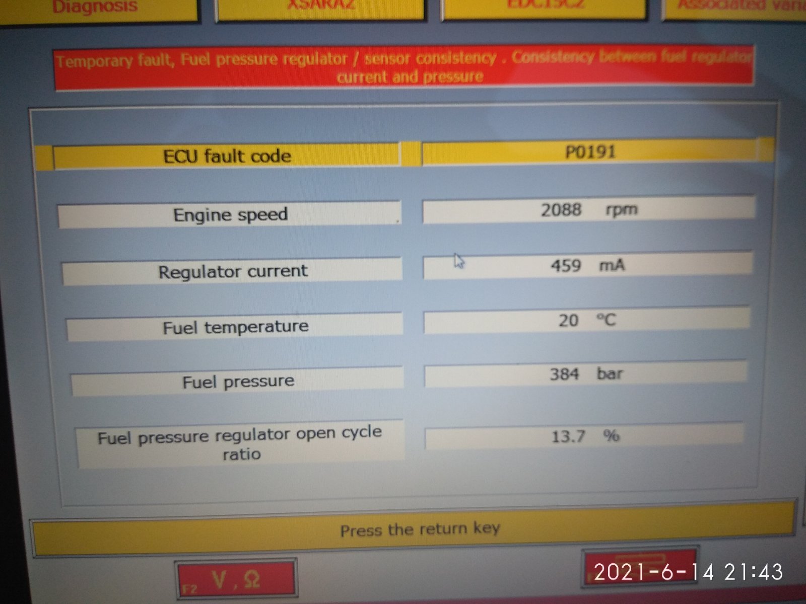

Car has been behaving it self again until the weekend when it went into limp mode again.
P0191 is the main one now.
It happened when car was accelerating out of a corner. Wondering if fuel sloshing in the tank again the pump would cause a faulty pump to intermittedly fail again.

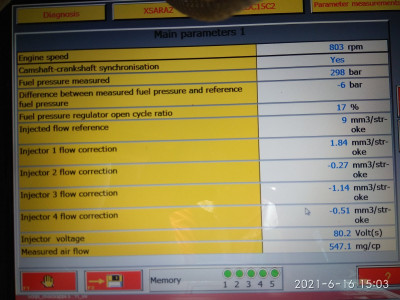

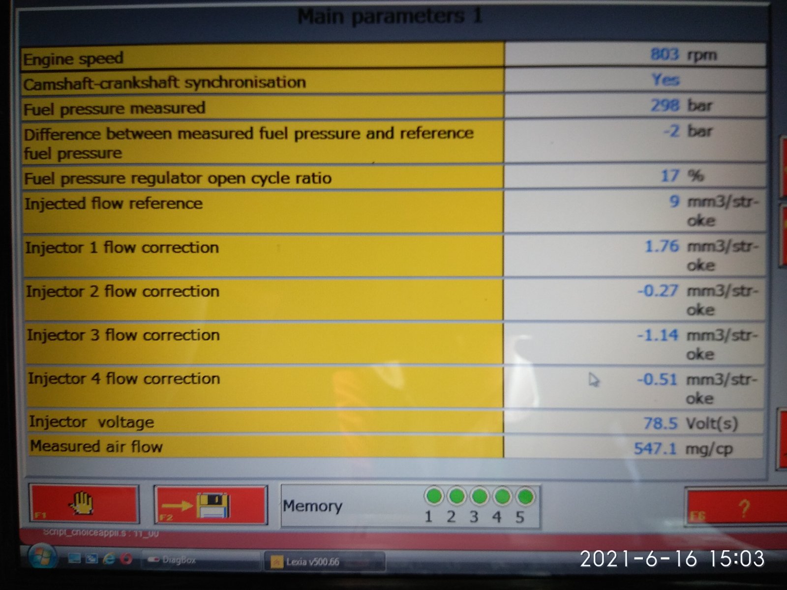

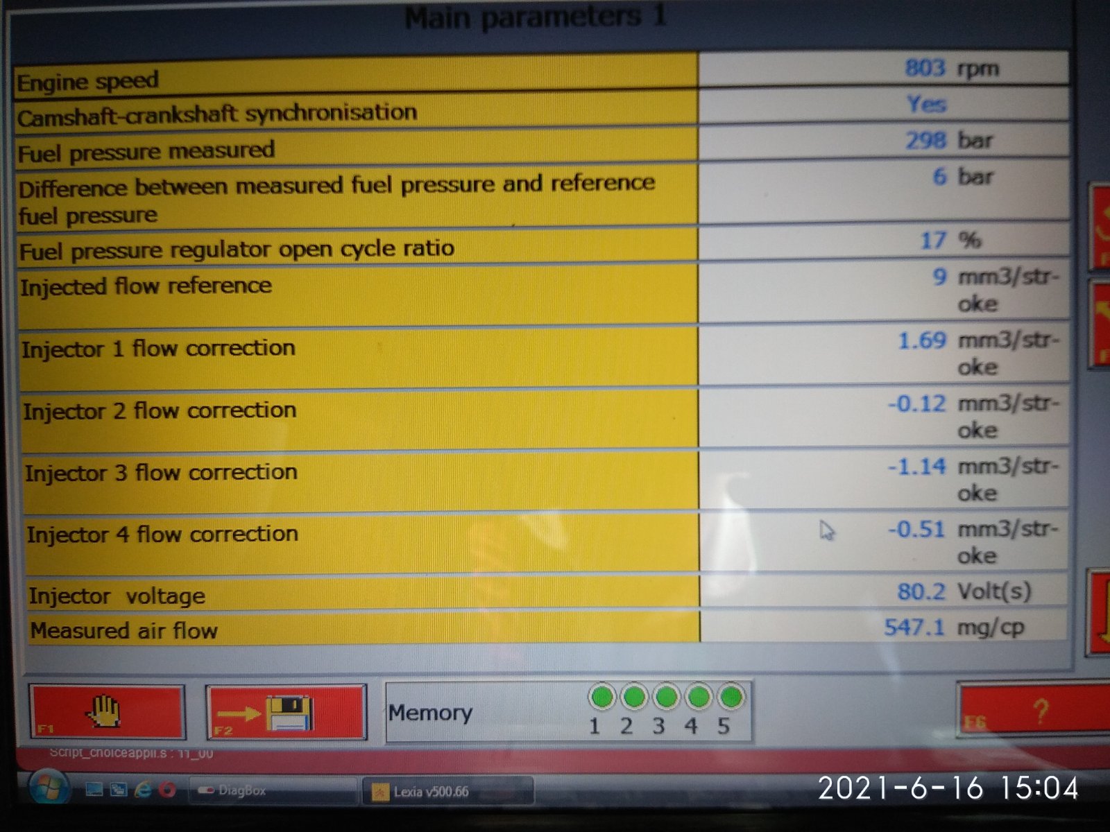

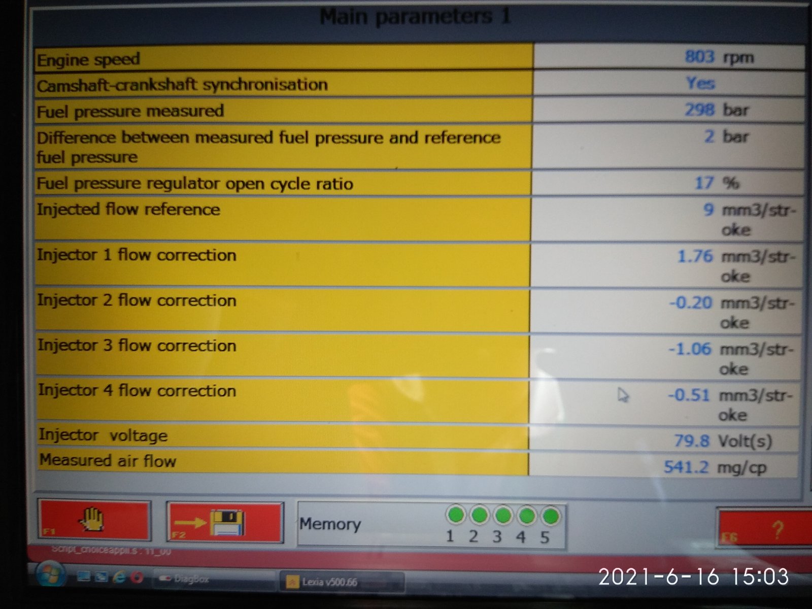

Spoke with a friend who said this is likely to be the in-tank fuel pump.
So I done some checks on it last night using the live data on the Lexia. measure pressure and reference pressure never settled at 0 as per the guidance. Flicks between -2, 2 & 6 bar.
Measured fuel pressure is 298bar (range 290 - 310).
Difference between measured fuel pressure and reference fuel pressure flickers between -2 bar, 2 bar and 6 bar, with an odd reading of -6 bar. (At steady speed, this value should fall to zero).
Engine speed is steady 803prm.
So there is something causing a problem with the fuel pressure measurement. -2 / +2 does sounds like that the LP pump in the tank is having an effect?

Worth checking BUT... and I'm no expert, if you have a problem with the in-tank pump, it would be unlikely to start.
The fuel pressure regulator is preset to an Open Cycle Ratio of 95% on ignition switch on until the fuel pressure sensor reaches the 300 bar and then it switches off. Once the engine starts, the regulator runs at generally around 17-18% OCR at idle to keep the pressure within limits.
I need to look at some of the videos I have taken but I don't think I would concerned by the differential pressure as it must be within limits when the engine is running correctly.
Interesting to note that it drops to 13.7% OCR at 2088rpm on yours though, I'd have thought it would open more because of the greater fuel demand.

Mine idles at 835rpm with 16% OCR. On revving, the OCR increases, as I suspected, as the revs increase.
Your FPR current is low too. Why?
Here is a link to my OneDrive video taken once I had resolved the issue (which had previously involved swapping the low pressure pump out only to find that didn't resolve the issue).
https://1drv.ms/u/s!Ar8AkvzZJWl9zzVbdmnivCT-TK17

Re: Xsara II 2.0 HDI 90 limp mode
I thought the OCR was okay between 12 & 18% from the Lexia help info.
Anyhow here are some shots of the live data:
Rhothgar
- (Donor 2026)
- Posts: 2433
- Joined: 22 Nov 2004, 00:21
- x 221
I’ve never seen mine drop below 16% at idle and my video shows it increasing when revved.
Yours drops so it cannot have been getting enough fuel when it failed. Does it hesitate around 2000rpm intermittently?
