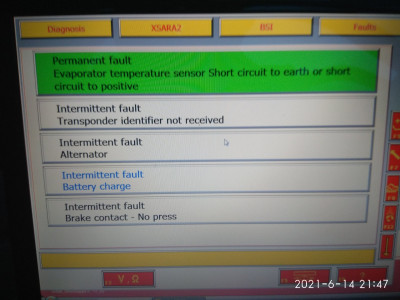

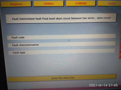

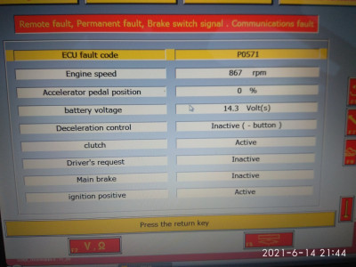

Got the call to help out in the end. What fault code would this trigger:
:roll:

I thought the OCR was okay between 12 & 18% from the Lexia help info.
Anyhow here are some shots of the live data:

I’ve never seen mine drop below 16% at idle and my video shows it increasing when revved.
Yours drops so it cannot have been getting enough fuel when it failed. Does it hesitate around 2000rpm intermittently?
