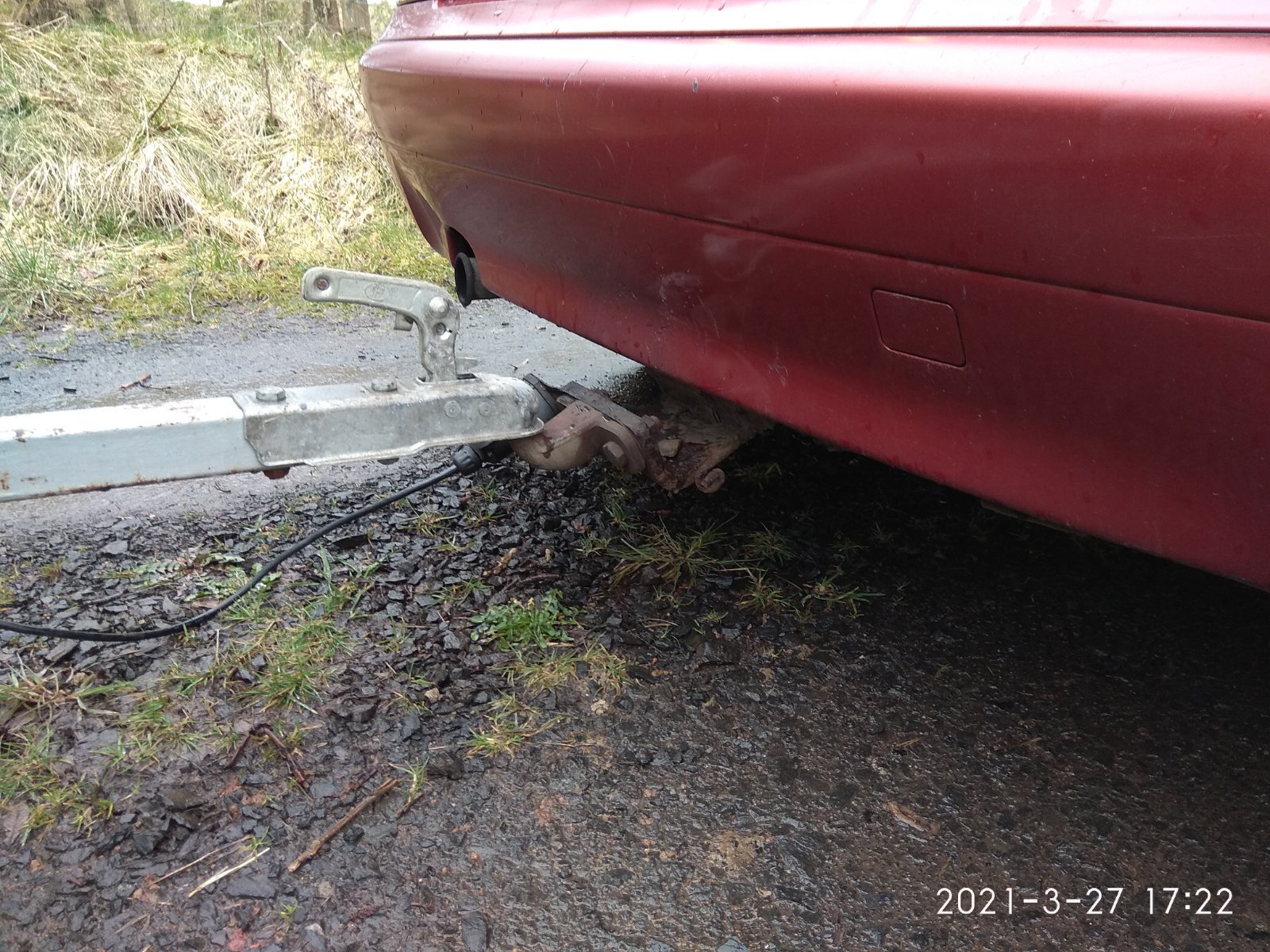

Next task now is to see how much damage the trailer has done to the rear of the car and remove the hitch setup and tidy it up.
Can I ask how you got the factory diagnosis manual? Doesn't seem much point in me having the Lexia without a way of debugging the faults.
Just read through your threads there - seems that you had a lot more problems than me with your car! Excellent diagnostic work.
I have just bought the cable probes - they seem so much better than piercing the cable with a pin and connecting on. Useful addition to the kit.
