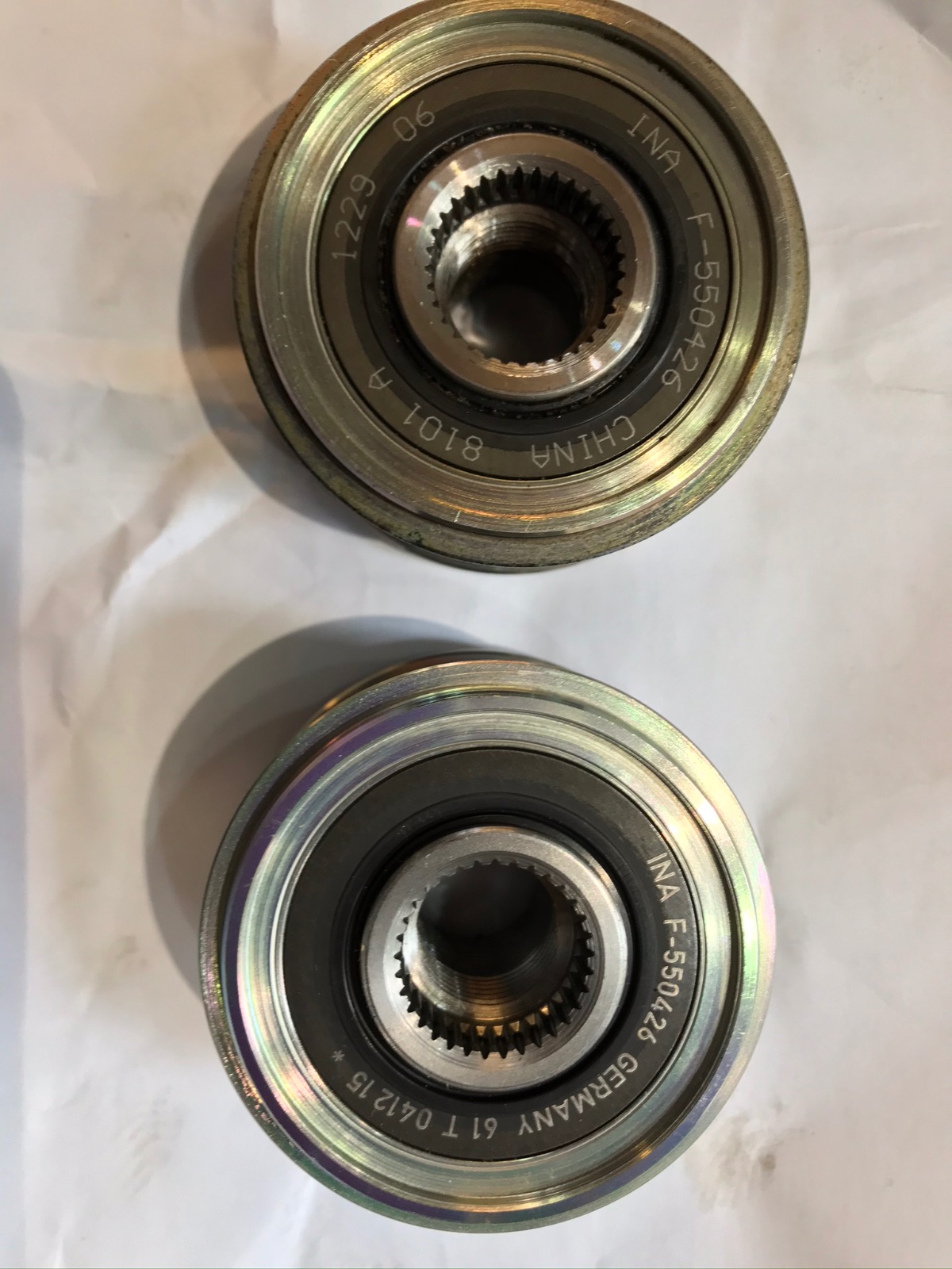

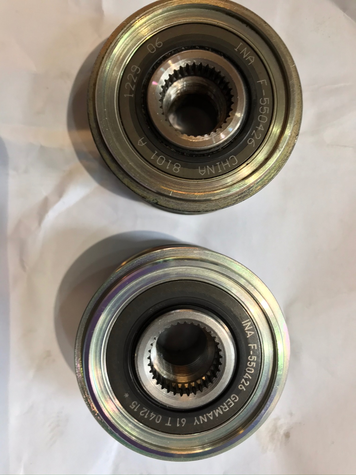

I thought I’d bring this post up to date, in the hope that it might help anybody else experiencing the same problem - plus I think some may find the attached YouTube video of interest !
Well, before this problem, I had never heard of an Overrunning Alternator Pulley (OAP !) but that’s what my problem proved to be. The noise only happened below about 1100 rpm and so, with some delicate left foot braking, (whilst my right foot ensured the engine stayed above those revs with neutral selected), I managed to nurse the old girl back to the UK all ok.
Examination the next day revealed this:
As you May be able to see, the belt kicks around like crazy at tickover speeds, whilst the tensioner bobs away like mad, trying to control things. Fortunately, with the revs slightly increased, things return to normal. I guess it was the ‘tinkling’ sound that worried me most as I envisaged something mechanical beginning to break up.
I’m still astounded as to how a seized pulley can create so much of a problem - you’d think it would just act like a solid pulley but this, together with quite a bit more on YouTube convinced me the pulley was the problem.
Unfortunately, Citroen only sell the alternator complete at £600 odd. From a photo I took of the pulley, I was able to identify the marking “INA F 550426”. Unbeknown to me, INA are one of the biggest manufacturers of Overrunning Alternator Pulleys and, after a little Googling, I was able to locate one for around just £30 at AUTODOC.co.uk. Despite the web address, they’re based in Germany and I was pretty impressed with them with just the one, significant, exception that delivery time is NOT quick - it took over a week with no express delivery service offered.
Interesting to note that the original was marked ‘CHINA’ whilst the replacement was marked ‘GERMANY’. However I reckon a life span of 160,000 for the original isn’t bad, especially when, after researching it, I see that it’s often advised these should be changed at 60 or 70,000 miles !
Fitting it required a special tool, as Lexi kindly pointed out, but they’re not expensive however, despite originally thinking I might be able to fix it from within the wheelarch, I had to remove the alternator. This entails removing the fuel filter and all its various housings (quite why they are so heavy duty - 3mm thick steel ! - I have no idea ).
Anyway, once the pulley was replaced and everything refitted it all started perfectly and normal noise levels returned. I was well chuffed with such an inexpensive and relatively easy fix after fearing, 800 miles from home, that my noise might even be terminal with about 160,000 miles on the car !
A big thank you to all who posted on here with advice and I just hope that this may be of help to some other owners.
