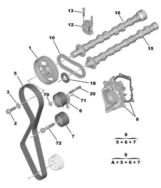

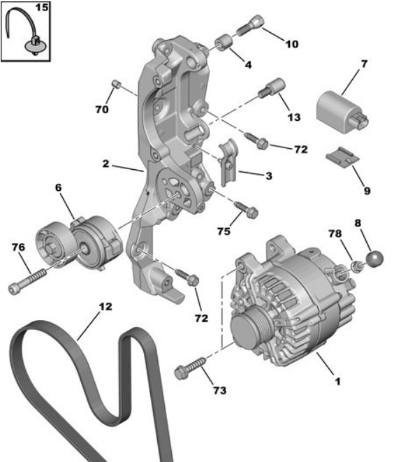

I suspect (but can't confirm obviously) that this might be a pulley or a tensioner roller:
(6) is the Timing Tensioning Timer Roller
(7) is the Retractor Roller
(6) is the Alternator Tensioner Roller
So have a closer look at these areas to see if you can identify the source. When did you last have the timing belt done and if you did, was the complete timing kit used that included replacing the tensioner rollers or was it just the belt?
