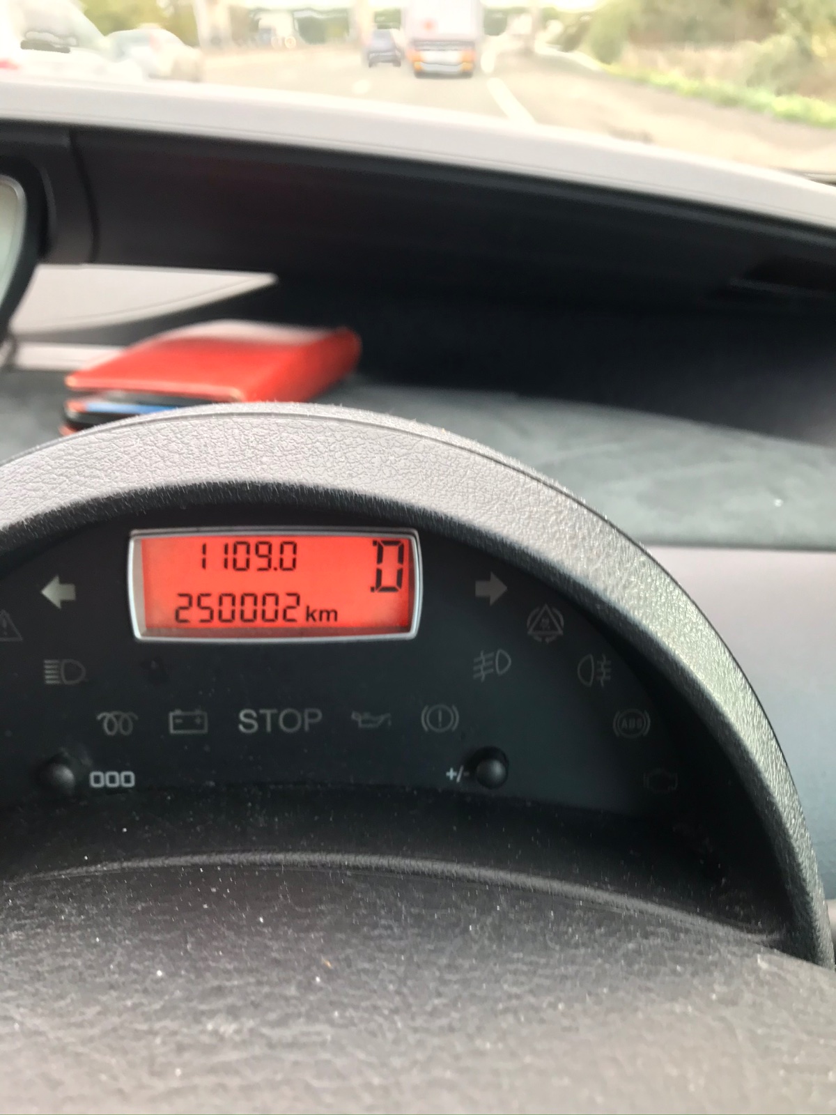

I’ve got an old Triumph Stag and I carry a very comprehensive tool kit in that. I tend to think of the C8 as ‘new’ and so don’t carry any tools - lesson learnt, methinks.
Besides, it’s not new any longer - this is what I saw on the way down here:
The trouble is, it only makes the noise when the engine is running and, on a C8, there’s not much space or access down there.
