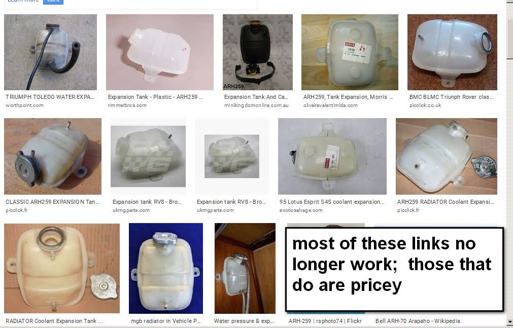

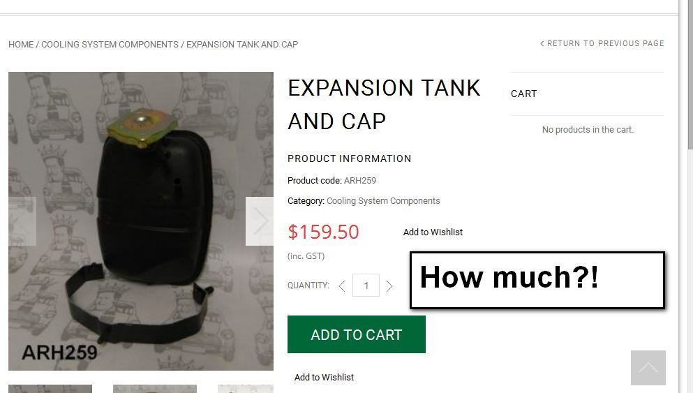

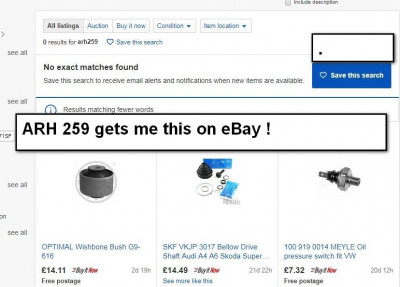

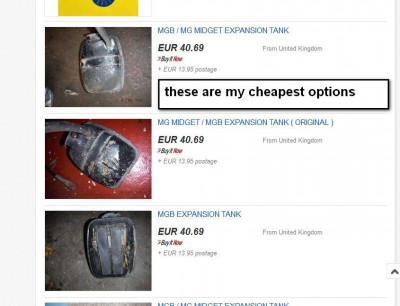

round & round in circles. I don't suppose that ARH 259 Expansion Tank is readily available in Spain at a sensible cost.... because unfortunately that's just not the case here in the UK.
Grotty used examples start at about £50, which is not a figure I can stomach and could be said to be 1/4 the value of the entire vehicle as many would take a look at the mega-mileage and various dents & scuffs and go 'not blooming likely'.
...though if I was ever to sell I'd probably start at an optimistic £500 ish, which is what I paid for it in 2011
See pics
Thanks for your help guys, but this Expansion Tank issue is now just giving me a headache.
See pics

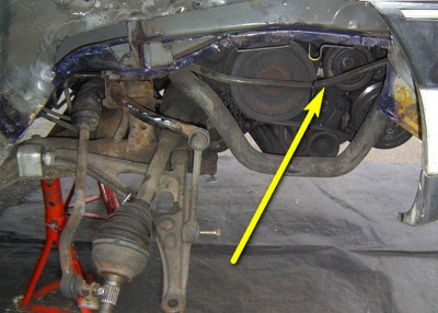

As for the Levelling Bar, I've two options
1: a sturdy bit of a Angle Iron, some Fencing Eye Bolts and the chain you see in the pics
or
2: remove the Gearbox and pull it aside, then lift just the Engine.

I certainly had one of those, but I may have got rid of it, I'll check.Pug_XUD_KeenAmateur wrote: 25 Oct 2019, 10:28

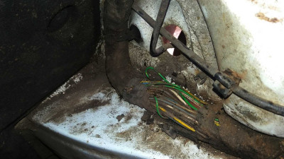

...to realise that the Cable for the Cold Start was badly frayed at the clamp, so its 'unusable' without changing the Cold Start thingy.
I was thinking about a variable load leveller which allows you to adjust the angle of the dangle once it is on the hook https://www.machinemart.co.uk/p/cll500-load-leveller/ removing the gearbox is another option - I suppose once you are ready to pull the engine, then actually dropping the box out is not too much additional work.

Ah, so that's what they're called ! Thanks ! I have already fitted the other Stat / Fuel Filter Assembly though, with the good Cable; so it'd just go into my spares stash if you're able to find it.
I see that the Clarke Load Leveller uses something akin to Eye Bolts which enhances my confidence in making something of that Ilk from a piece of Angle Iron and some Eye Bolts, possibly with a bit of weld on 'em to ensure they stay 'closed'.
Your comment inspired further thought Thank You and I've realised that separating the Gearbox in the course of having the lump out won't be difficult but...
.... getting it to mate up to the replacement engine could well be a PITA, as it indeed was when I did the Clutch 3 or 4 years back
....so it'd make sense to have one available.
This is partly what this Thread's about, thinking aloud and identifying problems before they occur, in particular while the car's useable.

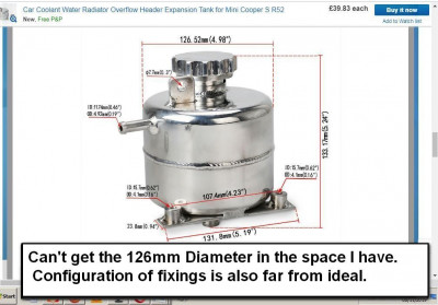

Thanks for those Item Numbers Chris; the rectangular one could potentially be made to fit, but I'm not quite sure how....
However, read on....
I think the Austin / Morris Expansion tank is one of those examples of spares 'coming of age', ie the market being such that the vehicles a part is associated with are considered worth investing in; have you noticed what original Mini's fetch these days?!
I guess if I keep the 405 long enough, it'll happen, probably initially due to some parts' association with the 205.
Sadly my Header Tank doesn't have a pressure relief, and even more sadly, in the course of my 'cracking on while the weather's with me', between making my previous post and reading your response; I've scratched it; not badly, but enough that it won't polish out, so I'm stuck with it.
I think that I'm ultimately going to have to shelve this 'Header Tank' idea entirely, except perhaps as a temporary measure for perhaps a week or so after having the cooling system apart; as I also note that there seems not to be a single Blanking Cap available online; and I realise that I don't actually understand one of the basic principles of a cooling system; ie why there has to be pressure in it in the first place
However, progress has been made, of sorts, with the removal of this, a slight re-direct of the Brake Servo Hose to come through the Bulkhead 'sooner' and a shortening of the Battery Shroud; so it is at least neater, and the space is available.

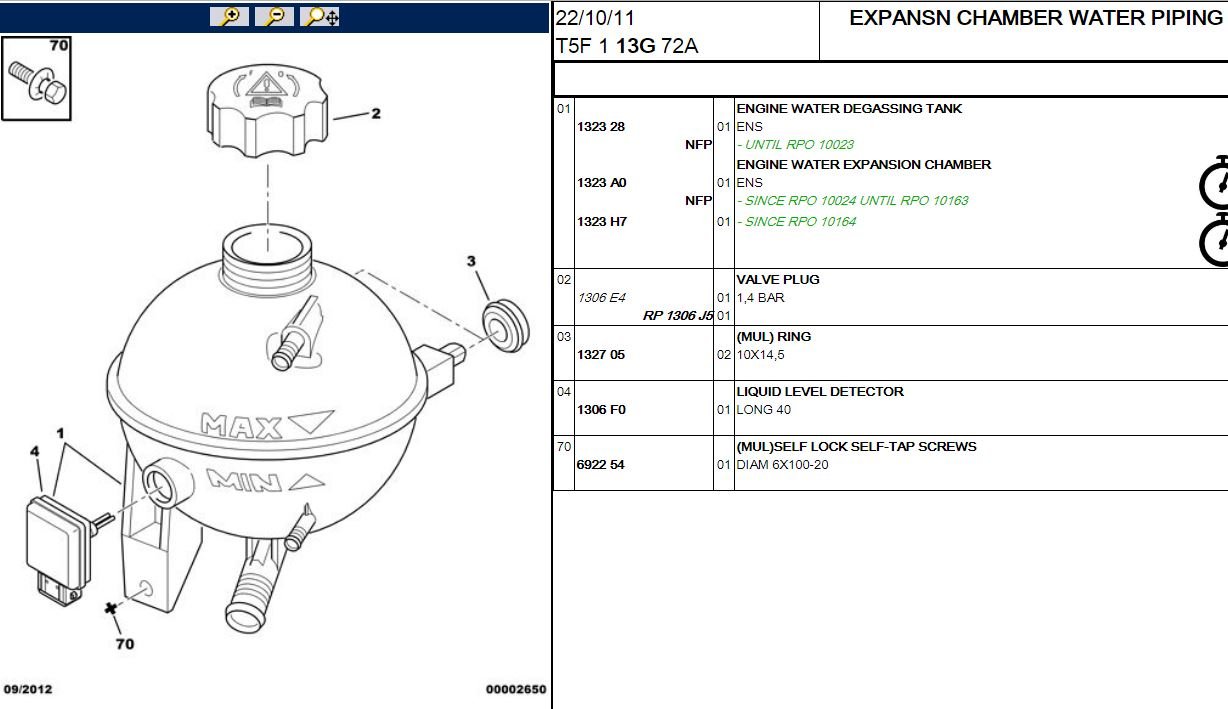

One more find, on Amazon.de (just order like a .uk a/c, same sign-in and everything):
https://www.amazon.de/AERZETIX-Ausdehnu ... ive&sr=1-4
Couldn't readily see it on Amazon.uk, but might be there.
This is the Peu 307 item; looks the same.
Has PSA-type pressure cap, as well as Low Coolant sensor facility.
A maybe.

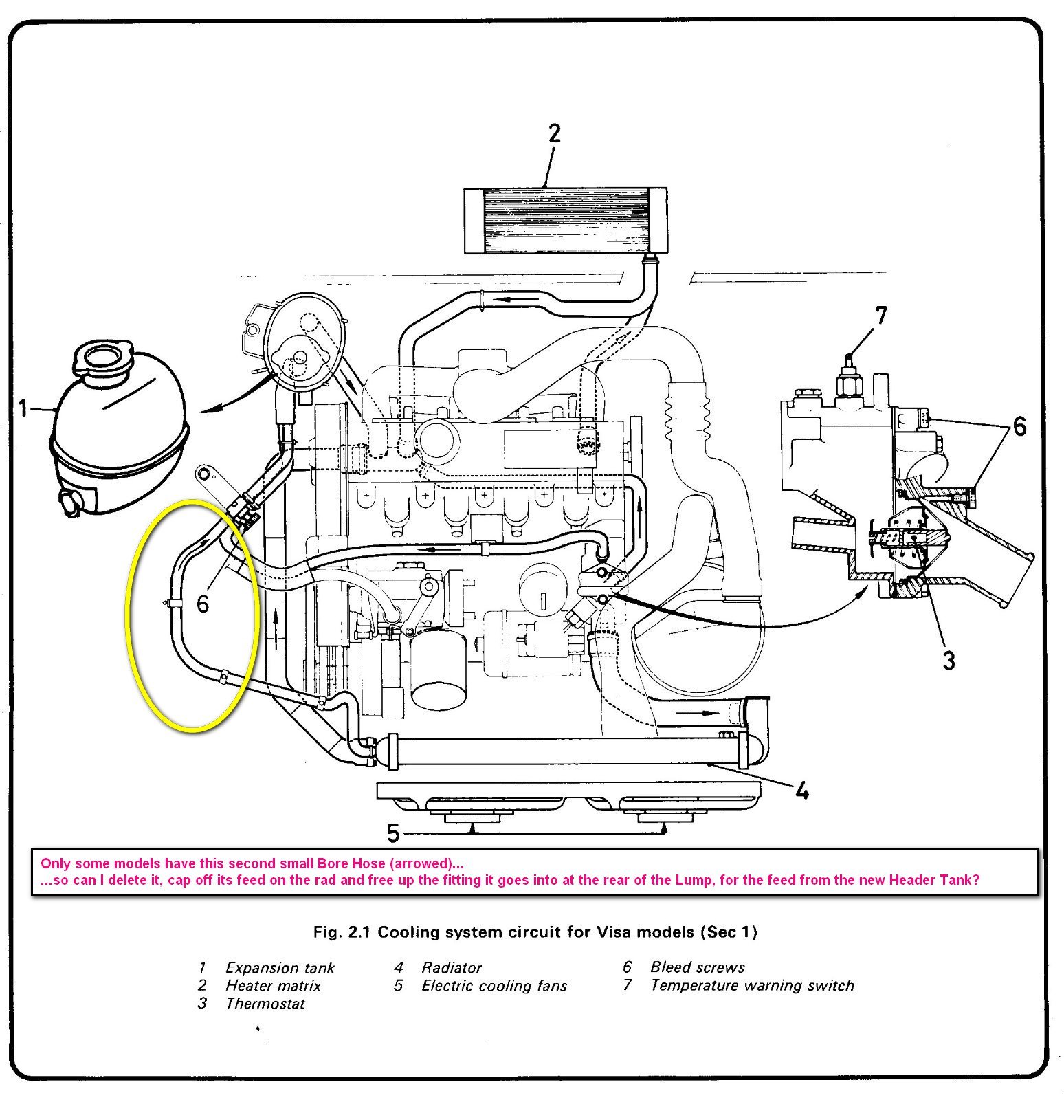

Any thoughts by the way on whether I can simply 'delete' the small bore hose that runs from the rad to the joint at the back, alongside the main Hose that goes via the Water Pump? If I was to do so, I'd have an easier way to plumb in....

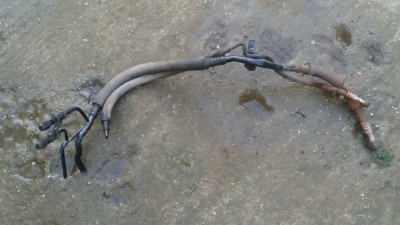

my new BX TD / GTi Header Tank from a most pleasant vendor (lovely to meet you if you're reading; am sure it won't be the last time), which will look a lot less out of place than that shiny alloy one.
The main feed hose is in quite poor condition (perished) and isn't really sensibly useable; so if anyone's got one, or has a stash of Coolant Hoses that might fit / be adapted, do shout. Else I might get lucky with a random vehicle at my local scrappies.
I've 'offered it up' and taken some measurements relating to bracketry and Tees / Connections into the existing cooling system; but I'm actually feeling a bit sick of Header Tanks at the moment, and I'm also thinking that I'm likely gonna need to break out the MIG with regard to the Bracketry and the Engine Spreader Bar; neither of which I feel like doing right now....

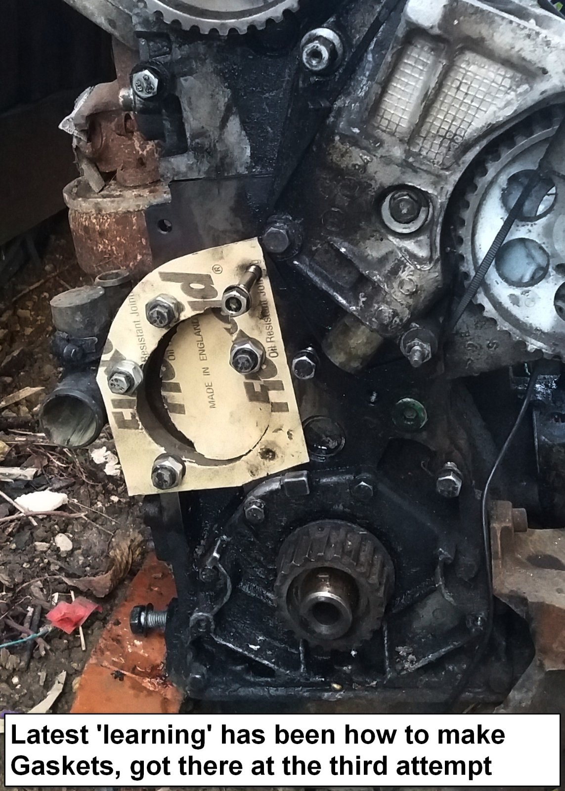

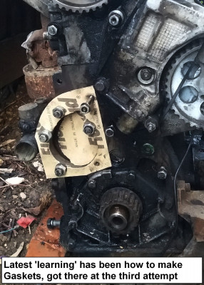

...so I'm cracking on with something else for the moment, still cooling related; I've made my very first Gasket, for the Water Pump. It took three attempts, but I got there in the end! (that's the third engine by the way, not the one I'm working on to fit, I'd hoped the Gasket would come off 'complete enough' for a pattern; it didn't)
....but surely you're replacing the Water Pump and have a new Gasket, I hear you cry; it'd be silly not to for about £30. No, I'm not. Where do you stop? You replace the Pump then you've gotta replace the Idlers and it all starts to get silly, so no, I'm not replacing it and if it all goes TU (very appropriate that on a Pug Forum) then I'm not in so deep and I might feel all the more inclined to whip the lump out and do it all again... except as with so many things, its the details that take all the time, the swap itself shouldn't present too difficulty once all the groundwork's done.

In theory you could delete that small hose from the rad top, but if the rad top is a "high point" with its top hose diving downwards, then it might be best to retain it, to allow any air trapped in the rad top to pass to the new header tank.

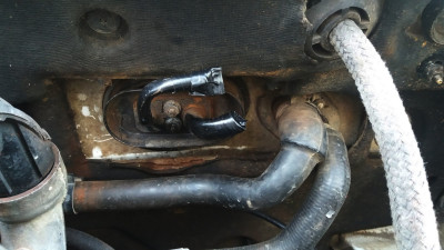

the Hose I was thinking of Deleting is this one, from the bottom of the rad fitting is slap bang next to the main big bore (36mm IIRC) Hose on the bottom of the Rad, then goes to the same Union behind the engine to 'stay mates with its big brother'. Old pic from my first bit of welding a few years back
Now how much of that difficulty is 'me' is open to question, but in my experience, something done for the first time always takes many times longer than expected
