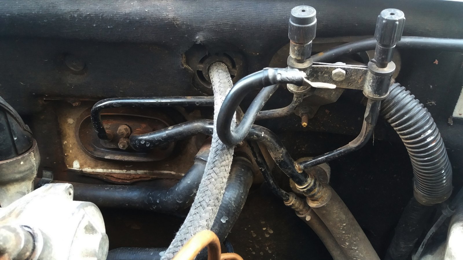

Any thoughts by the way on whether I can simply 'delete' the small bore hose that runs from the rad to the joint at the back, alongside the main Hose that goes via the Water Pump? If I was to do so, I'd have an easier way to plumb in....
my new BX TD / GTi Header Tank from a most pleasant vendor (lovely to meet you if you're reading; am sure it won't be the last time), which will look a lot less out of place than that shiny alloy one.
The main feed hose is in quite poor condition (perished) and isn't really sensibly useable; so if anyone's got one, or has a stash of Coolant Hoses that might fit / be adapted, do shout. Else I might get lucky with a random vehicle at my local scrappies.
I've 'offered it up' and taken some measurements relating to bracketry and Tees / Connections into the existing cooling system; but I'm actually feeling a bit sick of Header Tanks at the moment, and I'm also thinking that I'm likely gonna need to break out the MIG with regard to the Bracketry and the Engine Spreader Bar; neither of which I feel like doing right now....

In theory you could delete that small hose from the rad top, but if the rad top is a "high point" with its top hose diving downwards, then it might be best to retain it, to allow any air trapped in the rad top to pass to the new header tank.

the Hose I was thinking of Deleting is this one, from the bottom of the rad fitting is slap bang next to the main big bore (36mm IIRC) Hose on the bottom of the Rad, then goes to the same Union behind the engine to 'stay mates with its big brother'. Old pic from my first bit of welding a few years back
Now how much of that difficulty is 'me' is open to question, but in my experience, something done for the first time always takes many times longer than expected
