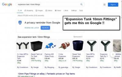

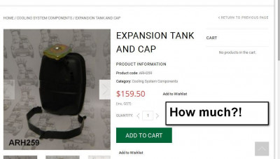

round & round in circles. I don't suppose that ARH 259 Expansion Tank is readily available in Spain at a sensible cost.... because unfortunately that's just not the case here in the UK.
Grotty used examples start at about £50, which is not a figure I can stomach and could be said to be 1/4 the value of the entire vehicle as many would take a look at the mega-mileage and various dents & scuffs and go 'not blooming likely'.
...though if I was ever to sell I'd probably start at an optimistic £500 ish, which is what I paid for it in 2011
See pics
Thanks for your help guys, but this Expansion Tank issue is now just giving me a headache.
See pics

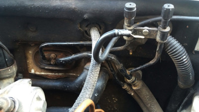

Thanks for the info on the Pressure Cap Chris and pressure in the Cooling System, I'm 'as good as there' I think with regard to understanding how it works now....
Any thoughts by the way on whether I can simply 'delete' the small bore hose that runs from the rad to the joint at the back, alongside the main Hose that goes via the Water Pump? If I was to do so, I'd have an easier way to plumb in....
my new BX TD / GTi Header Tank from a most pleasant vendor (lovely to meet you if you're reading; am sure it won't be the last time), which will look a lot less out of place than that shiny alloy one.
The main feed hose is in quite poor condition (perished) and isn't really sensibly useable; so if anyone's got one, or has a stash of Coolant Hoses that might fit / be adapted, do shout. Else I might get lucky with a random vehicle at my local scrappies.
I've 'offered it up' and taken some measurements relating to bracketry and Tees / Connections into the existing cooling system; but I'm actually feeling a bit sick of Header Tanks at the moment, and I'm also thinking that I'm likely gonna need to break out the MIG with regard to the Bracketry and the Engine Spreader Bar; neither of which I feel like doing right now....
...so I'm cracking on with something else for the moment, still cooling related; I've made my very first Gasket, for the Water Pump. It took three attempts, but I got there in the end! (that's the third engine by the way, not the one I'm working on to fit, I'd hoped the Gasket would come off 'complete enough' for a pattern; it didn't)
....but surely you're replacing the Water Pump and have a new Gasket, I hear you cry; it'd be silly not to for about £30. No, I'm not. Where do you stop? You replace the Pump then you've gotta replace the Idlers and it all starts to get silly, so no, I'm not replacing it and if it all goes TU (very appropriate that on a Pug Forum) then I'm not in so deep and I might feel all the more inclined to whip the lump out and do it all again... except as with so many things, its the details that take all the time, the swap itself shouldn't present too difficulty once all the groundwork's done.
I'm not one for throwing money at a car, so if it ever does die by the way and as I've said before, in all likelihood one day the tin-worm 'll do for it; I want a 106 Diesel. Daughter had two of 'em, Mks 1 and 2, and I loved em. Lets hope that day's a long way off.
I also thought to myself 'stuff it, I'll try n return the Alloy one, scratch 'n' all then I got this, pictured; Hmm return to Shanghai eh; think not... I did check the postage, it'd be £12, so I'm gonna keep it til the job's done then try n sell it for about a tenner. Anyone potentially want it in the future?

the Hose I was thinking of Deleting is this one, from the bottom of the rad fitting is slap bang next to the main big bore (36mm IIRC) Hose on the bottom of the Rad, then goes to the same Union behind the engine to 'stay mates with its big brother'. Old pic from my first bit of welding a few years back
Now how much of that difficulty is 'me' is open to question, but in my experience, something done for the first time always takes many times longer than expected
