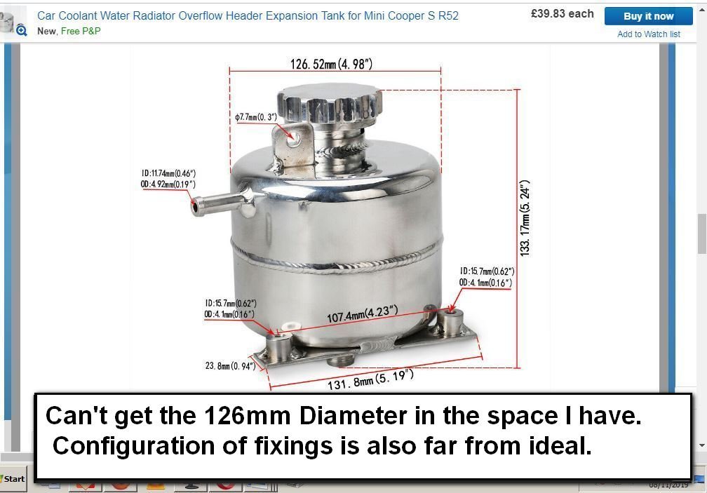

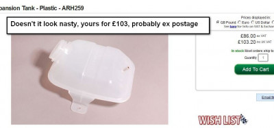

round & round in circles. I don't suppose that ARH 259 Expansion Tank is readily available in Spain at a sensible cost.... because unfortunately that's just not the case here in the UK.
Grotty used examples start at about £50, which is not a figure I can stomach and could be said to be 1/4 the value of the entire vehicle as many would take a look at the mega-mileage and various dents & scuffs and go 'not blooming likely'.
...though if I was ever to sell I'd probably start at an optimistic £500 ish, which is what I paid for it in 2011
See pics
Thanks for your help guys, but this Expansion Tank issue is now just giving me a headache.
See pics

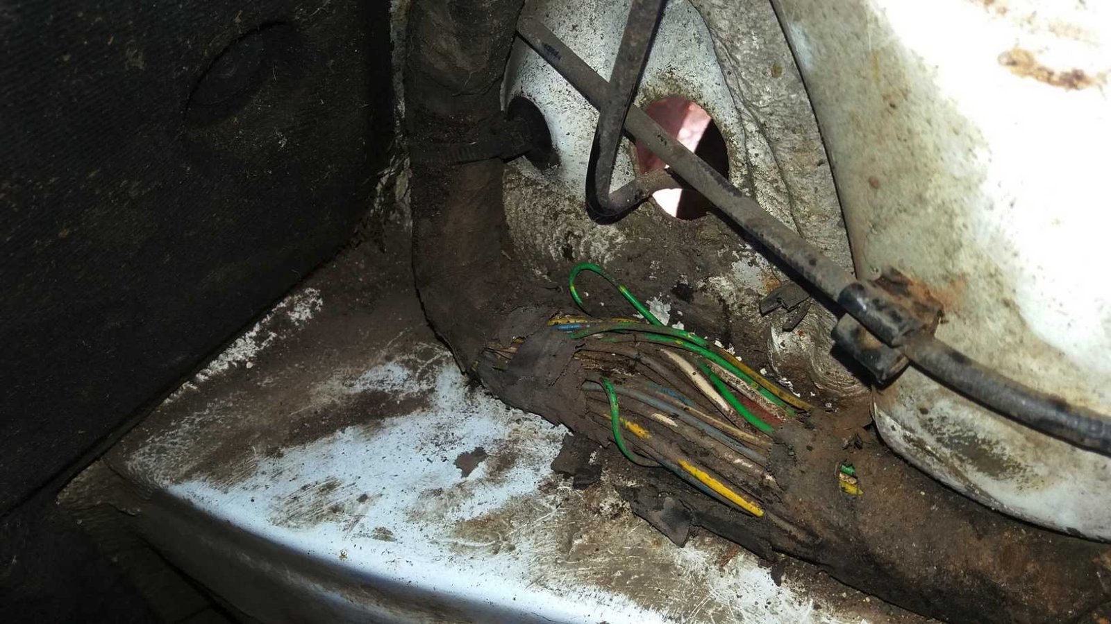

...to realise that the Cable for the Cold Start was badly frayed at the clamp, so its 'unusable' without changing the Cold Start thingy.

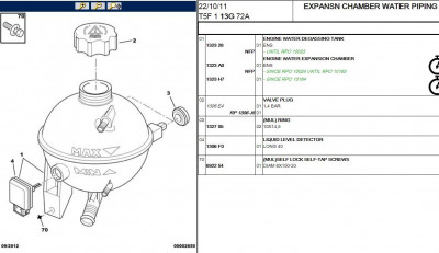

One more find, on Amazon.de (just order like a .uk a/c, same sign-in and everything):
https://www.amazon.de/AERZETIX-Ausdehnu ... ive&sr=1-4
Couldn't readily see it on Amazon.uk, but might be there.
This is the Peu 307 item; looks the same.
Has PSA-type pressure cap, as well as Low Coolant sensor facility.
A maybe.
A maybe.

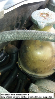

my new BX TD / GTi Header Tank from a most pleasant vendor (lovely to meet you if you're reading; am sure it won't be the last time), which will look a lot less out of place than that shiny alloy one.
The main feed hose is in quite poor condition (perished) and isn't really sensibly useable; so if anyone's got one, or has a stash of Coolant Hoses that might fit / be adapted, do shout. Else I might get lucky with a random vehicle at my local scrappies.
I've 'offered it up' and taken some measurements relating to bracketry and Tees / Connections into the existing cooling system; but I'm actually feeling a bit sick of Header Tanks at the moment, and I'm also thinking that I'm likely gonna need to break out the MIG with regard to the Bracketry and the Engine Spreader Bar; neither of which I feel like doing right now....

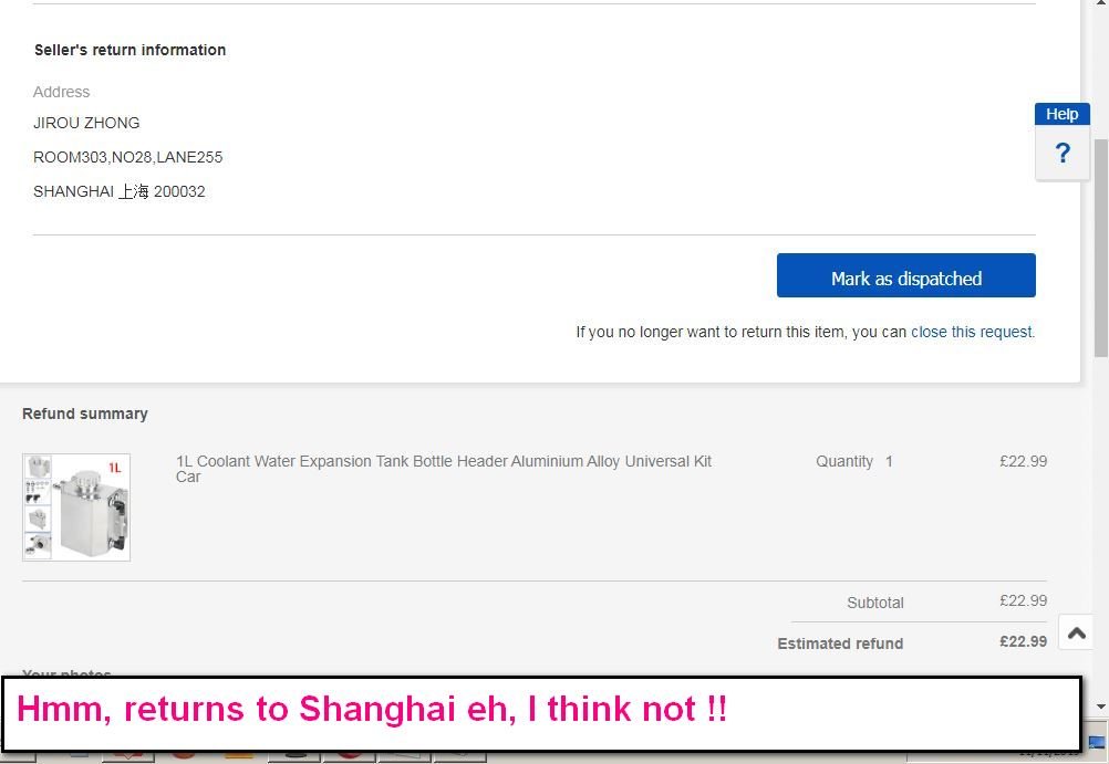

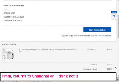

I also thought to myself 'stuff it, I'll try n return the Alloy one, scratch 'n' all then I got this, pictured; Hmm return to Shanghai eh; think not... I did check the postage, it'd be £12, so I'm gonna keep it til the job's done then try n sell it for about a tenner. Anyone potentially want it in the future?

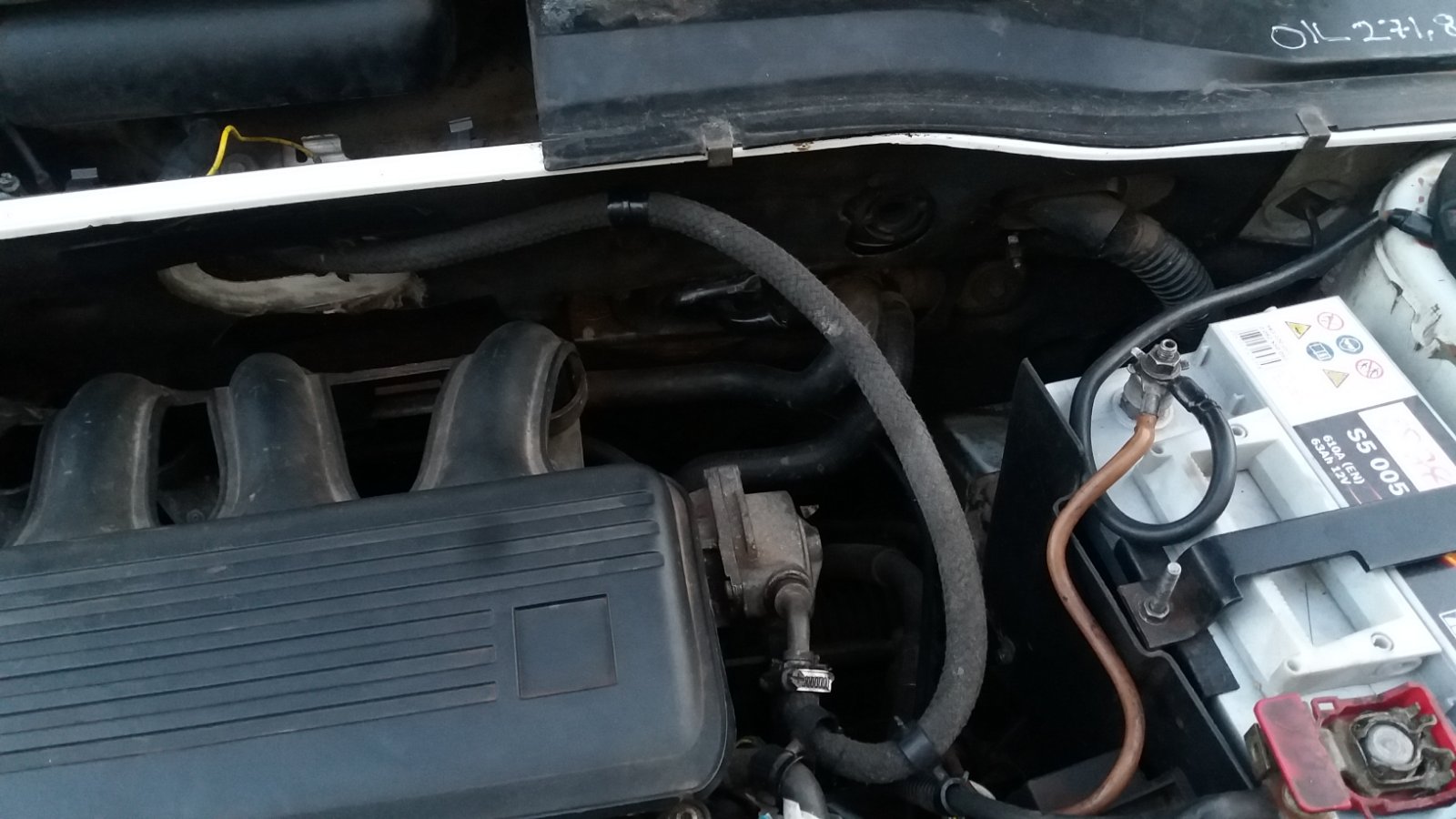

the Hose I was thinking of Deleting is this one, from the bottom of the rad fitting is slap bang next to the main big bore (36mm IIRC) Hose on the bottom of the Rad, then goes to the same Union behind the engine to 'stay mates with its big brother'. Old pic from my first bit of welding a few years back
Now how much of that difficulty is 'me' is open to question, but in my experience, something done for the first time always takes many times longer than expected
