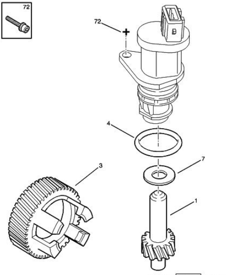

GiveMeABreak wrote: 10 Apr 2018, 20:01 Here's the Tachometer control on the gearbox pinion for your engine:
Hi there,
the screw (pos. 72) is for Hex Allen Key, not Torx, right?
BR
Martin

Re: Erratic Speedometer
It's a DIAM 7X100-15

Thanks for the lightning info Marc!
OK, think I managed to decipher it, this should be metric thread M7 mm by 1 mm thread step and 15 mm lenght.
I couldn't fit any key of my own, which would engage it. Also can't see it from above.
I guess some regrinding would be neccessary to fit lets say Hex Allen Key for M8, or buy the proper tool :D.
BR
Martin
Only himself the stupid makes wrong, many are being confused by the clever :P
x 6957
Most of the bolts are TORX fittings Martin - but that diagram I posted was for a Citroen Dispatch Van and they are different according to vehicle - so be aware - if you are wanting this for your Xantia - the bolt is completely different. If you can post the VIN for the vehicle you want the info for I can get the correct one.

Bought yesterday a 7 mm hex allen key, but still couldn't engage it from above. Made some pics with my phone and from what is visible on them, it doesn't seems to be a TORX head. Doesn't matter anymore as I am already p*ssed off and I'm going to tackle it face to face under the car :D
P.S.: I guess I'm getting stupid :D. You can't see it under the car either. Tried again with my new 7 mm hex allen key -> nope. Put a finger on it an the oil print seemed like hex hole. Don't know why I took the T40 key (torx) and it got unscrewed -> after finally looking at the bolt's head, doh it is for 6 mm hex :rofl2:
Hi, first of all, thanks for a lot of info I've got from this thread!
And the question, do you have the part number for the pos.3?
264306 is the longer version and 264306 has only 2 "feet"... I need one exactly like pos. 3 but I can't find the part nr.
