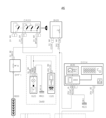

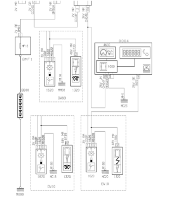

Re: Erratic Speedometer
Right so these diagrams are split in 2 so you can follow the second diagram on from the first one.
Click the Diagrams to Zoom
Bear in mind the diagram is intended to show options for the different engine variants - so in your case, it will be the lower left one identified as DW10 - however, they simply interchange with the wires actually shown on the 'EW10' engine next to it
Code | Description |
1620 | is the Speed Sensor |
1320 | is the Engine ECU |
BH28 | is the Passenger Compartment 28-fuse box |
4000 | is the Instrument Panel Central Electronic Module |
4630 | is the Vehicle Speed Indicator |
0004 | is the Instrument Panel |
Hi Marc,
thanks very much for that.
I've connected a new earth to the sensor, so I'll see what difference that makes when I drive it tomorrow.
I see the 12V supply from the passenger-side fuse-box feeds the sensor and the instrument cluster - do you know if port 20 is the power to component 4000? If 4000 lost power, presumably I'd notice something on the dashboard, like the odometer going blank or something? If that's the case, I think I can fairly well narrow it down to a bad earth.
I'll let you know if I've fixed it tomorrow
Thanks
Thanks
The diagram just shows the connection into the instrument display for the speed sensor only - there are lots of other components going into the instrument cluster, so this probably only shows the relevant connection.
Earths are always a good place to start though

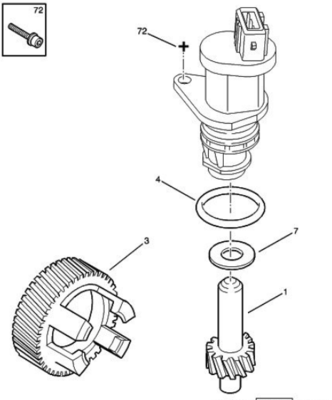

Here's the Tachometer control on the gearbox pinion for your engine:
Hi Marc,
thanks for that - I suppose it depends how gear 3 is driven, but I can't see from the diagram how the sensor drive could just stop...hopefully it's still an electrical fault.
Thanks for your help

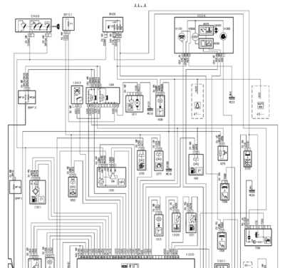

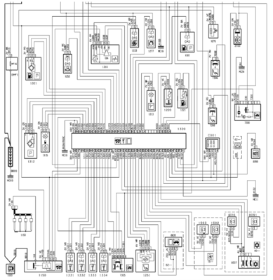

Ok, so here's the wiring for the Engine ECU, showing K2 connection (wire 6739) from the top of the ECU, located in the 48 pin brown plug.
Diagram in 2 parts again with overlap:
