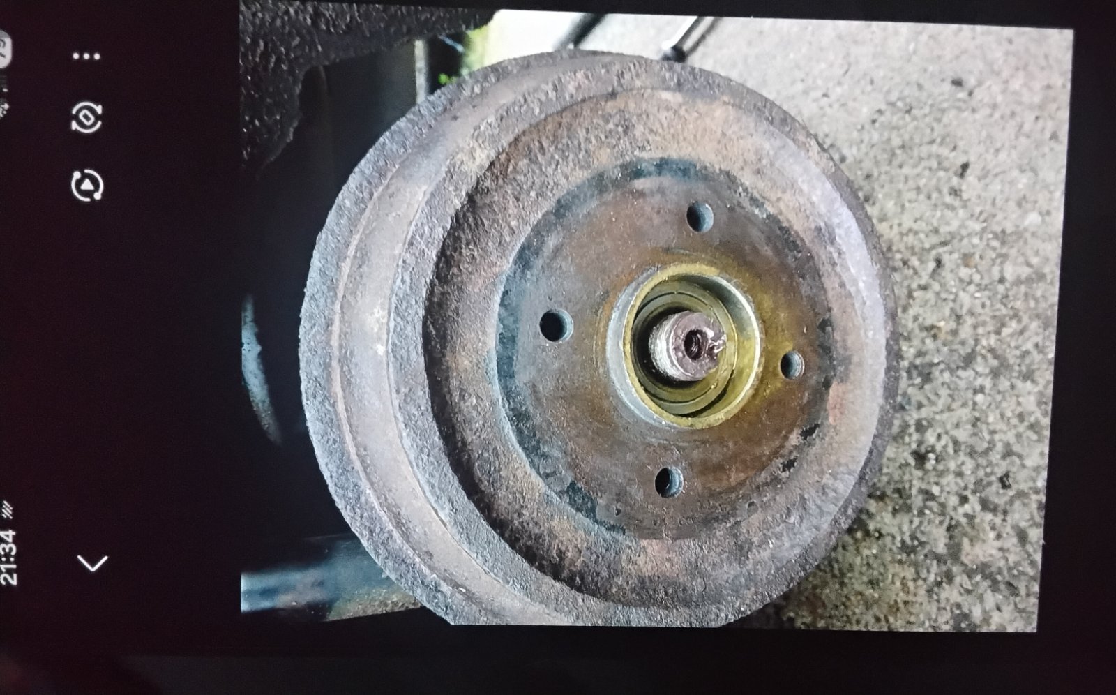

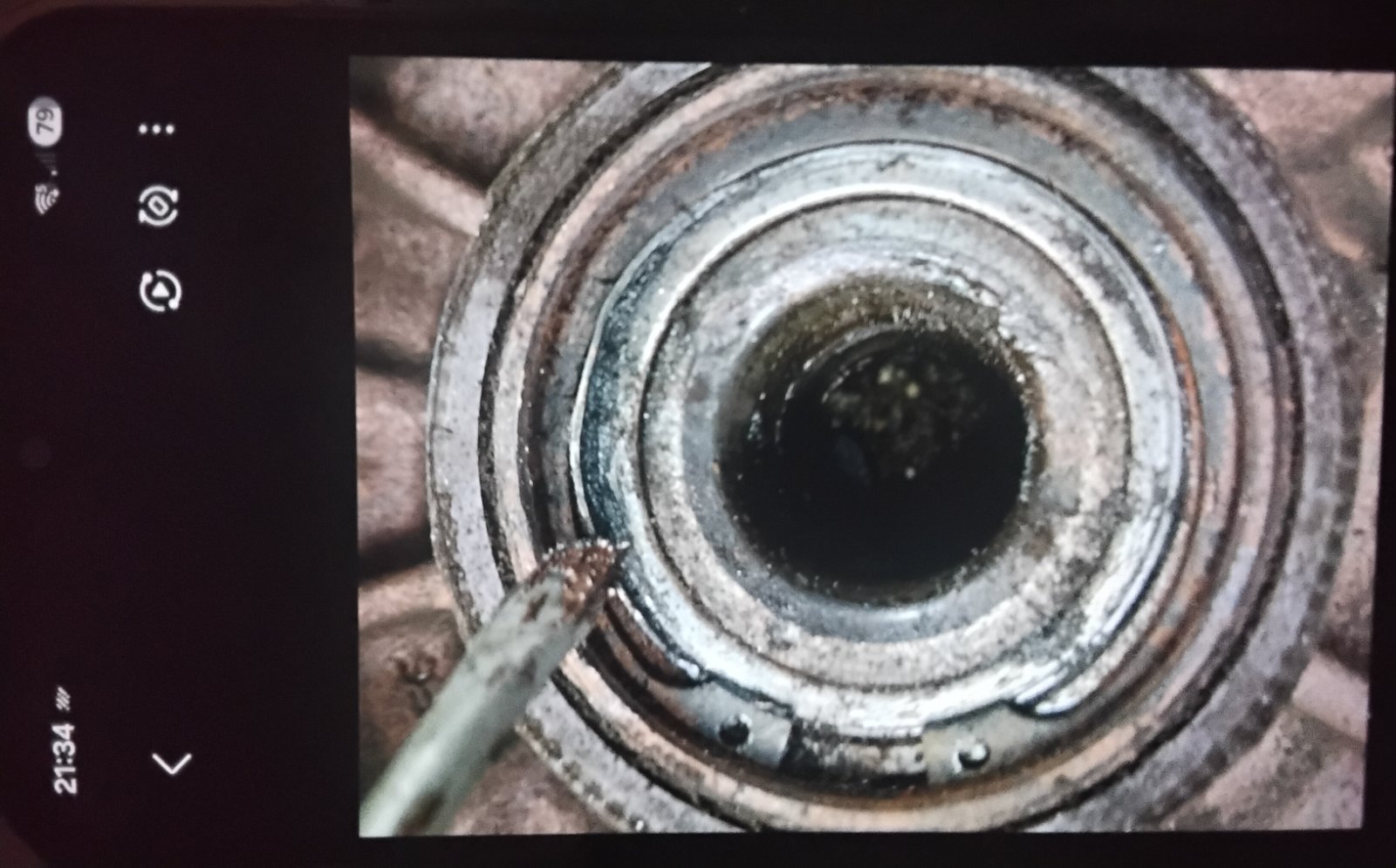

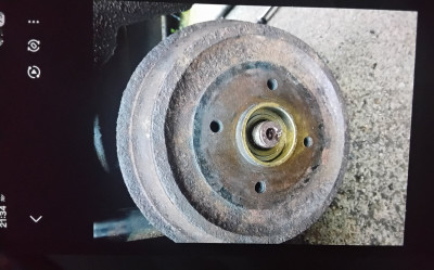

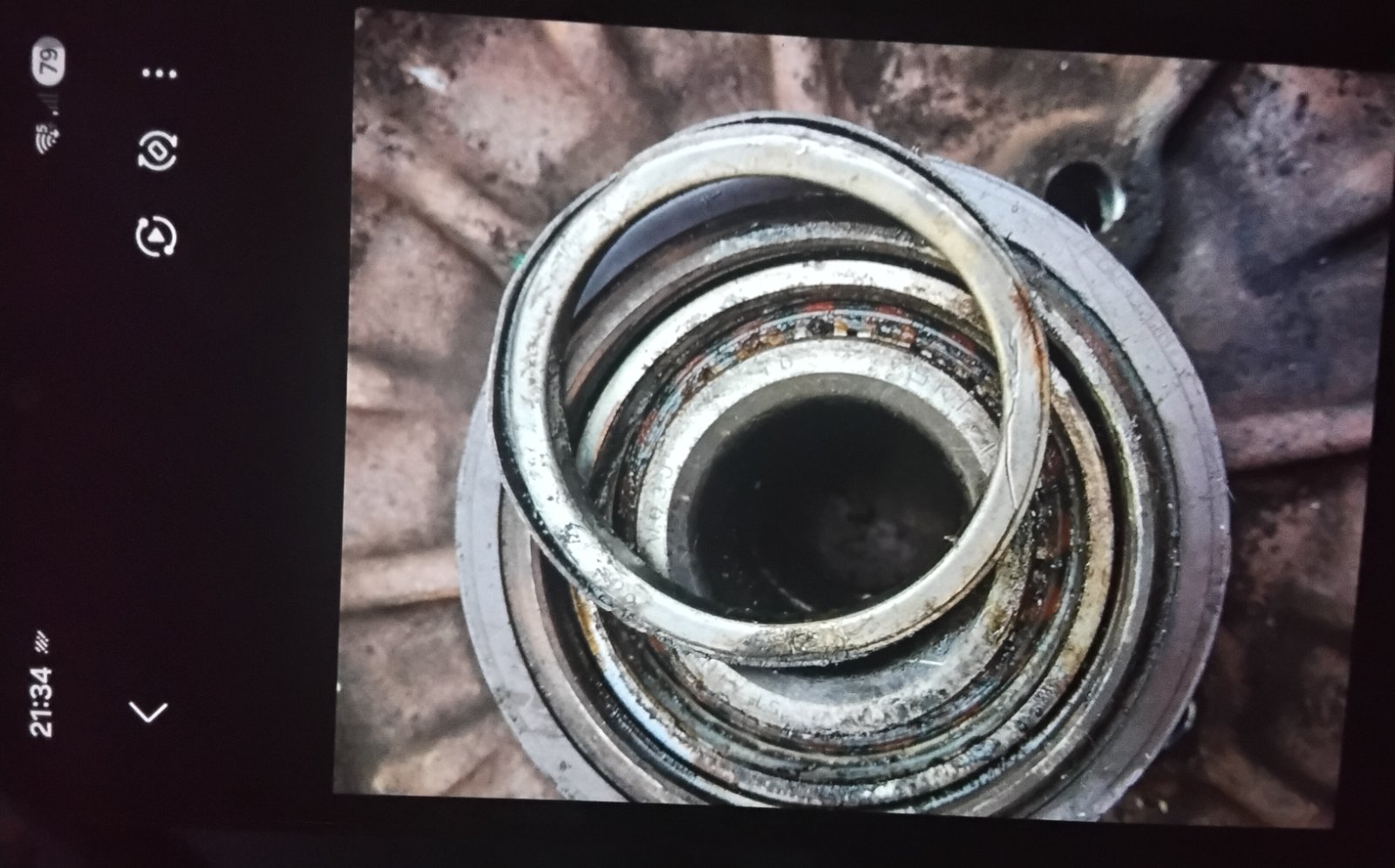

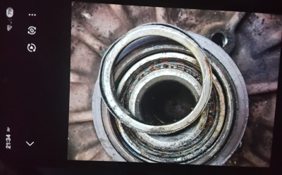

I tackled the rear wheel bearing took 2 hrs was a bit of a faff my press didn't have a perfect fit for the one in it but it came out , pressing one back in was easy as I used the out case of the old bearing which I've built up a little collection of over the years and do come in very handy as there perfectly sized. How ever .... the noise is still there , im now thinking either the new shock is naff , or , filler neck pipe possibility of that hitting wheel arch liner , and another grrrrr , part of the lip the wheel sits and slides over broke off ! Ffs moment now I got to buy a completely new drum all that effort for nothing 😒 😑 todays been crap. Went to get some items in a shop this morning self check out didnt want to play ball , young shop assistant was a useful as a chocolate tea pot he could see something was wrong and just stood there looking like a butterfly has just flown past him, so I shoved the trolly to him said stuff that and went else where , cant be doing with it

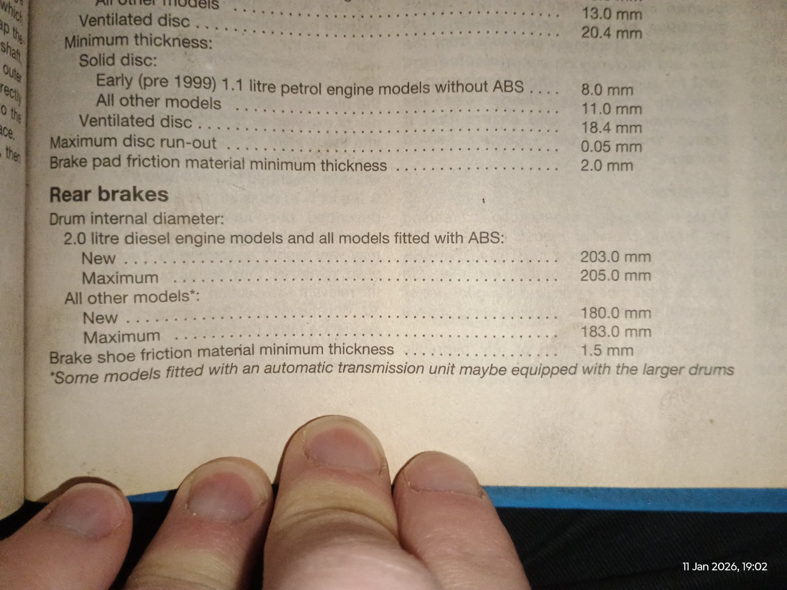

MattBLancs wrote: 11 Jan 2026, 19:03
Huskyxantia wrote: 11 Jan 2026, 18:52 Anyone know the thickness the brake drum should be ? Untill they need new ones ?
Sorry drum maximum inside diameter or shoe friction material thickness?
Sorry I haven't a book of lies for 207, if they've carried over same drum setup as the 206 uses, then here's the figures from Haynes:
Not sure if I've measured wrong he's my effort
250mm outer
225mm inner
220mm face
How do them numbers sound ?
306 has
New 180mm to max 181mm or Bendix new 228.6 to max 230 mm
Shoes new 4.85 mm to minimum 1.5 mm

Plenty of free play with hardly any effort to make it move and wiggle till it pops off part of itself, top photo completed task
