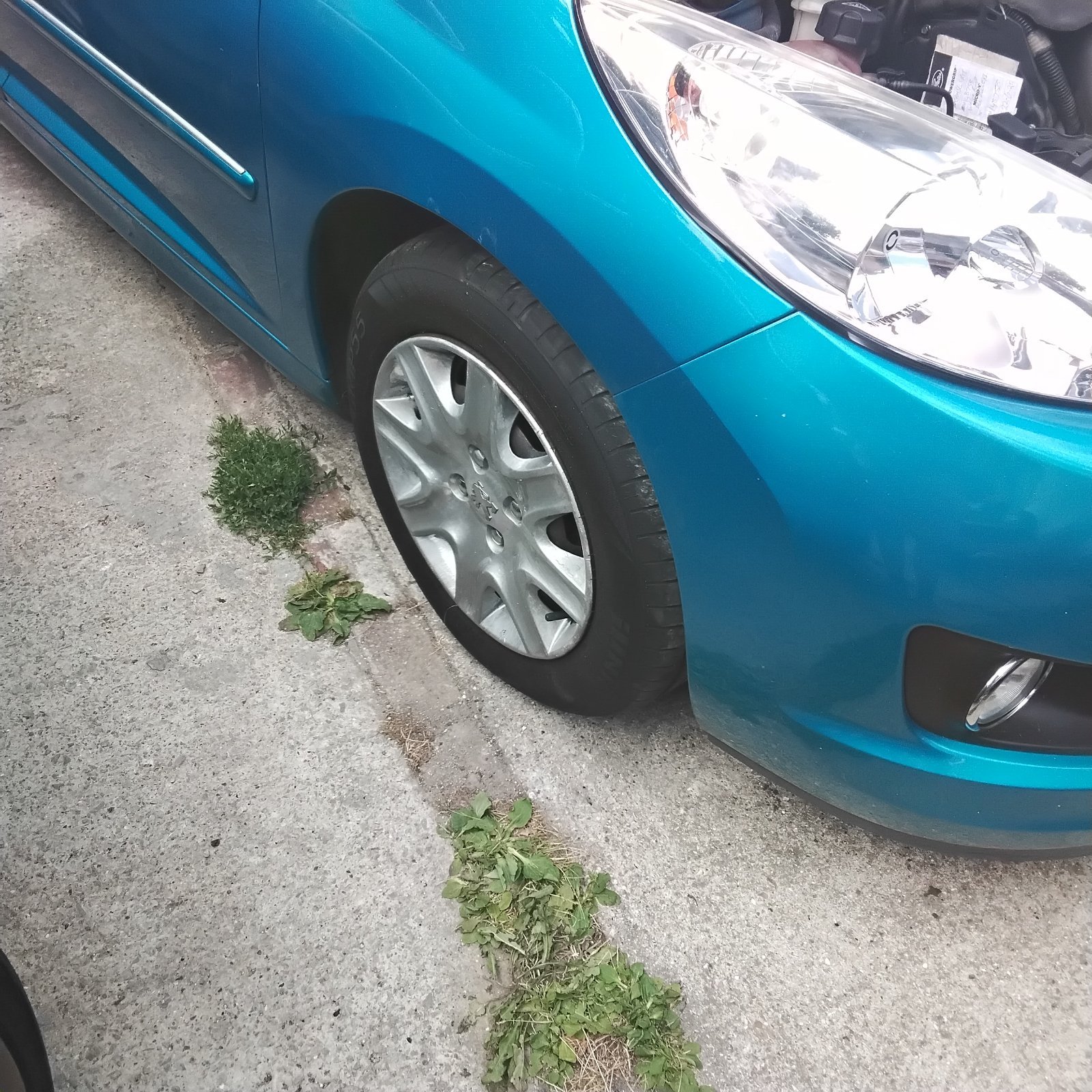

A quick photo more will follow .
I mentioned 3 fault codes in a previous post , while going through some service history it had a new camshaft sensor fitted along with the battery being charged too . Code read aswell is what has been written down on the invoice.,So the codes I found relate to that & didn't get cleared. When changing the tie rod earlier ( I did it as soon as I got home ) the inner tie rod gaiters look very dry cracked and one was spilt so 2 are on order ive already 2 inner tie rods so sometime next week I will fit them on . Then a service and 3 weeks I'm going to put it through an mot. The car has failed mots I the past on bulbs , wipers and brake pads.

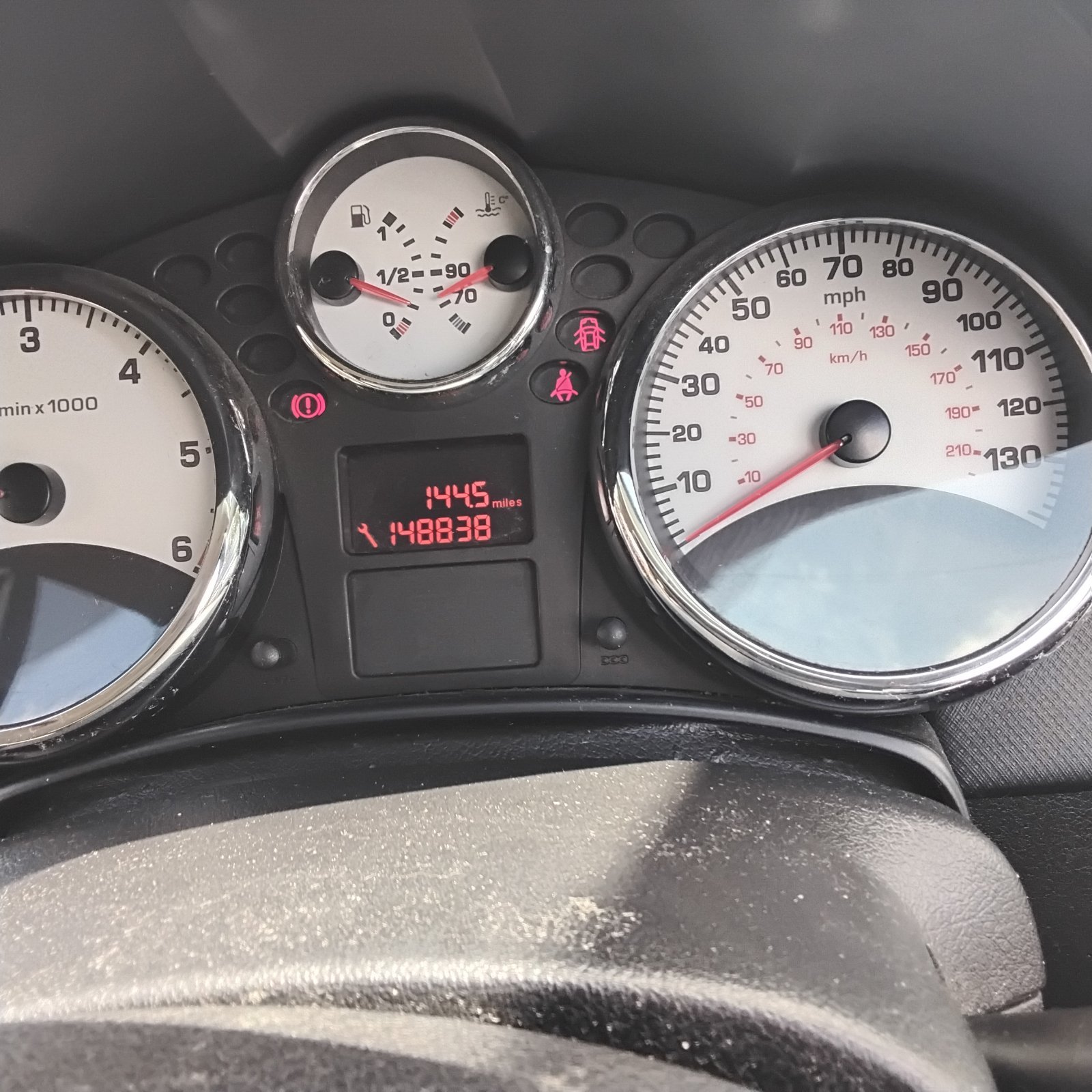

Hello I'm back , God I've been so busy but here's an up date and I will get some photos of the car soon as I can but here we go.

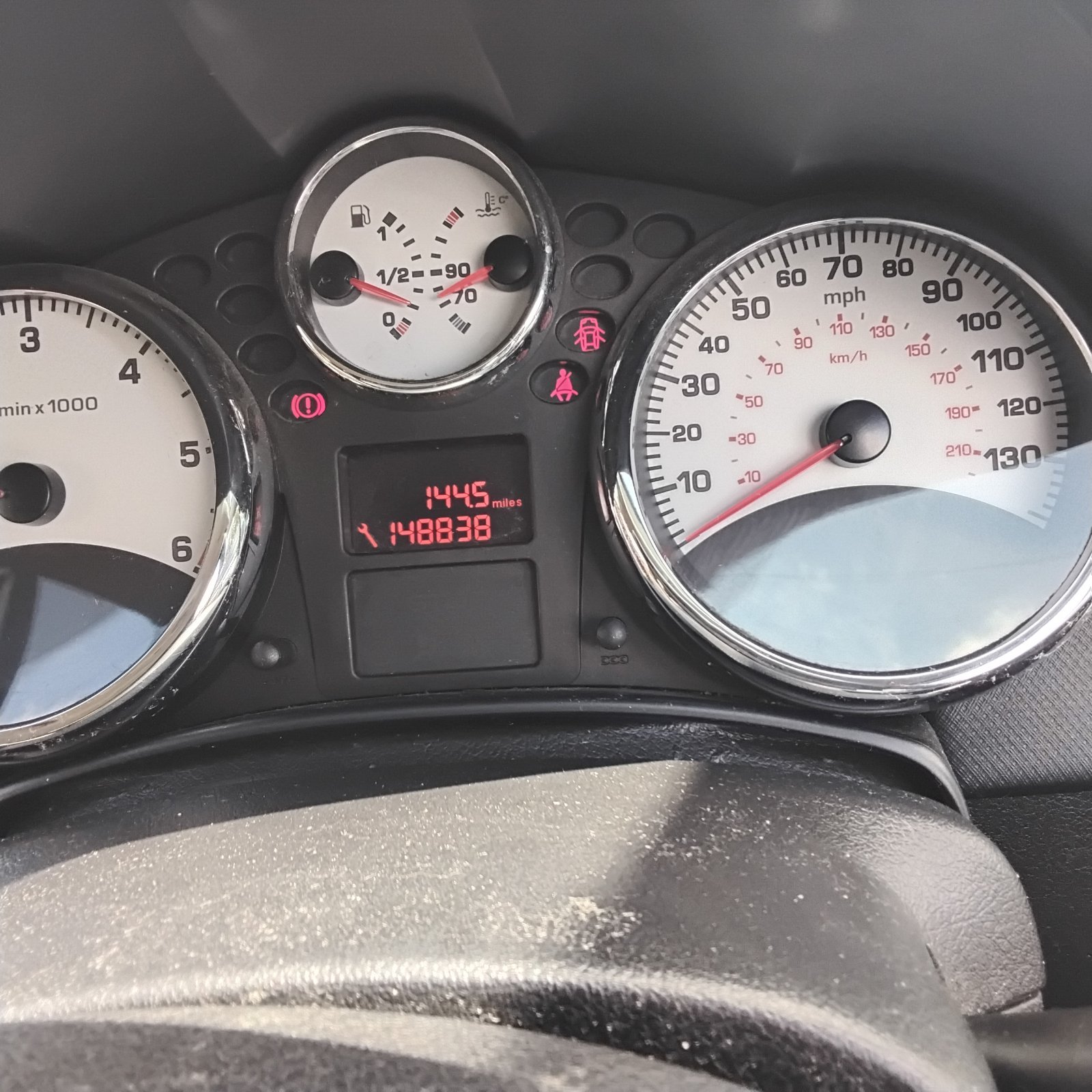

Ive had several runs with the 207 and it's had the temperature sensor float up and down but no over heating , the sensor is naff so new one ordered and today I with a struggle god help me ( I think he did at one point ) new Cambelt,pulleys and water pump all fitted this afternoon at just over 148 thousand miles. The old water pump was dated 2012 ..... shock
and had very rubbish movement , the belt had more crack(s) than Keith Richard has ever had in his life
so I think
I did the right thing. A very dear old friend of mine whom passed away covid time once said to me always do a new timing belt kit when ever you get another car , it's better to be safe than sorry, unless you have some history to back up otherwise.
It was so nice putting the last bolt back in and topping up the coolant and firing it up and it bursting into life
perfect my lovely wife came out and gave me a peck on the check ( no my shorts were not down like a builders style ) my face checks ,and she said well done ,then had to help me up off the ground as I'd locked up lol
flipping hip....
I've seen a small hole in the driver side front chassis extension leg but have seen this isnt under any mot fails ,but I'm going to weld a plate about 2 inches thempn black it over, the passenger side top tie rod was done the other week as it was naff, I've got inner , outer tie rods , drop links , lower wish bones which turned up 24 hrs after I ordered them so they can be sorted when I have time. I think that's about it , oh oil and filter change too then it should be ok, the timing belt kit was a gates £96, which was purchased for the 308cc so I've got another one which will be here next week , the complete suspension parts were £89 .99 with £20 off and ive got oil and filters in the shed so all in all not to bad I guess.
The c3 picasso is still sitting on the drive looking like it ain't got a clue what it should do, do miss it but no I can't go through that feeling of wondering if the thing will go wrong after repairs so it will go , even if I scrap it at least I can get 340£ or there abouts.
That's about it for now . Anything else happens I will report back .

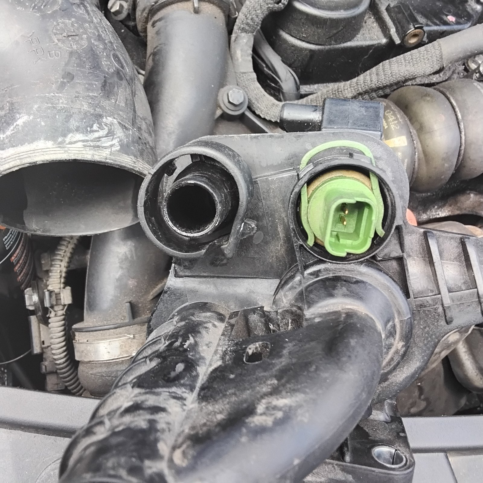

Nice feeling knowing you've completed a task to the car, should have the new thermostat housing on it today , funny how they don't supply the bleed valve . You get everything else apart from that . I will get some photos today so watch this space.

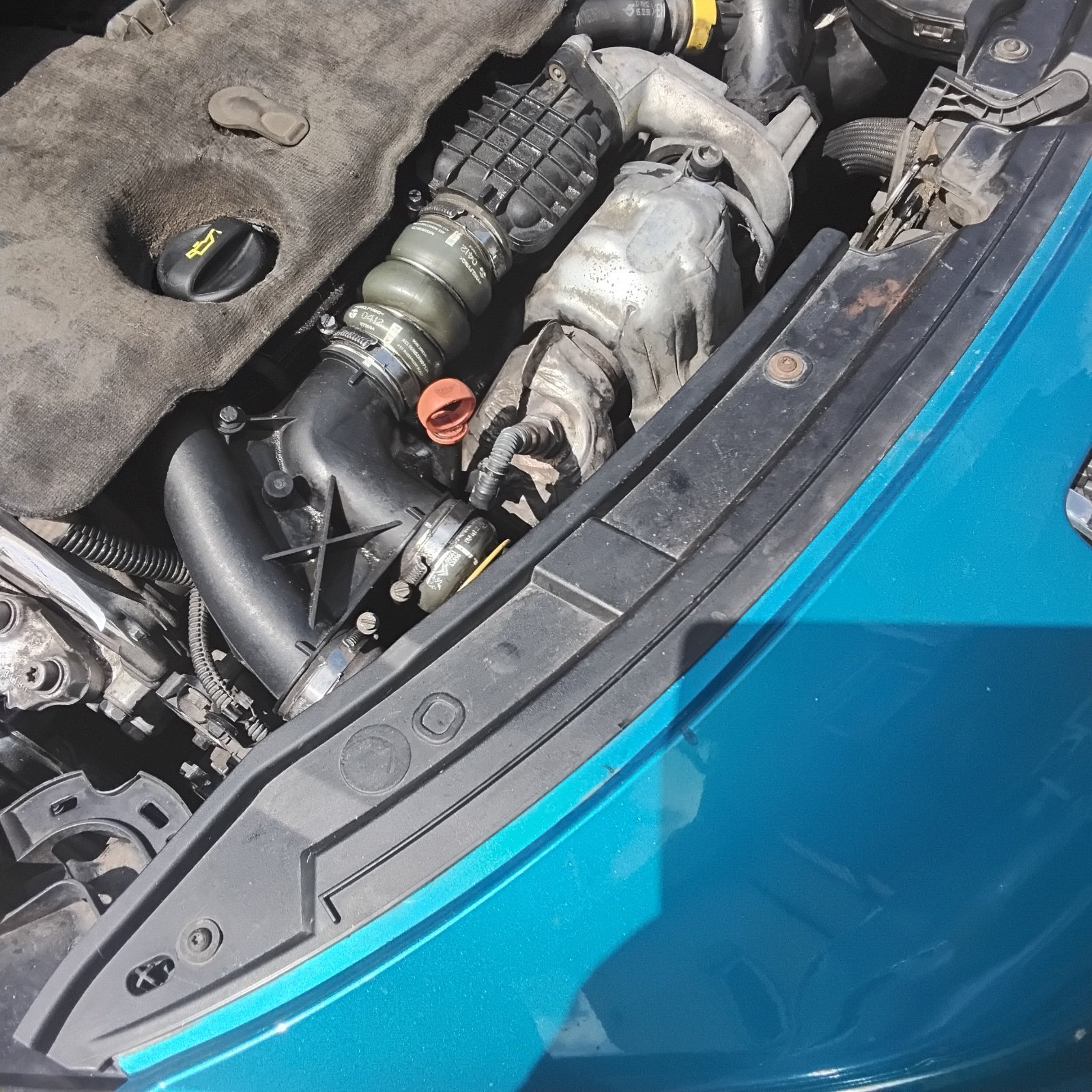

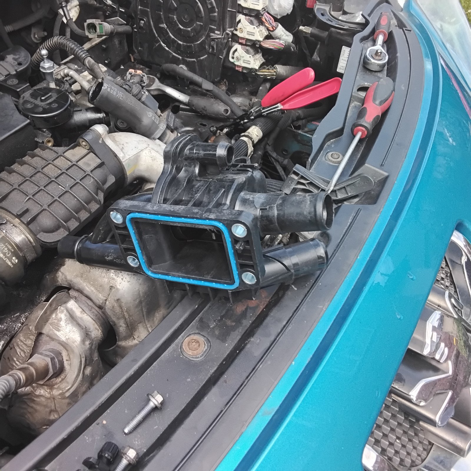

Took an hour , 2 rear hoses have weird clips that hold the pipe to there locations they look flimsy but they hold ! Here's some random photos

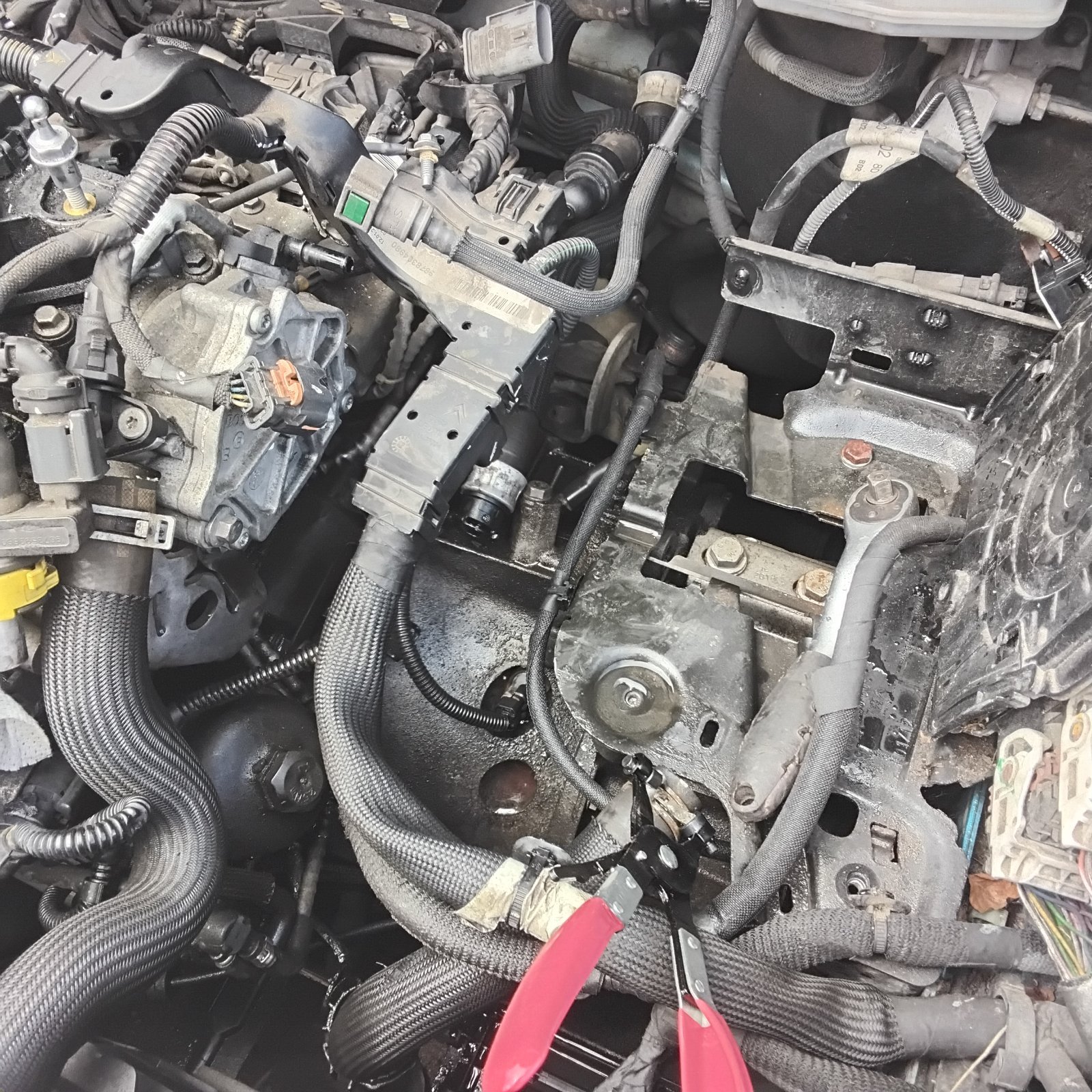

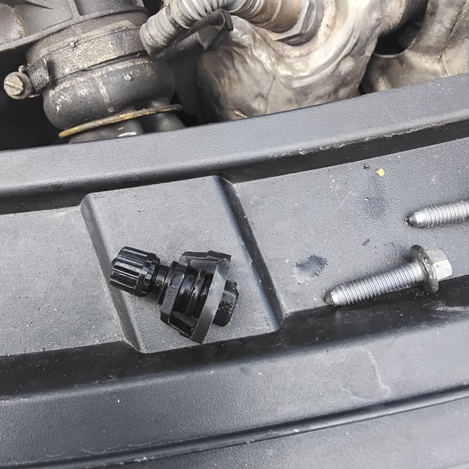

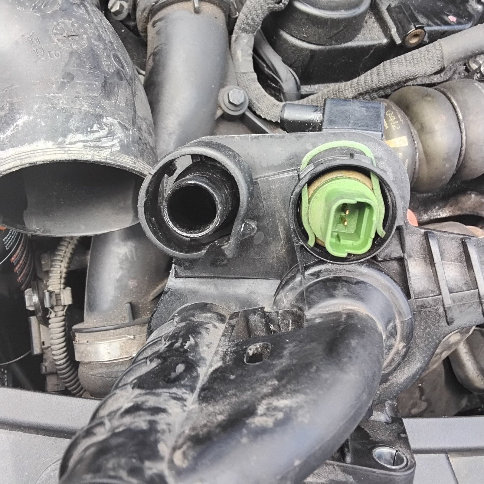

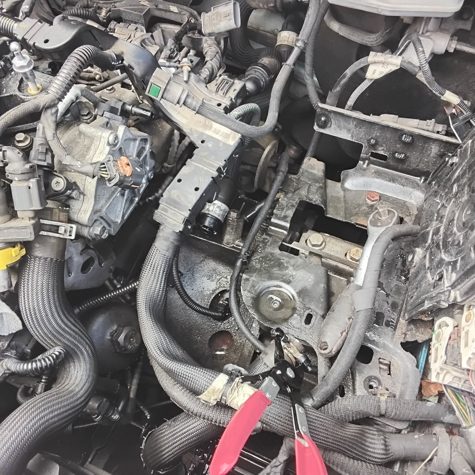

Had to take the bleed valve out the old unit , as you can see, the photo of everything that needs to be moved ! Boy what a mare , then a photo of it all back together and at last a working gauge , im in the car now letting it run up it's been purged of air but we all know sometimes these don't always let go of the air , the picasso was a nightmare for bleeding

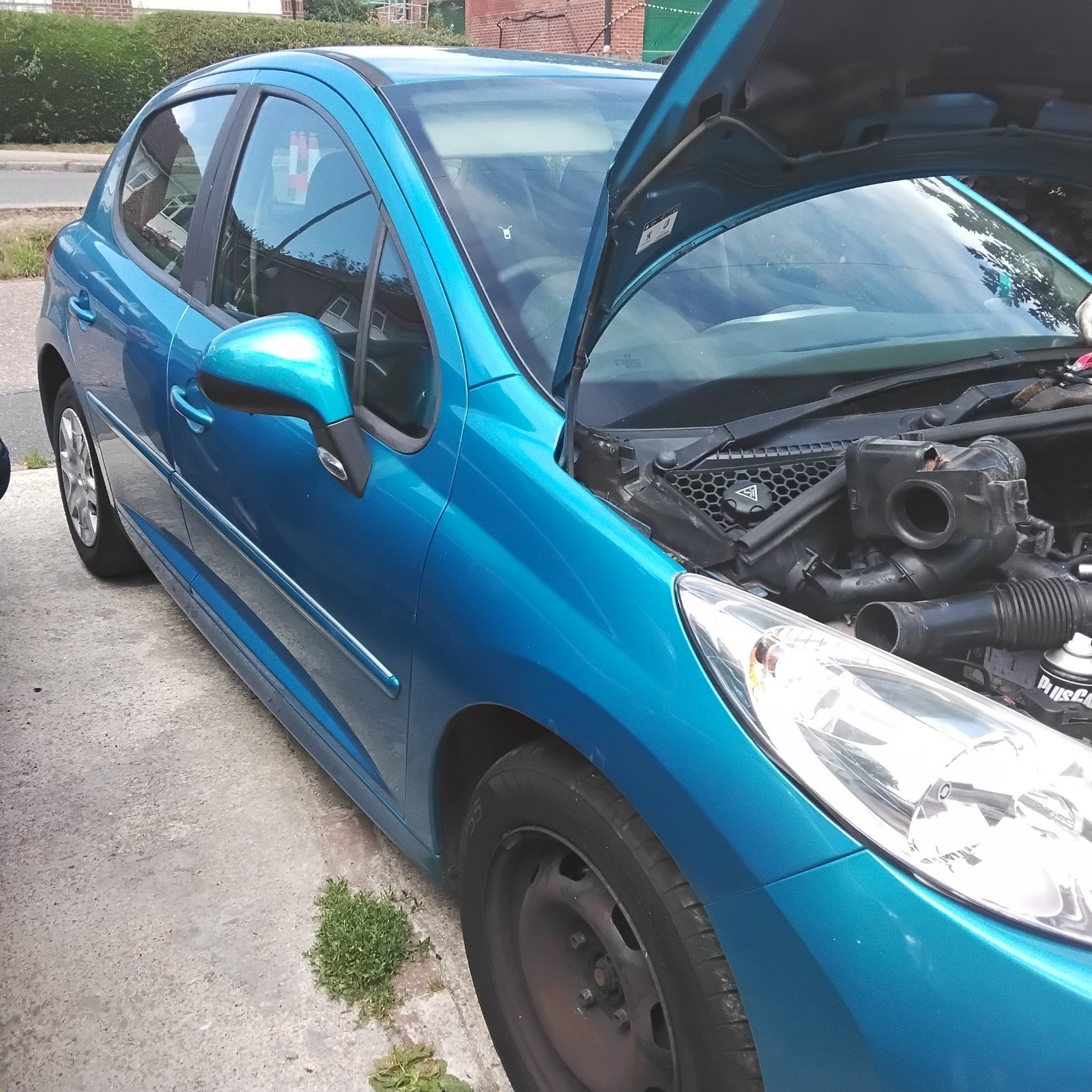

Photo with out trim , it's back on now I painted it
