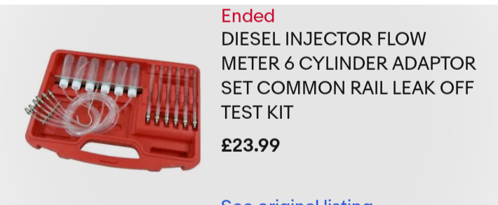

P.s. I have been shopping :)
Buy-it-now, should be here by the weekend
Wondering about buying both a crank and camshaft sensor just in case. Only about £15-£20 each from Autodoc
