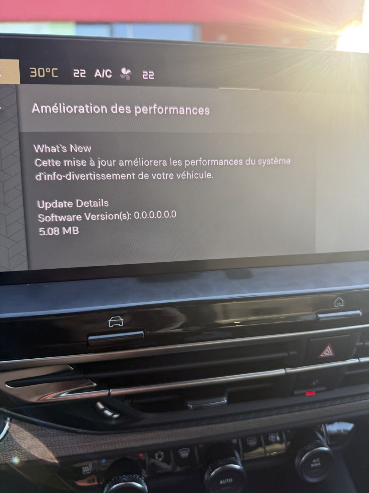

Updates have been arriving since this week.
However, it's strange, I'm on the fourth update (the first lasted 1 minute, the second 9 minutes, the third 15 minutes, and the fourth 2 minutes), but the system version remains the same, i.e., NHW.1.19.43.8??!!

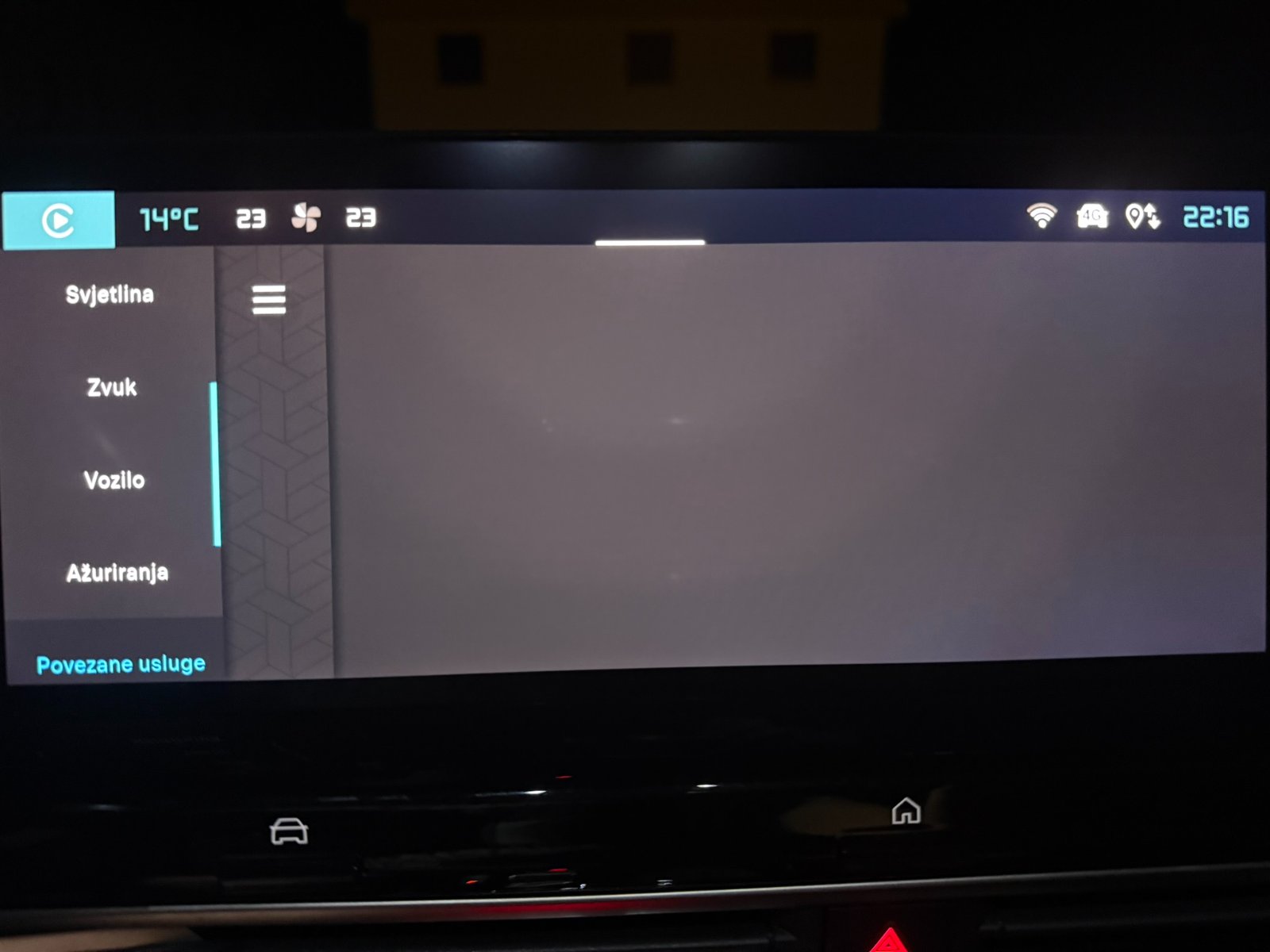

Re: C5x Firmware version
Btw. Is your connected services screen (the bottom menu item) empty like mine?

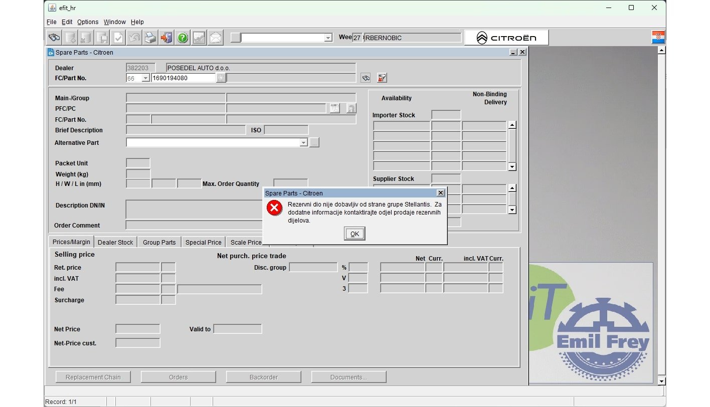

Update:
There’s still no progress.
As far as Citroën is concerned, it’s as if nothing was ever officially reported. The service center wasn’t able to place the order because the part is no longer being produced (see attached screenshot).
The importer seems completely clueless about what they’re doing. I’ve been chasing them regularly, but so far there’s no movement, and no one appears to know what the next step should be.

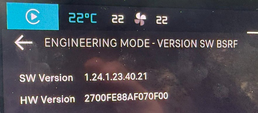

Update – BSRF Module Replaced & Services Reactivated
Today, the faulty BSRF module was successfully replaced. The new BSRF software version is now visible in diagnostic mode, confirming that the hardware and software replacement went through correctly.
During the replacement process, I also received several email notifications from Citroën Connected Services indicating that some services—which had been stuck in pending status for weeks—are now finally active.
Next step: waiting for firmware updates to become visible and available.

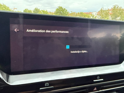

Charles1
- Posts: 26
- Joined: 30 May 2024, 14:01
- x 4

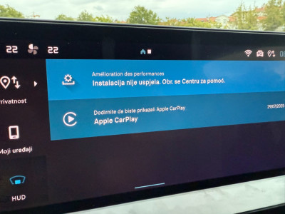

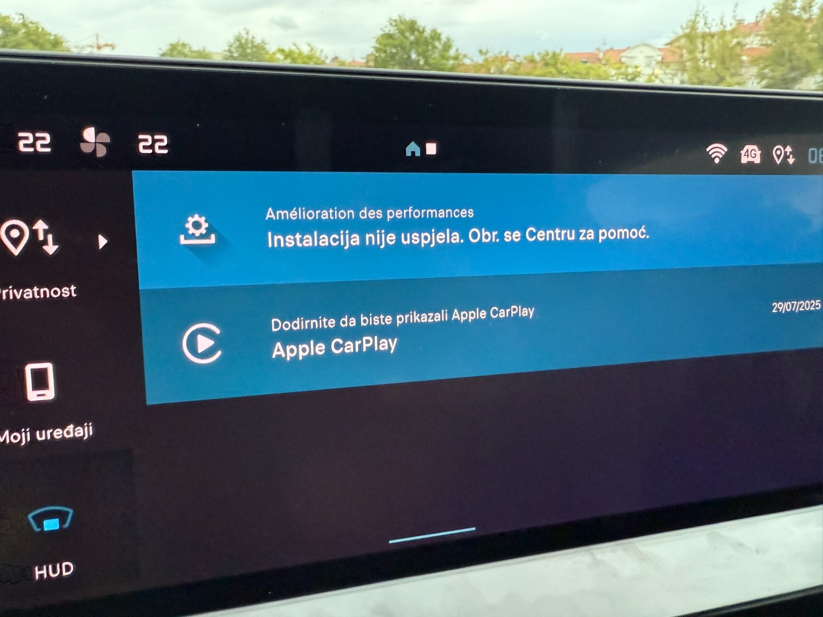

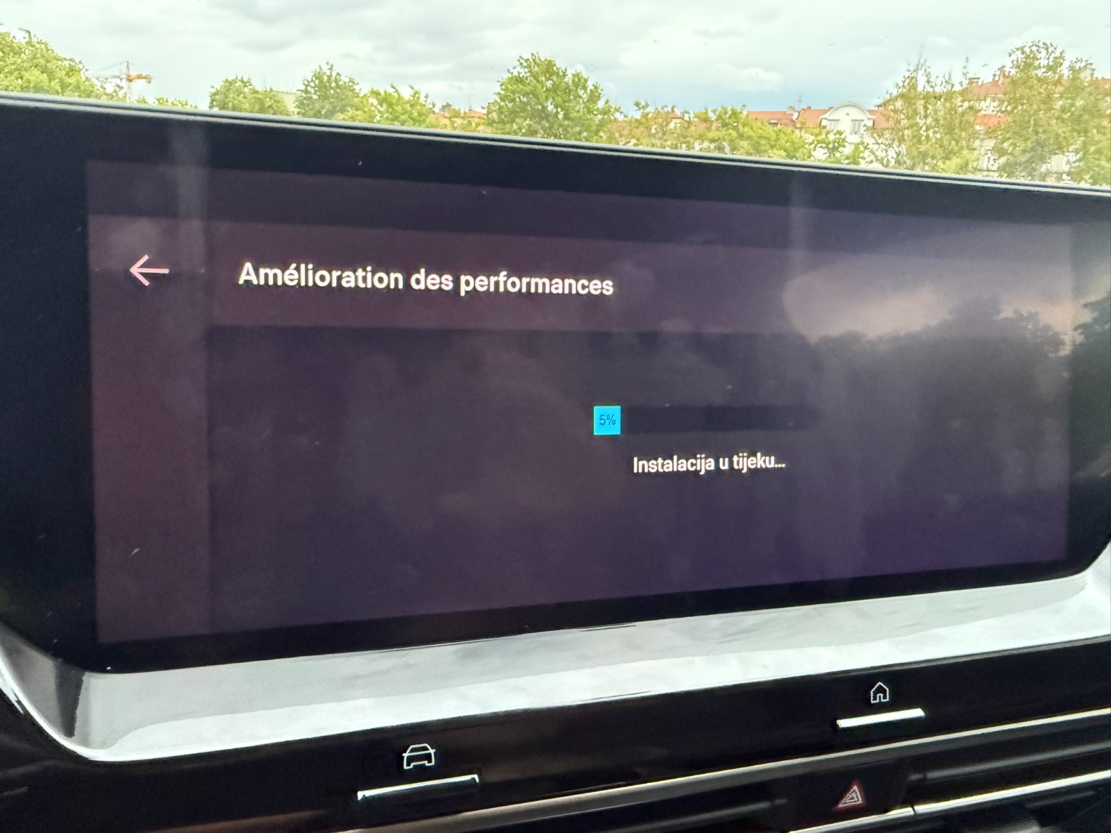

Today I finally received a notification about a performance update. Obviously, the new BSRF is having an effect, and the connection is successful now. Unfortunately, the update reached 5% and then failed. The update notification appeared again after a few drives, but it still failed at 5%. Has anyone else experienced the same issue?
Sloppysod
- Posts: 1535
- Joined: 23 May 2015, 23:35
- x 397
Hi, i am pleased for you that you finally got this issues resolved and a new BSRF module fitted.Charles1 wrote: 29 Jul 2025, 18:27 Today I finally received a notification about a performance update. Obviously, the new BSRF is having an effect, and the connection is successful now. Unfortunately, the update reached 5% and then failed. The update notification appeared again after a few drives, but it still failed at 5%. Has anyone else experienced the same issue?
As for the updates, is your auxiliary battery fully charged, ie have you been on a few Hybrid only journeys recently, more that 20 miles with empty traction battery, or I have heard that some people have complained that they had to have the engine running during the update process, basically these two points mean the same , low auxiliary battery.
Good luck, please let's us know if you got it to work.
Stu

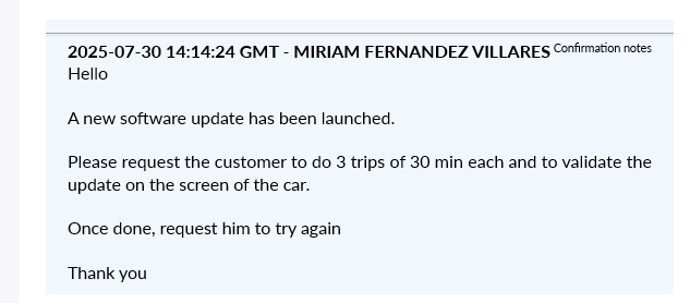

Charles1
- Posts: 26
- x 4

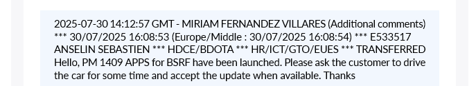

After the failed update, I contacted the after-sales support at the importer. They advised me to fill out the contact form in the MyCitroën app, and after submitting it, I was asked to send them (after-sales team) additional details and screenshots of the issue so they could open a ticket with the manufacturer.Sloppysod wrote: 30 Jul 2025, 17:44 Hi, i am pleased for you that you finally got this issues resolved and a new BSRF module fitted.
They got back to me the same day with a response from the manufacturer, and this time the update was successfully completed.
I’m now expecting additional updates in the coming days, including a possible change in the IVI system version.

The "3 trips of 30 min" is interesting battery recharge between updates
Well glad you sorted it.
