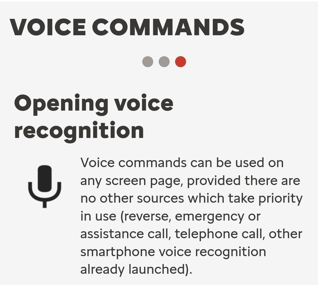

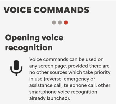

GiveMeABreak wrote: 18 Nov 2024, 12:23 That will be in the main options screen, see here:
Patryk, these instruction video come in various languages. There's a lot on YouTube.
In reference to my earlier comment, this is from the instruction manual of the app.

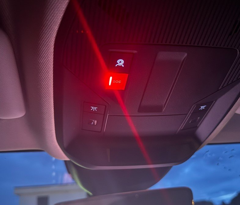

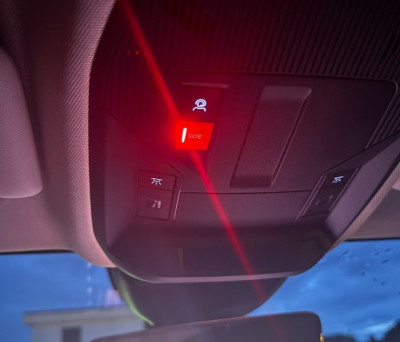

@patryk - is your SOS light always red while driving? (attached) If so, it seems the BSFR module needs replacement.

Charles1
Posts: 26
Joined: 30 May 2024, 14:01
x 4
Re: C5x Firmware version
Unread post by Charles1 »
They’re not being truthful. While it's technically correct that the update will occur once it's available, the BSFR module (with the antenna) must be functioning properly to connect to the server and detect the update. If the SOS button has a red light that stays on continuously, the update will not take place. I have a service appointment scheduled for Friday.
Charles1
Posts: 26
x 4
I went to the dealer service this morning. They said it's the SOS module backup battery, and they've ordered a replacement. I doubt that will solve the problem, but it might. If not, I'll direct them toward replacing the BSFR module, although they haven't seen any errors related to it.
