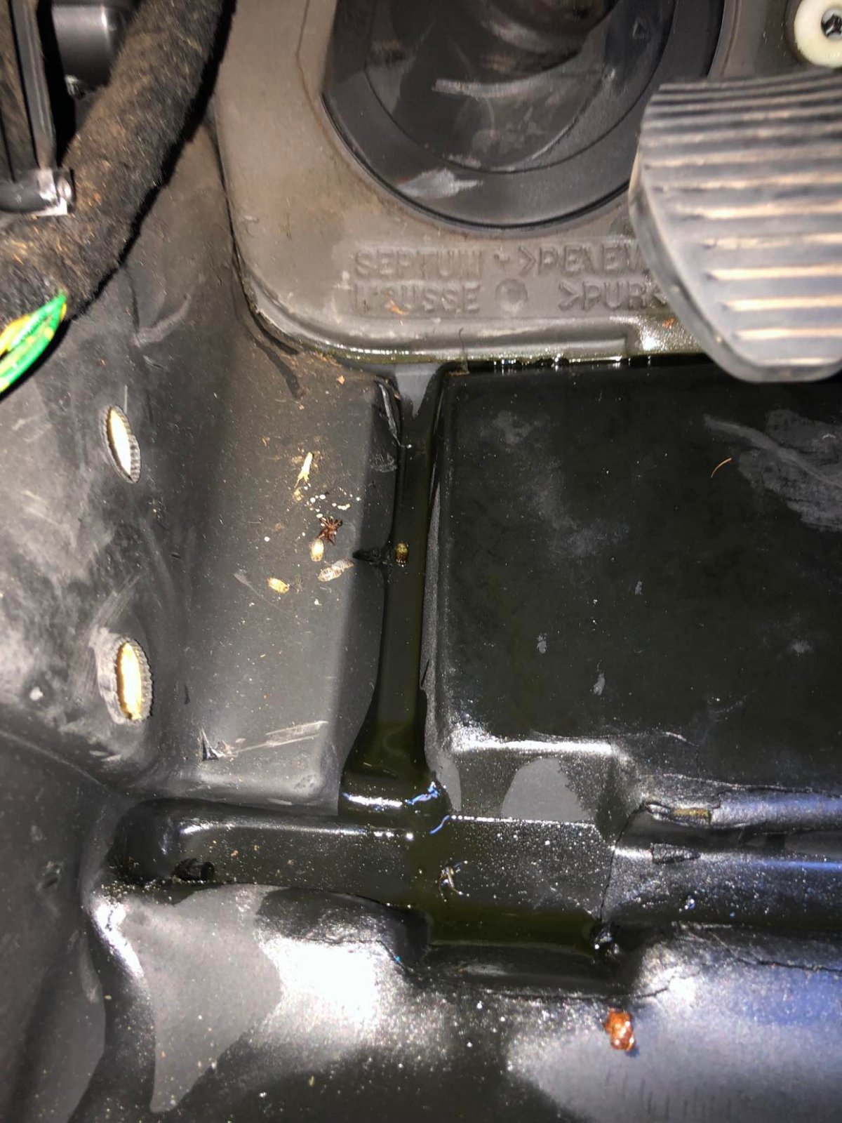

Sorry to hear about the ribs Skull, having compound broken seven all in one go several years ago I feel your pain
Here's hoping you soon heal

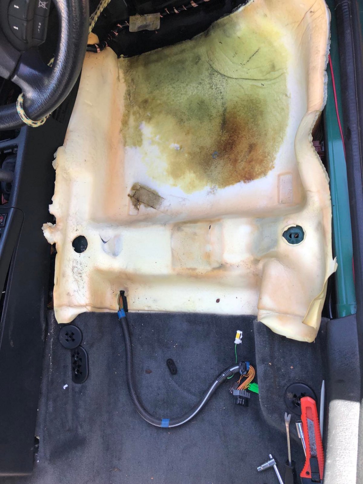

The sound deadening mush will need to be scraped away, cleaned up with solvent and a new bit glued in... It's a horrid, dirty job...
Gosh yes, it can melt all the sound-deadening panel stuck to the footwell under the carpet backing foam. The carpet and foam itself survives well and can be washed out with good, strong detergent and dried but you'll find the carpet will retain a fetching green tinge for the rest of time! As your car is green anyway, that will not be a problem!RichardW wrote: 11 Oct 2023, 17:12 I recall Jim saying that the carpet can soak up an amazing amount of LHM, but it turns the underneath to mush.

Cheers Jim No No I feel your pain todayCitroJim wrote: 12 Oct 2023, 05:43 Sorry to hear about the ribs Skull, having compound broken seven all in one go several years ago I feel your pain
Here's hoping you soon heal![]()
Can you remember if this foam/rubber mat under the pedals is bonded in at the top

Excellent work Skull
Just clean it up as best you can with lots of absorbent paper and some solvent you know won't attack it...
That one is almost impossible to remove, that (and the heater matrix) were the first bits of the car to be assembled and the rest was built around it...Skull wrote: 12 Oct 2023, 17:18
Can you remember if this foam/rubber mat under the pedals is bonded in at the topFeeling weak ....

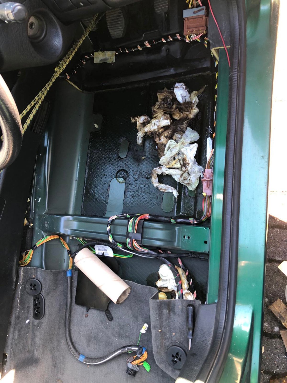

All sorted @ 161,060 miles she's back on the road after a short rest
Not the easiest job to do, I'm going to do a full thread on the job for reference ......
