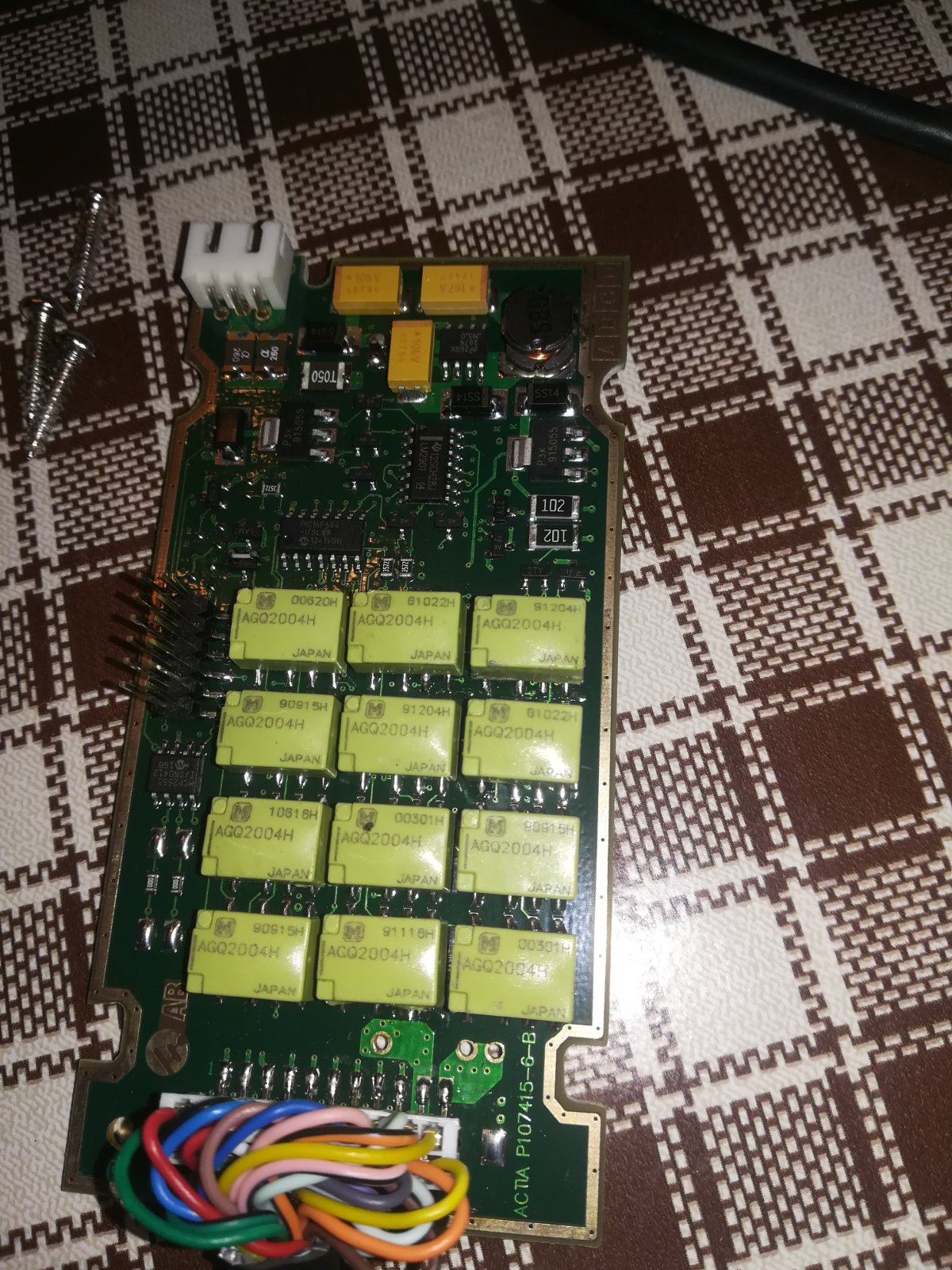

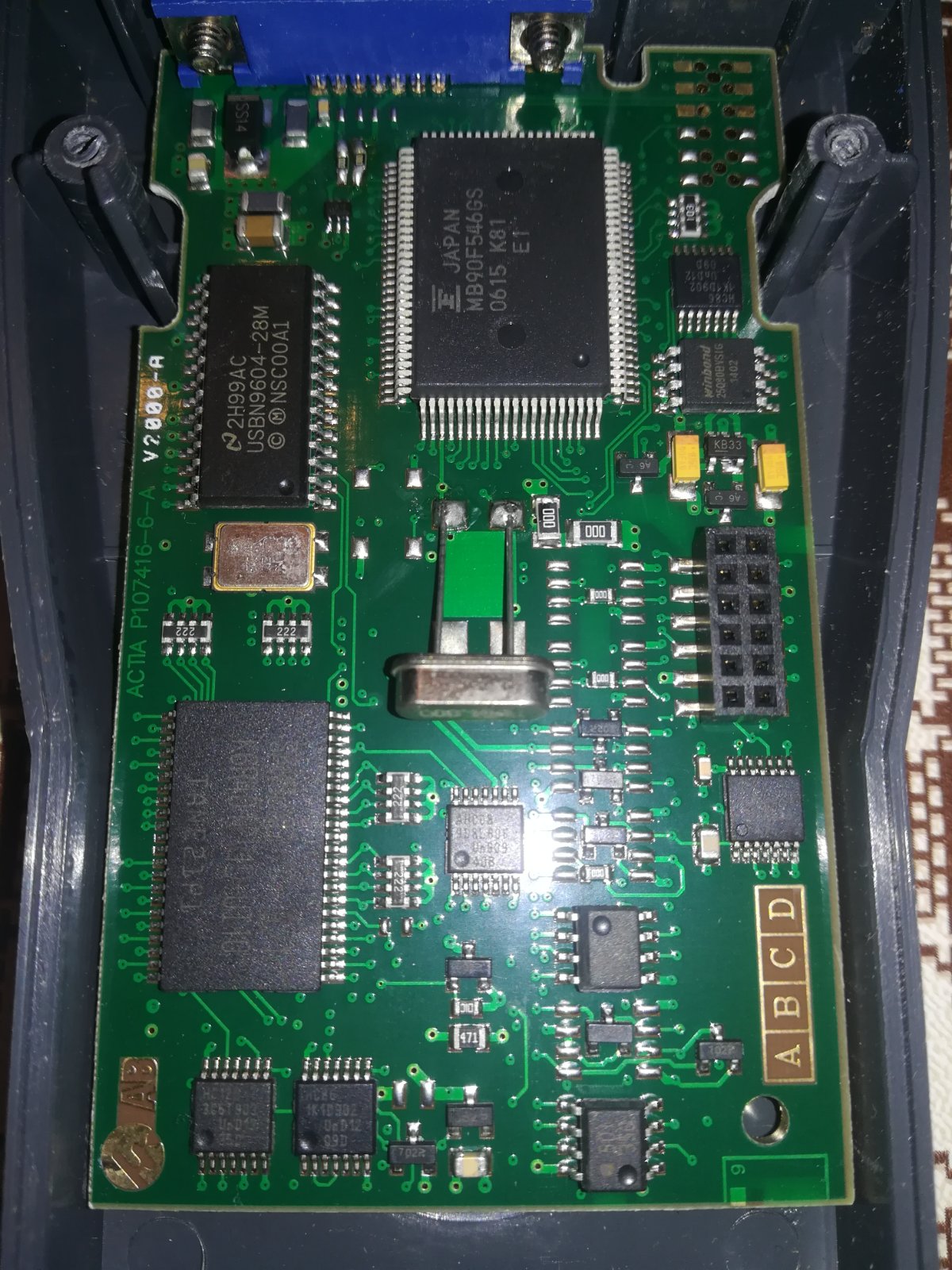

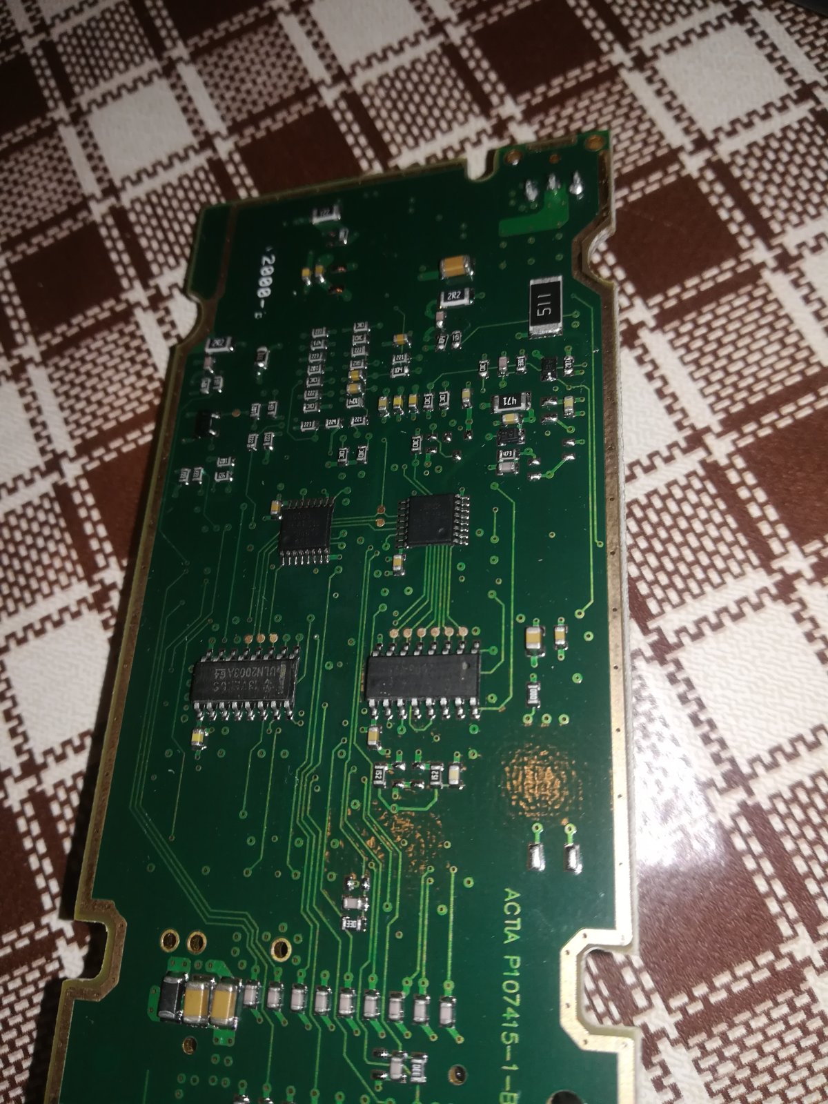

Hi all my VCI exposed it seems to be missing one chip
Darren
