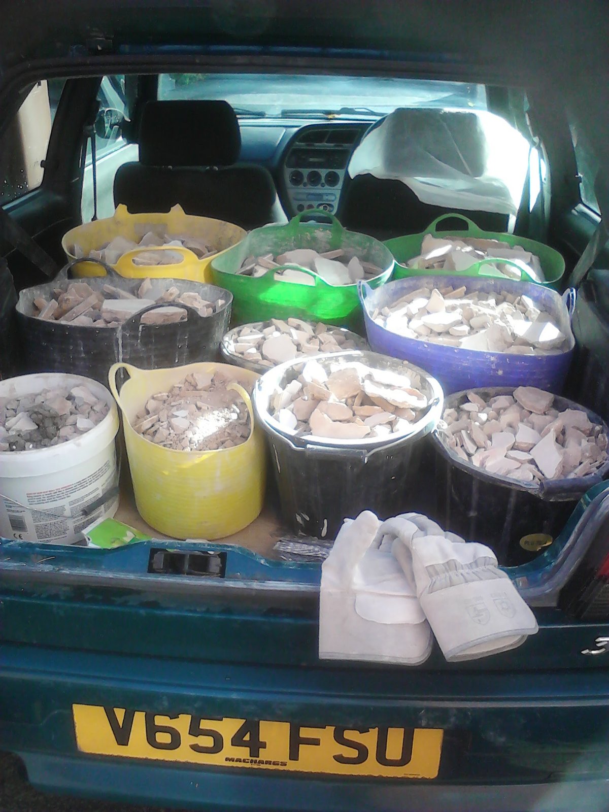

Rp0thejester wrote: 24 Jun 2022, 18:44. Any tips on dump runs as the inside of my C8 is suffering...
Top tip for keeping tip runs / mucky stuff out the car: Matt
P.s. meant the trailer, not the small boy obviously!
- Posts: 21239
- x 8128
Re: DIY Car Maintenance with function over finesse!!
A word of warning - Check out the fees at your local recycling centre before you take a trailer. Our site charges for trailers but not as much as vans!!MattBLancs wrote: 25 Sep 2022, 17:31Rp0thejester wrote: 24 Jun 2022, 18:44. Any tips on dump runs as the inside of my C8 is suffering...
Matt

My top tip for keeping mucky stuff out of your car on tip runs is to use someone else's car
- Posts: 5337
- Joined: 25 Apr 2022, 09:03
- x 2355
Unlikely they'd lend it me more than once if I did this kind of tip run with it (pre trailer days)

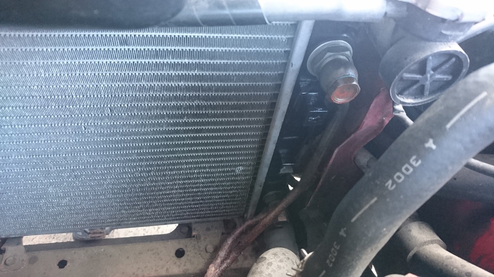

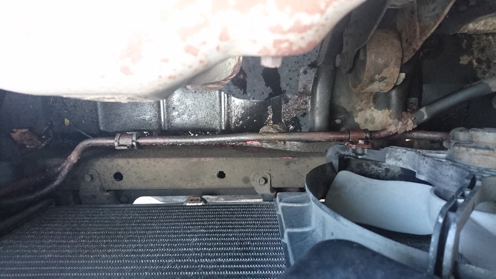

With the MOT due next week I decided it was time to get to grips with the MX3's ATF leaks. So I put the car up on the ramps, which with my drive gives me a fairly level car that I can get under to work on:
Once I got to look inside my suspicions were confirmed, the two pipes from the radiator for the gearbox cooling are corroded and weeping at various points:

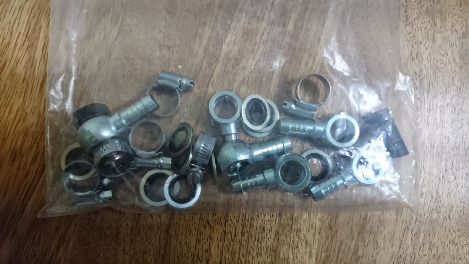

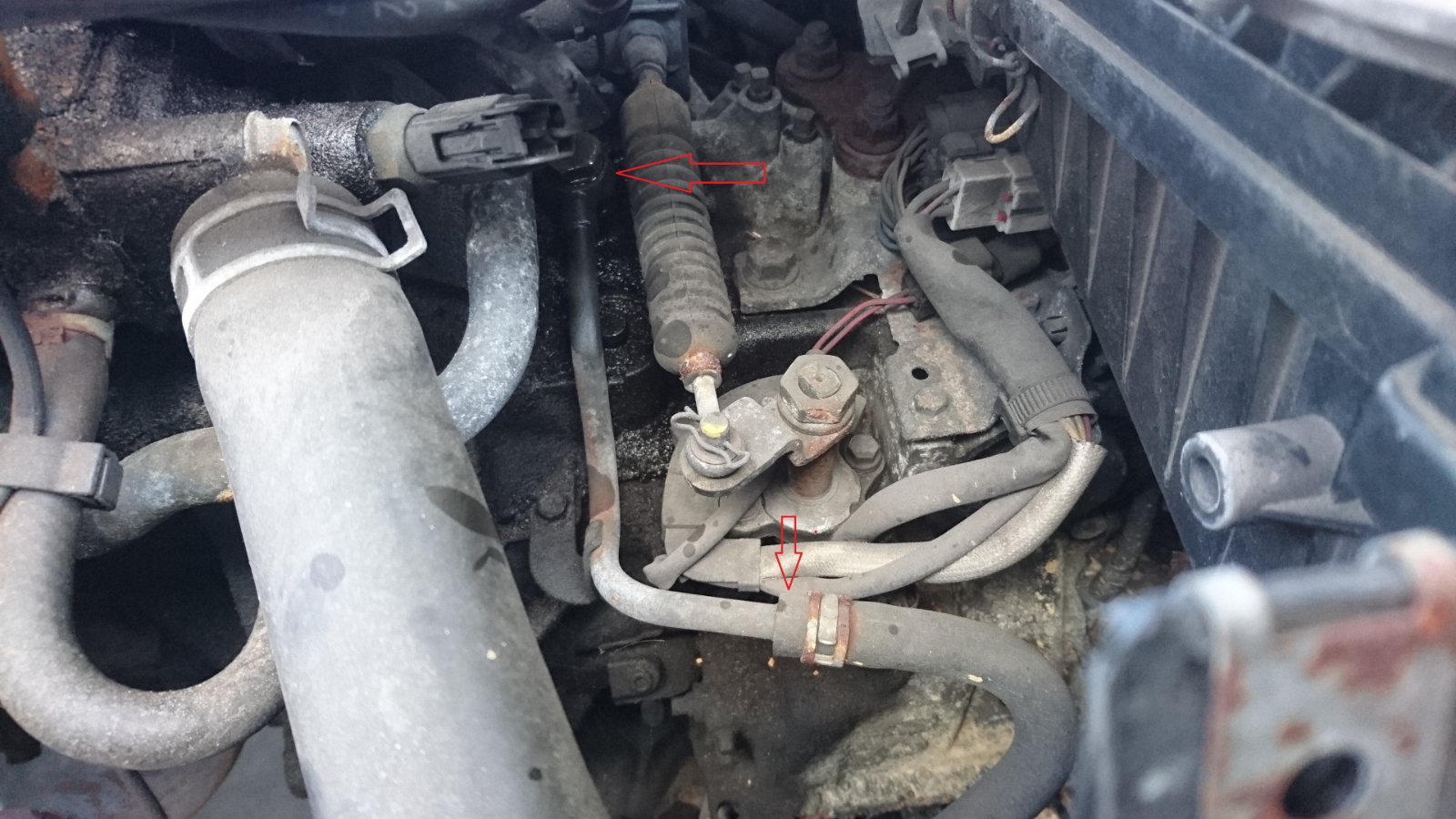

I have already been searching for replacement pipes with no luck although I am still awaiting a return call from the main dealer parts man! Given that it is unlikely I can source them economically I think I will look into replacing them with suitable hose which will mean me sourcing the correct size banjo to hose fittings to replace the existing banjo to pipe fittings:
I am going to unbolt the driver's side upper banjo joint this morning to measure it so I can source direct banjo to hose terminations to allow me to correctly fit the replacement hose. I'll fabricate mountings as needed once they are in place but for today I just need the sizes so I can order the new banjo to hose fittings.

Might "photograph well" but the existing pipe doesn't look too bad close to the radiator connection, could you cut the pipe and save finding a new banjo connection? If can solder / weld / epoxy / etc a bit of a lump on the pipe exterior, should help stop a rubber tube (and jubilee) from popping off.
- Posts: 21239
- x 8128

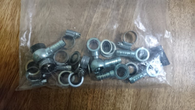

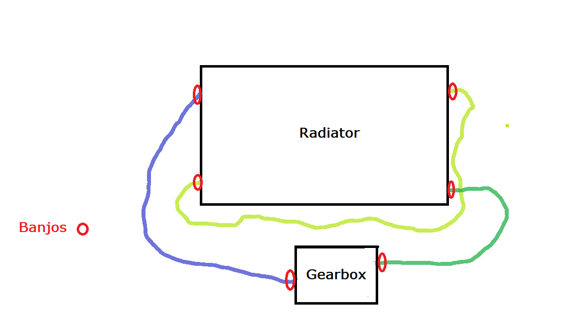

I had thought of that Matt but I wasn't confident of getting a decent ridge for the clip to rest against. I tried flaring an old bit of pipe I had and it wasn't very successful so I opted for doing the job properly. I found a place down in South Woodham Ferrers who specialise in hydraulics and all things related so I have just got home with 6 correct banjo unions, 12 washers and six clips which together with the 50ft of pipe I have already bought have come to a total parts cost of £60 so I'm happy with that and I will replace the entire hoses with single ones for each of the three runs as per this quick sketch:

Incidentally I forgot to mention that my Mazda dealer got back to me today and advised me that the pipes are still available although need to be ordered from Japan and likely to take 6-10 weeks for delivery. Add that to the mere £245.45 + VAT and my hose based solution is a no brainer as the MOT is due by the 22nd!!
