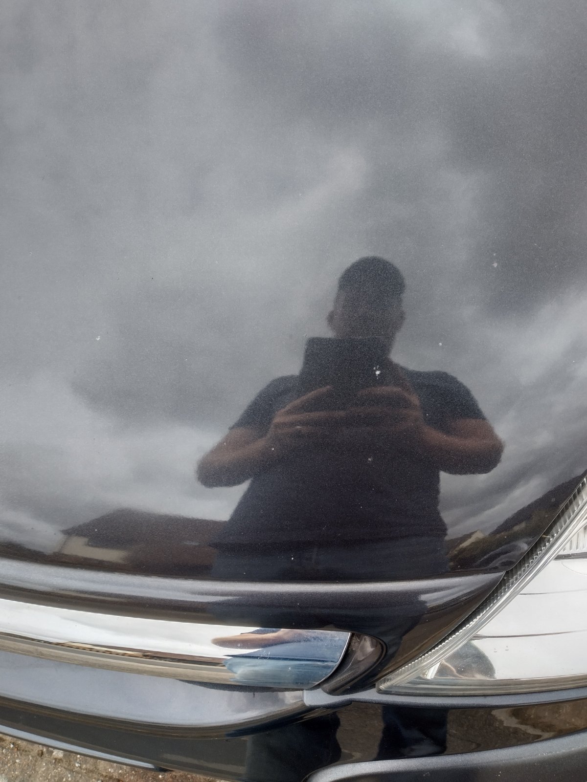

I finally washed the car today with my birthday present. She hadn't been washed in 3 months and was absolutely minging, covered in bird poo. . This stuff uses no water, so thought I'd give it a go with future threats of hose pipe bans likely. dirty micro fibres after cleaning. Here's the results. absolutely amazing product!! Just spray it on over the dirt rub it in, then polish with a different cloth and leaves no scratches and polishes at the same time!! I am not affiliated with the company etc it's just my opinion.
