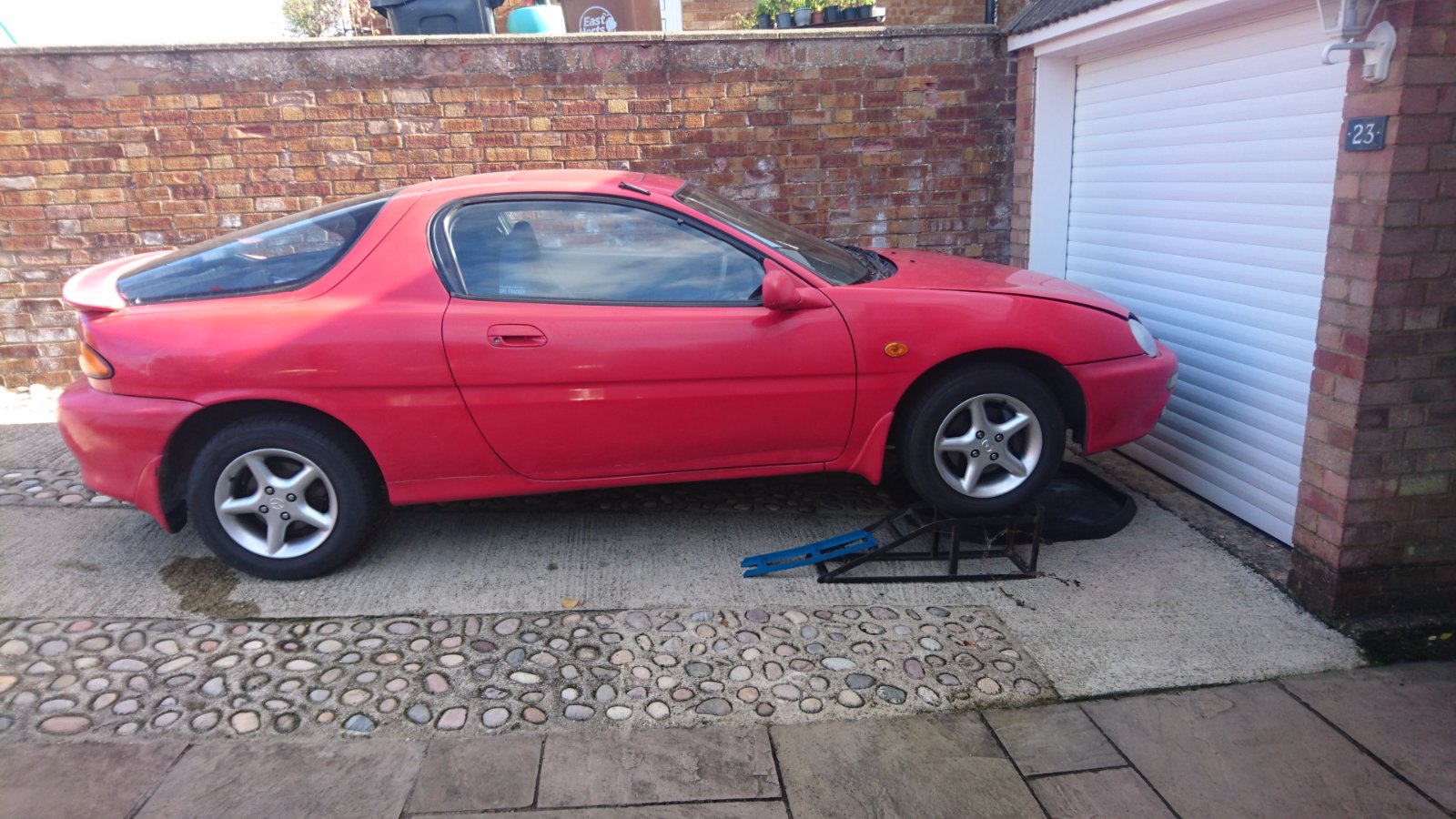

With the MOT due next week I decided it was time to get to grips with the MX3's ATF leaks. So I put the car up on the ramps, which with my drive gives me a fairly level car that I can get under to work on:

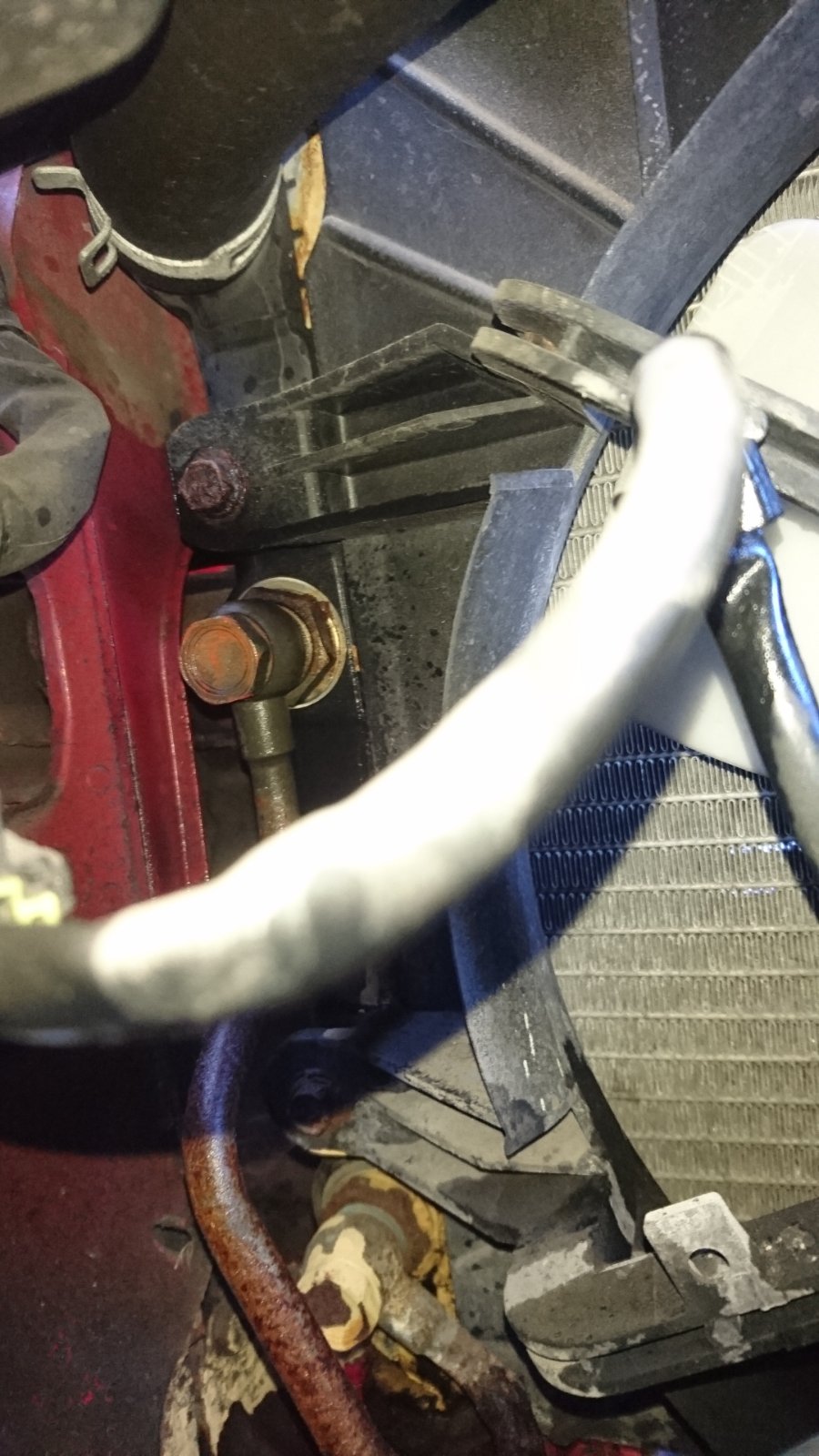

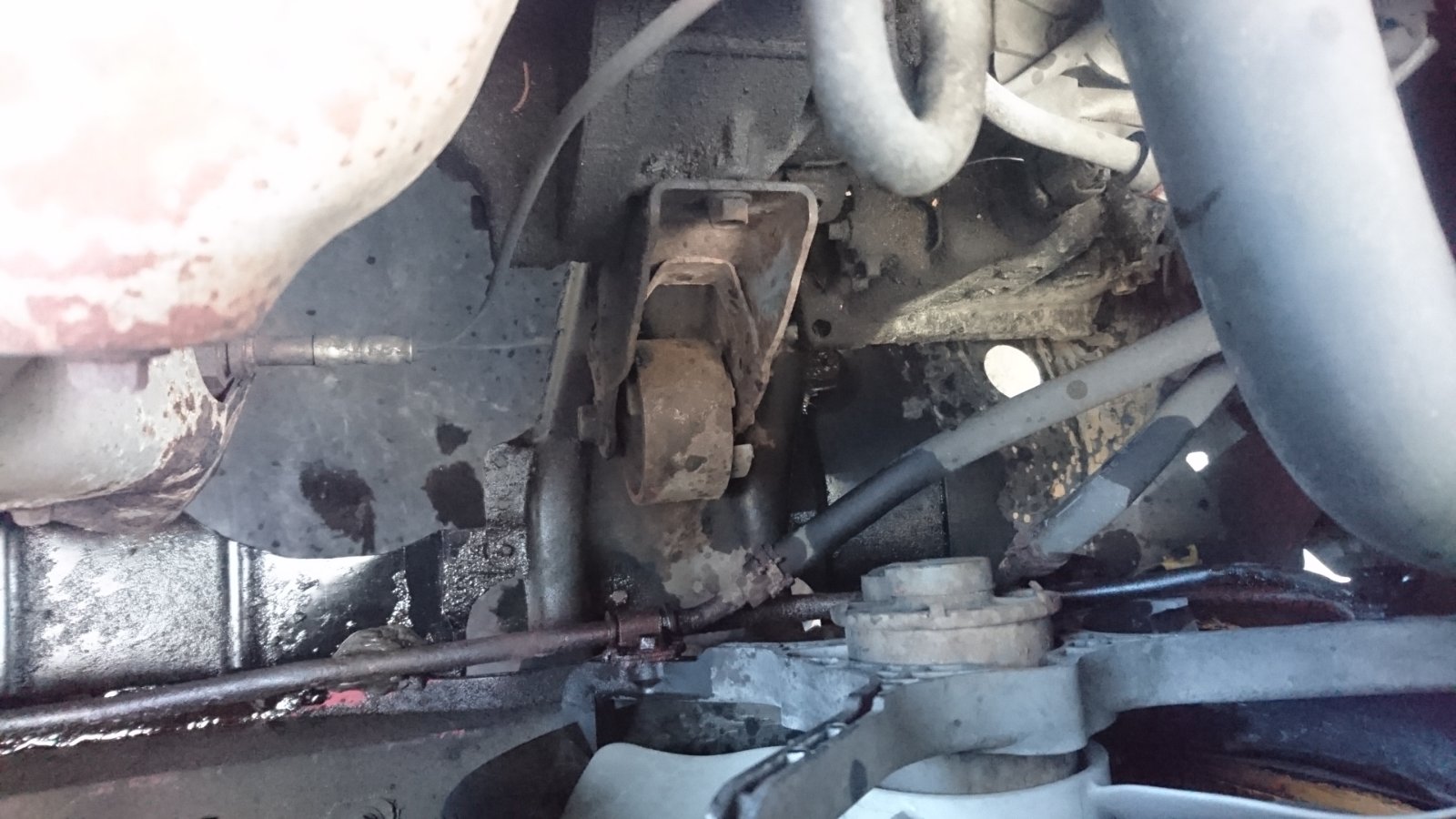

Once I got to look inside my suspicions were confirmed, the two pipes from the radiator for the gearbox cooling are corroded and weeping at various points:
I have already been searching for replacement pipes with no luck although I am still awaiting a return call from the main dealer parts man! Given that it is unlikely I can source them economically I think I will look into replacing them with suitable hose which will mean me sourcing the correct size banjo to hose fittings to replace the existing banjo to pipe fittings:

Further developments as it happens!!

Might "photograph well" but the existing pipe doesn't look too bad close to the radiator connection, could you cut the pipe and save finding a new banjo connection? If can solder / weld / epoxy / etc a bit of a lump on the pipe exterior, should help stop a rubber tube (and jubilee) from popping off.

I had thought of that Matt but I wasn't confident of getting a decent ridge for the clip to rest against. I tried flaring an old bit of pipe I had and it wasn't very successful so I opted for doing the job properly. I found a place down in South Woodham Ferrers who specialise in hydraulics and all things related so I have just got home with 6 correct banjo unions, 12 washers and six clips which together with the 50ft of pipe I have already bought have come to a total parts cost of £60 so I'm happy with that and I will replace the entire hoses with single ones for each of the three runs as per this quick sketch:
