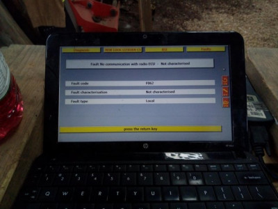

Re: RT4 insert upgrade CD
Another try but same result
.. cant communicate with Radio ECU (or multiscreen ECU) so can't stop the beeping.. any thoughts marc on the next possible strategy for Snoopy?

Right, it's taken me a while to re-read back on this thread to find out what the objective was
So the F062 error is a BSI communication error with the Radio. and can't as, we know, communicate with it.
So when you hook up the Lexia, go into the repair menu and look instead for the 'Multifunction Screen' option, as I think on these it is the screen ECU that does the controlling of the Head Unit.
Under the Multi-function screen, you should then see an option for RT3.
Select this and it will then attempt to communicate with the unit.
When it does, you should see a further list of options including configuring of the VIN.
So DON'T go into the AUTORADIO menu - stick to the MULTIFUNCTION SCREEN section.
I've found a video - that might help - this chap has a Fiat - which is the same as the 807 and C8 - and had the same RT3 telematics systems fitted, so ignore this fact. He is using Peugeot Planet 2000 (the Peugeot equivalent of Lexia. You just use Lexia when you get the choice of SCANTOOL or LEXIA.
Although the menus are in French, if you watch carefully, it may help you work out the correct options that should be similar on the Lexia and later, how to code the VIN in.

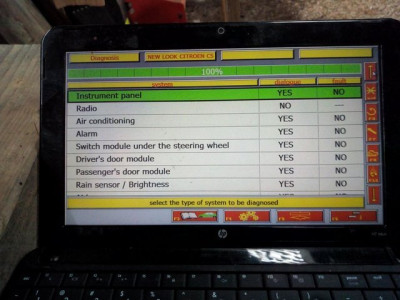

still no luck everyone
the top menu has :
Diagnosis
Downloading
Replacement parts
PDI
Personalised Maintenance
Battery charge status
there is no repair menu.
However, in diagnosis it shows what the pics in my previous post shows.
We cant communicate with:
Radio
MF screen
Hands free phone
so we cant seem to do anything further without accessing those menus (in particular the MF screen)
Is the BSI blocking access at this point? has it got a fault that is not allowing comms with any/all of those 3 items above?
