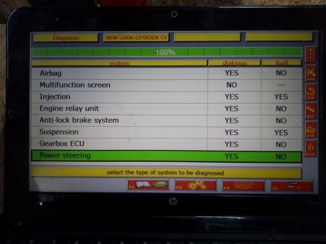

Another try but same result
.. cant communicate with Radio ECU (or multiscreen ECU) so can't stop the beeping.. any thoughts marc on the next possible strategy for Snoopy?

However, in diagnosis it shows what the pics in my previous post shows.
We cant communicate with:
Radio
MF screen
Hands free phone
so we cant seem to do anything further without accessing those menus (in particular the MF screen)
Is the BSI blocking access at this point? has it got a fault that is not allowing comms with any/all of those 3 items above?
Looking back at the pics of the diagnosis menu from last week, one thing I have noticed.. the 'hands free telephone' option is now at the bottom of the list after 'power steering' (with no comms)
