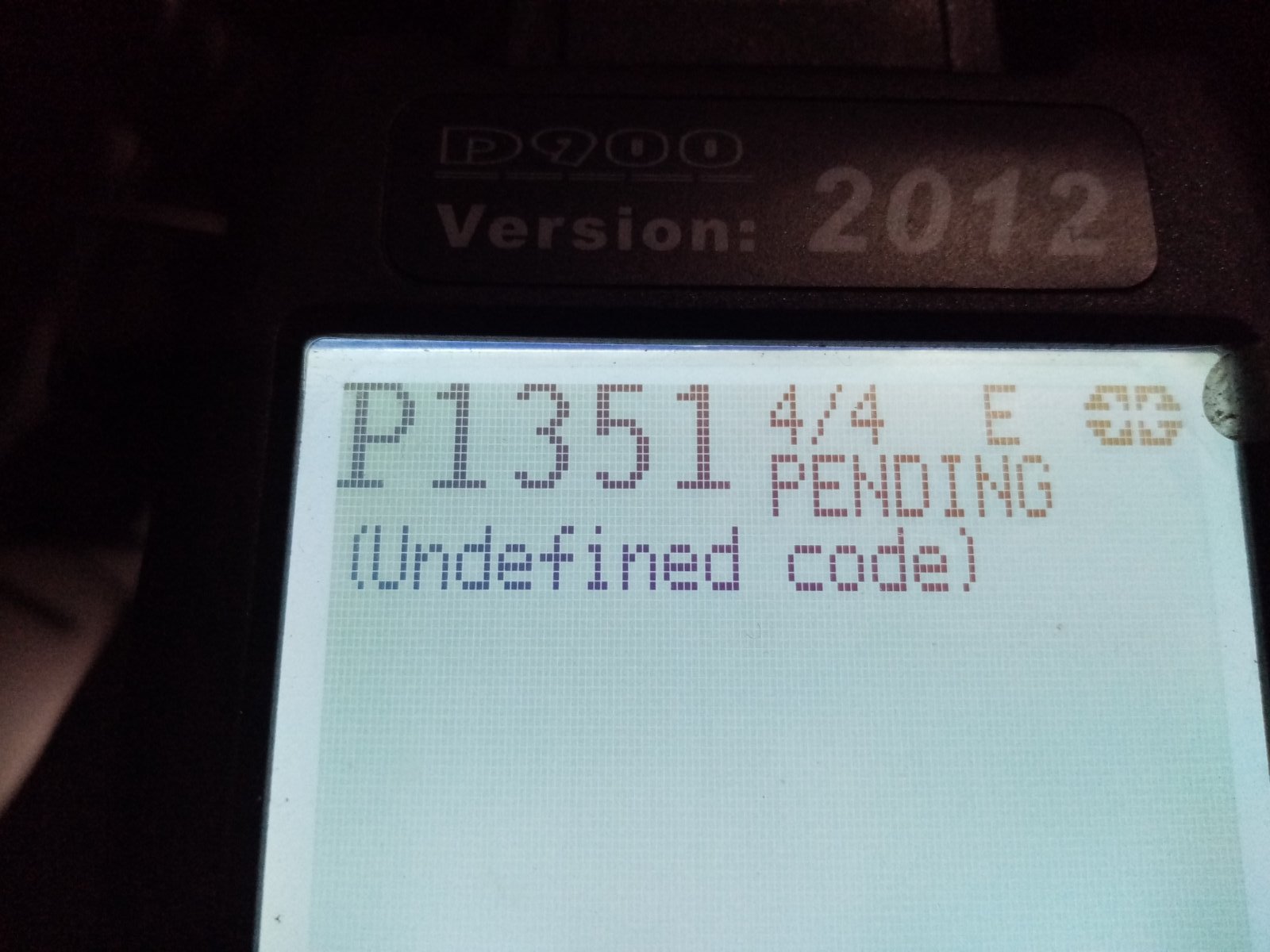

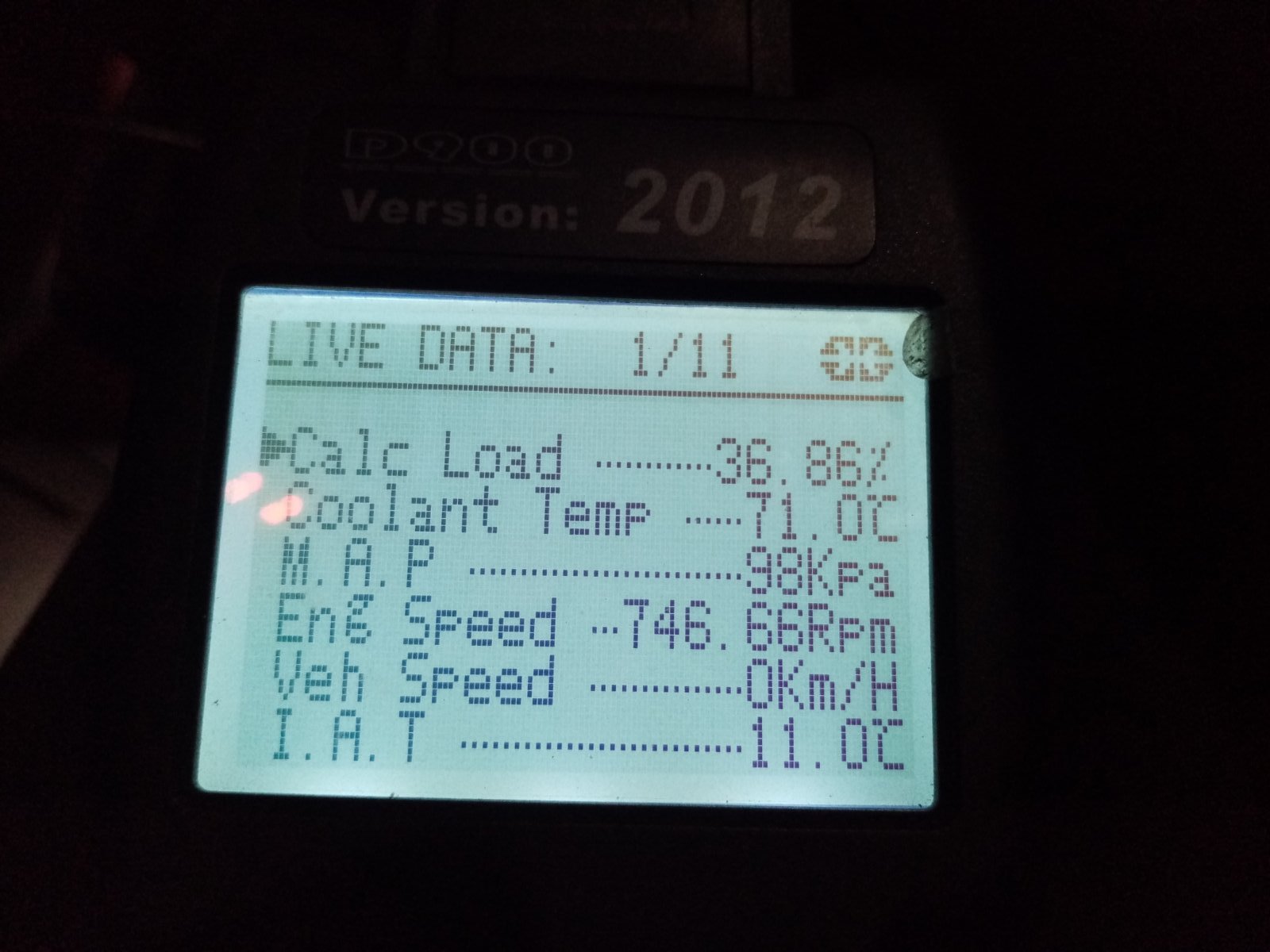

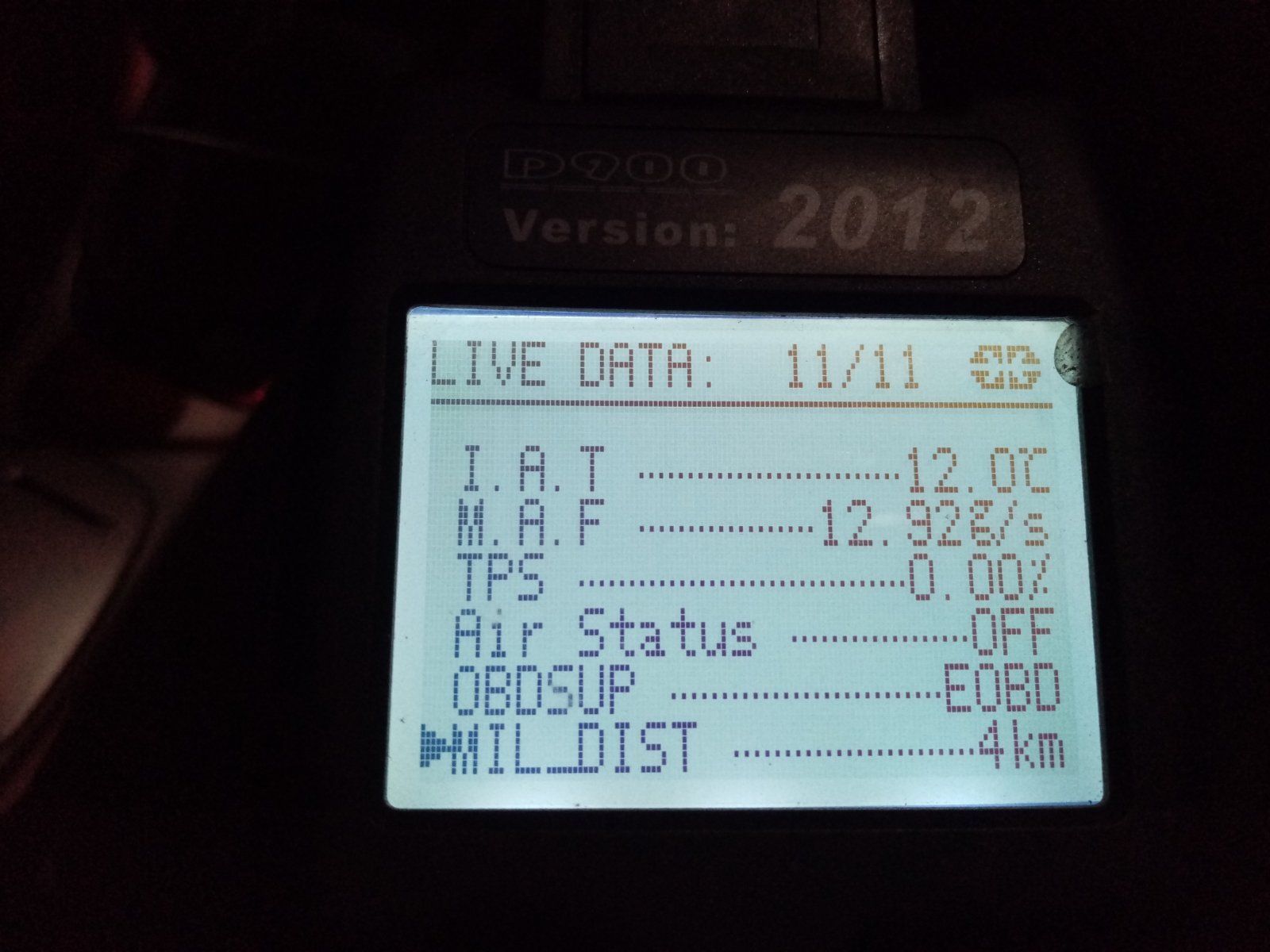

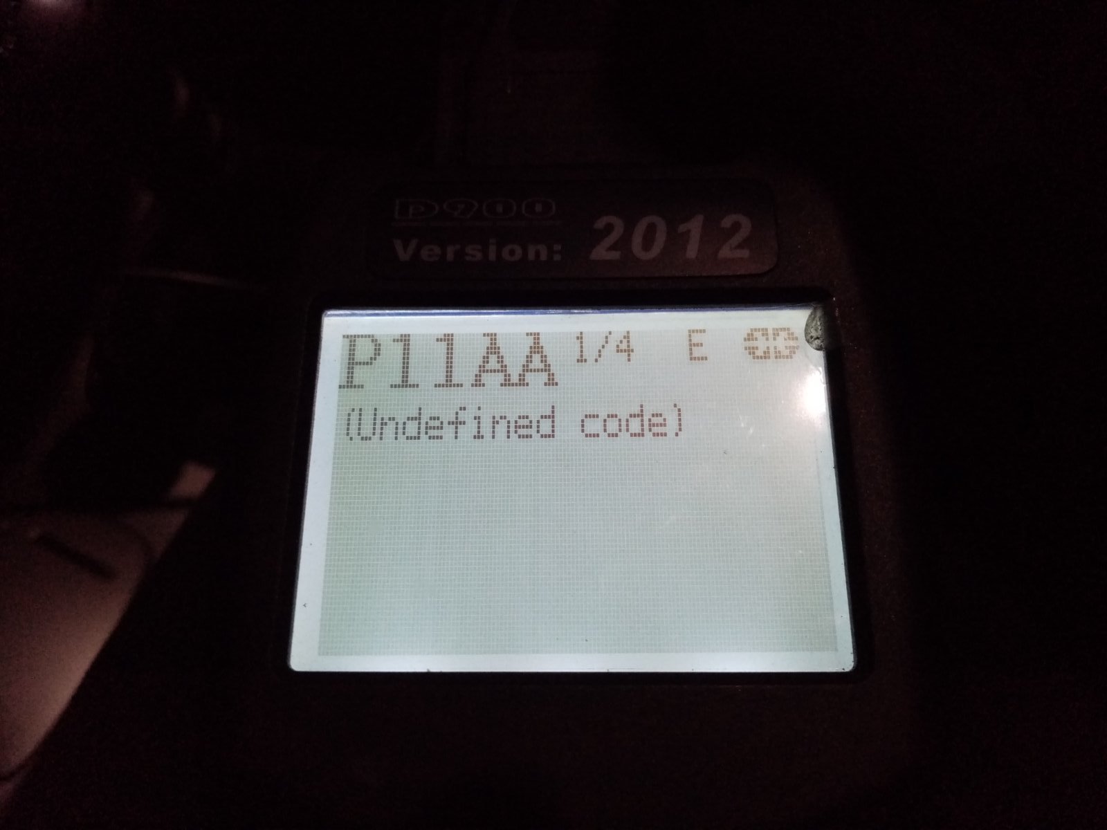

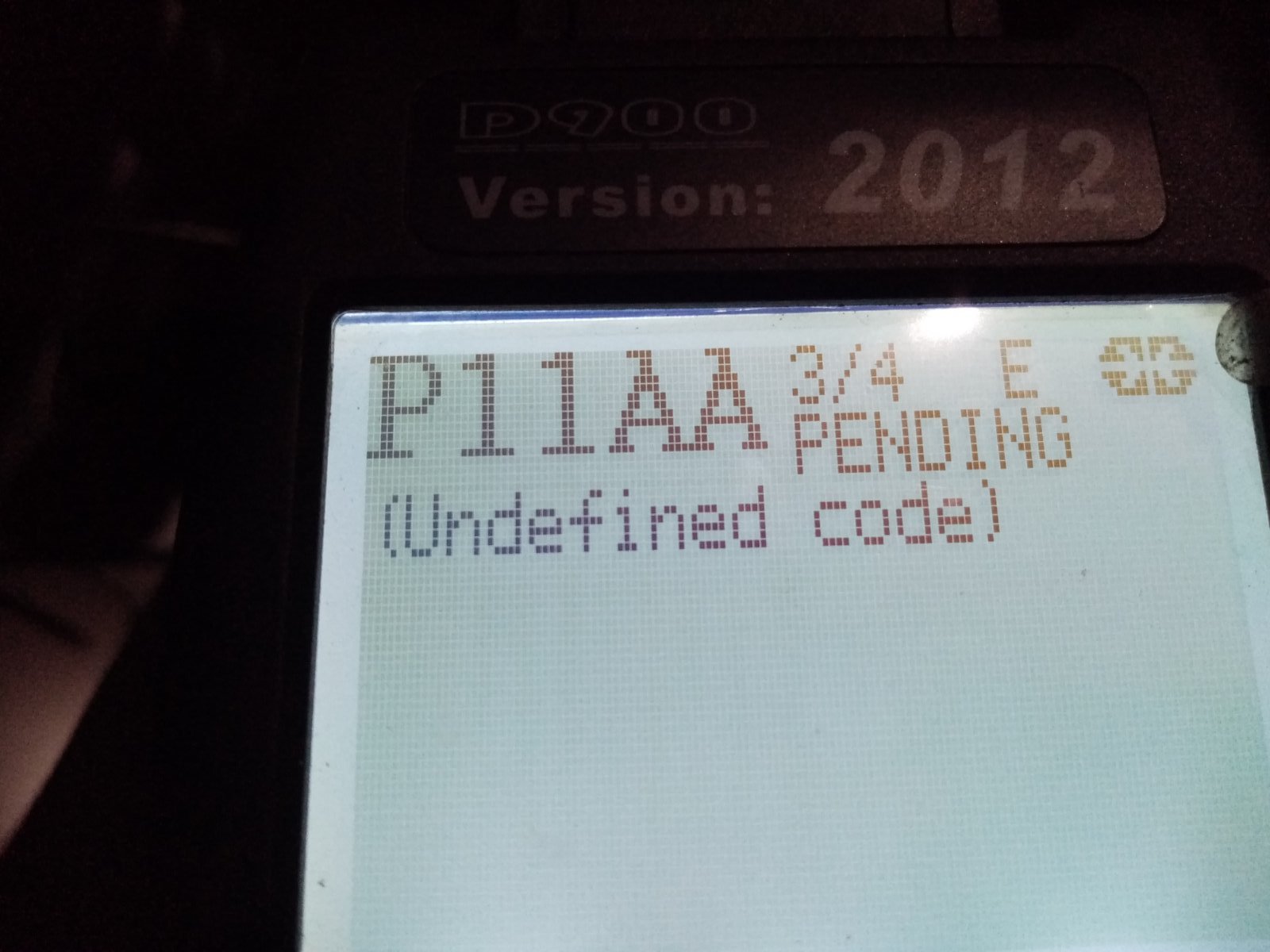

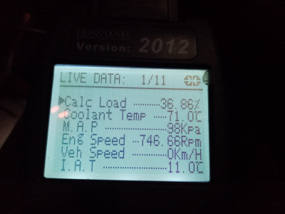

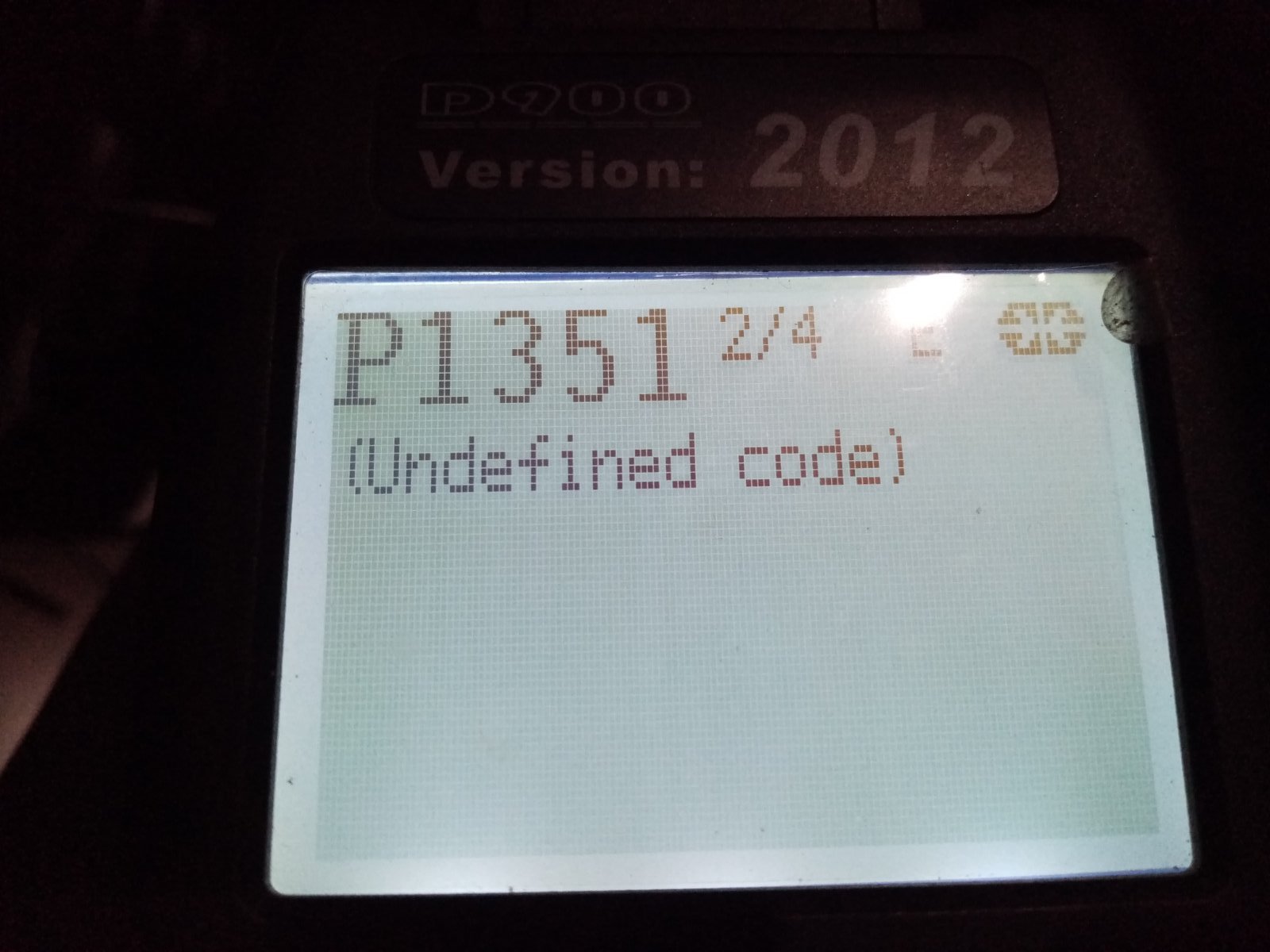

Re: Anti pollution fault
Morning all
7am
Well it happened again grrr
Although car did not cut out
Anti pollution mil is on but I have got these codes and live data but only from the tool I have in the car
Lexia comes later
Please see photographs. Attached
Regards
Steve
7am
Lexia comes later
Regards
Steve

- x 6945
Ignore the P1351 - it's on most diesels and is the Pre-heating relay circuit Coherence - Relay supplied and glow plugs not supplied. I had this for the entirety of my X7 ownership.
Your P11AA is Turbocharger pressure regulation solenoid valve control: Incoherence between the command and the measured turbocharging pressure.
There was a lot on this fault for the same engine as yours Steve - have a read:
viewtopic.php?t=63921&hilit=P11AA
Though Alasdair never came back with a final resolution, but it may give you some pointers and avoid replacing parts unnecessarily.
