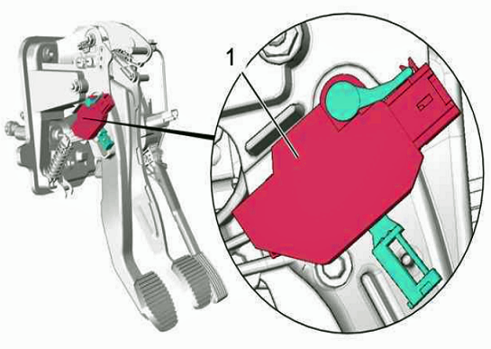

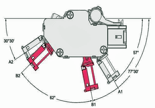

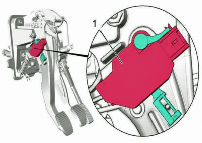

Re: 2.0 hdi Clutch issue (C5 x7 2009)
The clutch pedal switch informs the engine management ECU when the driver presses the clutch pedal. It is one of the methods used along with the brake switch for disengaging the cruise control.
The Clutch position sensor's role is to continuously measure the position of the clutch pedal. As the pedal is pushed down, the sensor voltage (0.56V to 4.43V) decreases.
Be wary about removing this though Steve as it will require recalibration if removed using Diagbox.

| (1) Clutch pedal angle position sensor. The sensor is of an angular potentiometry type. | Key: "A1": Manual stop (Start of travel) "A2": Manual stop (End of travel) "B1": Clutch pedal released position "B2": Clutch pedal pressed down position The working travel of the clutch pedal position sensor is 62 degrees. |

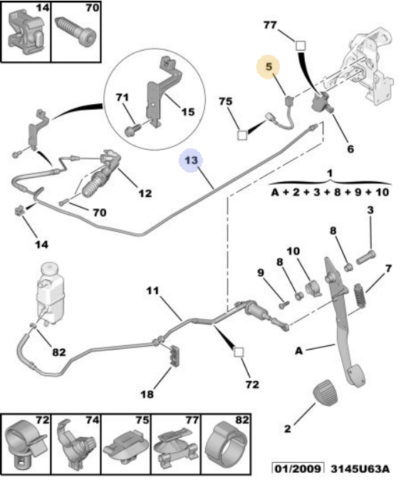

- x 6962
No, as you don't have the Electronic Parking Brake, you won't have the clutch angle sensor (6) Steve - just the clutch switch (5).
I can't see anything here that would be causing your issue - the clutch switch is just a make or brake switch.
