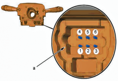

Steering Wheel Angle Sensor Connection
The steering wheel angle sensor detects the angular position and sends the information relating to the angle and speed of rotation of the steering wheel to the ECUs through the CAN IS network.
The steering wheel angle sensor is energised by a mechanical device which is moved by the rotation of the steering wheel.
The main functions of the steering wheel angle sensor are the following:
The Flywheel sensor is not on this Diagram - this is only for the ABS / ESP System.
| 6-way blue connector | |
| Channel n° | Allocation of channels of connector |
| 1 | IS CAN High |
| 2 | IS CAN Low |
| 3 | Earth |
| 4 | +APC |
| 5 | Channel not connected |
| 6 | Channel not connected |
- Calculation of the angle of rotation of the steering wheel
- Calibration function
- Calculation of the speed of rotation of the steering wheel
- Supply of the information to the CAN IS network
- Detection of electrical failures of the sensor
- Supply of a partial relative angle
- The steering wheel angle sensor is supplied with ignition positive.
- The electronic consumption of the sensor is below 150 mA under ignition positive.

Re: C3 picasso steering wheel angle sensor
So no way to know where the dreaded sensor go connected other than testing all the wires?
