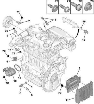

Where is the flywheel sensor?
I also believe is a wiring fault

Here are the various sensors for reference:
(3) Water Temp Sensor
(6) Engine Speed Sensor
(7) Camshaft Position Sensor
(8) Temperature Sensor
(9) Air Intake Pressure Sensor
(10) Mass Air Flow Meter
(11) Air Intake Temp. Sensor
(12) Diesel High Pressure Sensor

I cant see any Flywheel sensor on that drawing
Any ideas of where will be that joint between 9000B and 9000E? Thats the most likely place on where that CAN line may fail

No, the 71-- shown is the Power Steering ECU (only the relevant CAN connection). The steering wheel angle sensor is not shown separately anywhere.
The Flywheel sensor is not on this Diagram - this is only for the ABS / ESP System.
