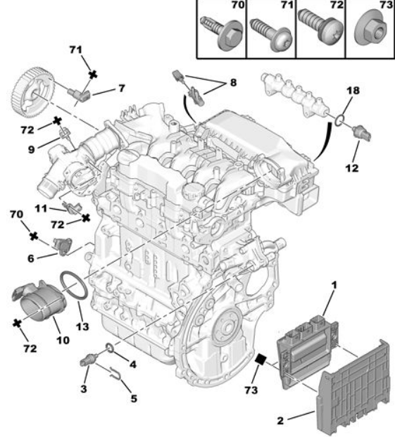

Here are the various sensors for reference:
(3) Water Temp Sensor
(6) Engine Speed Sensor
(7) Camshaft Position Sensor
(8) Temperature Sensor
(9) Air Intake Pressure Sensor
(10) Mass Air Flow Meter
(11) Air Intake Temp. Sensor
(12) Diesel High Pressure Sensor

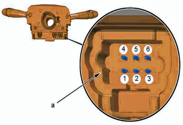

Steering Wheel Angle Sensor Connection
6-way blue connector
Channel n°Allocation of channels of connector
1IS CAN High
2IS CAN Low
3Earth
4+APC
5Channel not connected
6Channel not connected
The steering wheel angle sensor detects the angular position and sends the information relating to the angle and speed of rotation of the steering wheel to the ECUs through the CAN IS network.
The steering wheel angle sensor is energised by a mechanical device which is moved by the rotation of the steering wheel.
The main functions of the steering wheel angle sensor are the following:
  • Calculation of the angle of rotation of the steering wheel
  • Calibration function
  • Calculation of the speed of rotation of the steering wheel
  • Supply of the information to the CAN IS network
  • Detection of electrical failures of the sensor
  • Supply of a partial relative angle
Electrical features
  • The steering wheel angle sensor is supplied with ignition positive.
  • The electronic consumption of the sensor is below 150 mA under ignition positive.
