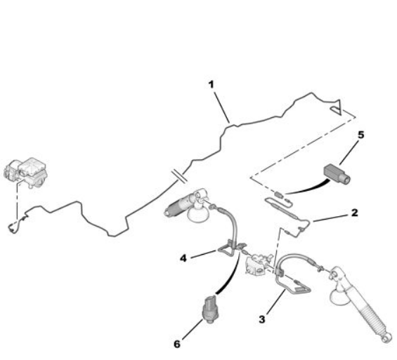

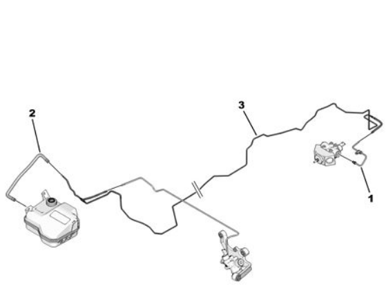

Sorry Kenny - I've only just seen your post - catching up. Here's the rear pipes - Supply and Return with part numbers if you don't already have these.KennyW wrote: 04 Oct 2020, 17:30 Until I have the fuel tank removed I don't know which pipe it is but I suspect supply pipe rather than the return.
I think it maybe a bubble type flare.
I've looked at service box but can't find anything directly related to the pipe.
Marc, can you look if possible my VIN is VF7**************[VIN obfuscated, can be read by forum staff].
Kenny

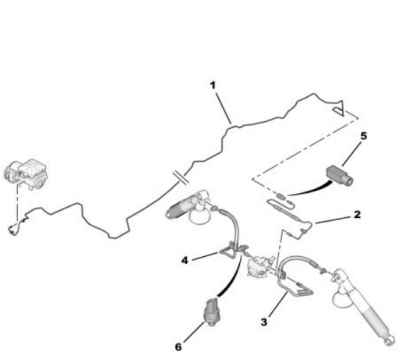

Return Piping Rear Suspension (1) Hydraulic Oil Back Harness: 5270SE (2) Hydraulic Oil Back Harness: 5270VV (3) Hydraulic Oil Back Harness: 5270WR | Supply Piping Rear Suspension (1) Hydraulic Tube: 9807562180 (2) Hydraulic Tube: 5270VP (3) Hydraulic Tube: 5270VG (4) Hydraulic Tube: 5270VF (5) Hydraulic Pipe 2 Way Union: 5280T3 (6) Pressure Sensor: 5273A2 |

Thanks Marc,
It's no 1 that has failed just above the fuel tank. All I need to know is the seal sizes. This is about 4.80mm dia pipe. seal required 5.5 x 4.5 x 1.0.
No 3 is also removed from 2 way union and this pipe is about 3.5mm Seal 4.5 x 3.5 x.1
Can't find anything giving sizes as seals are prefitted to part.

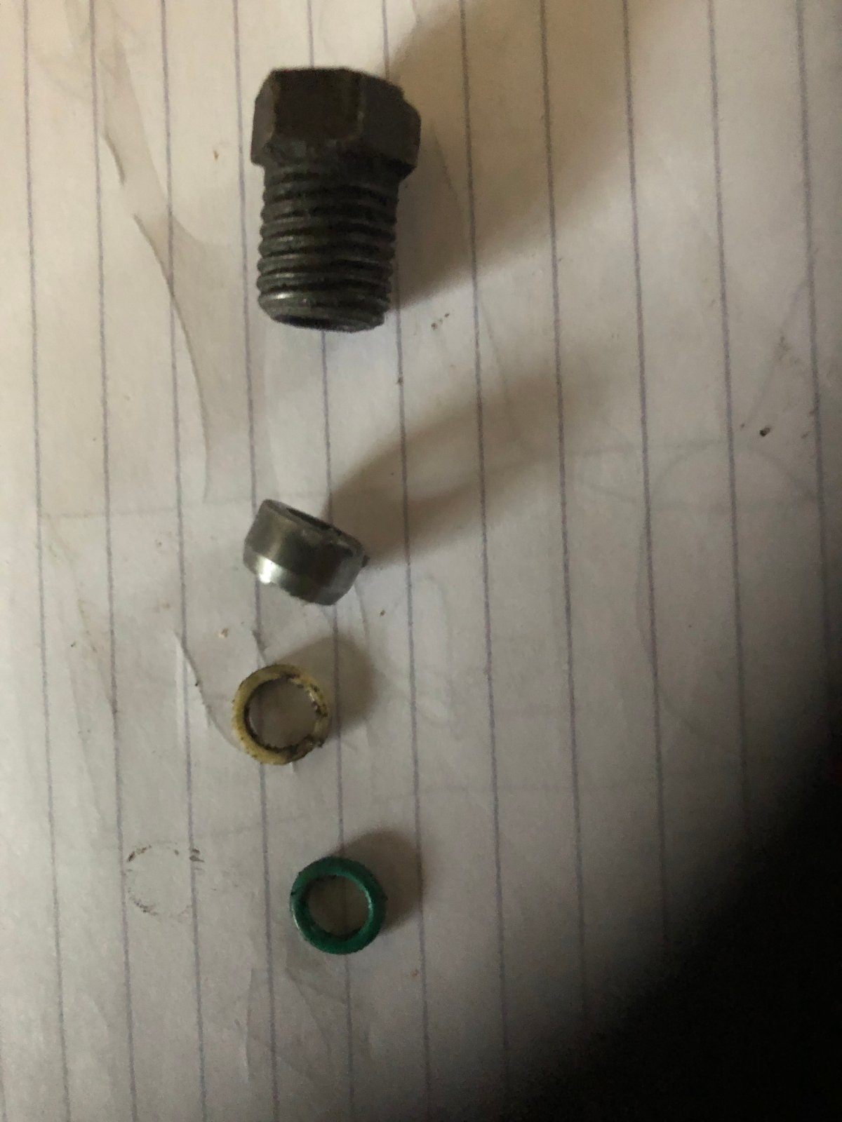

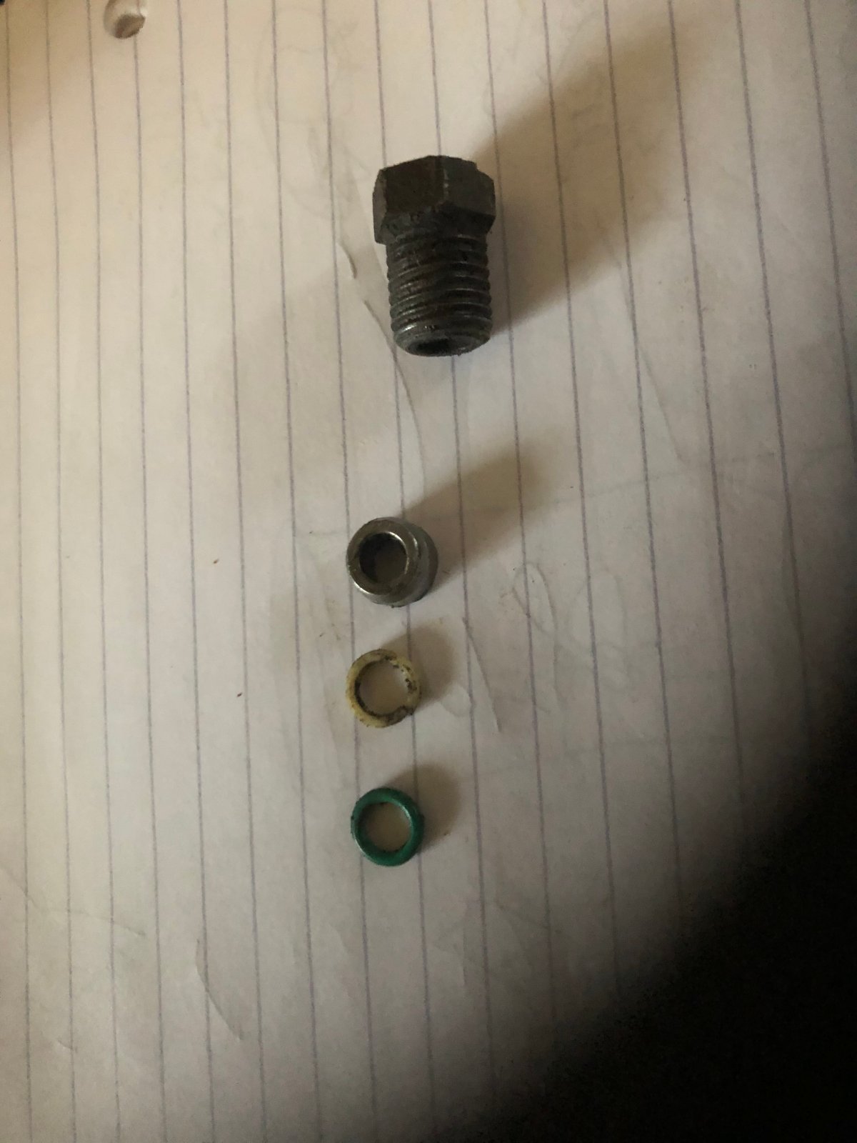

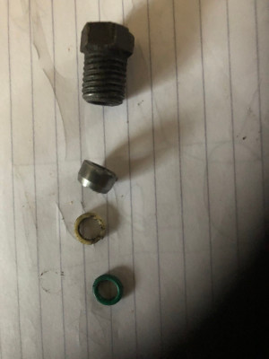

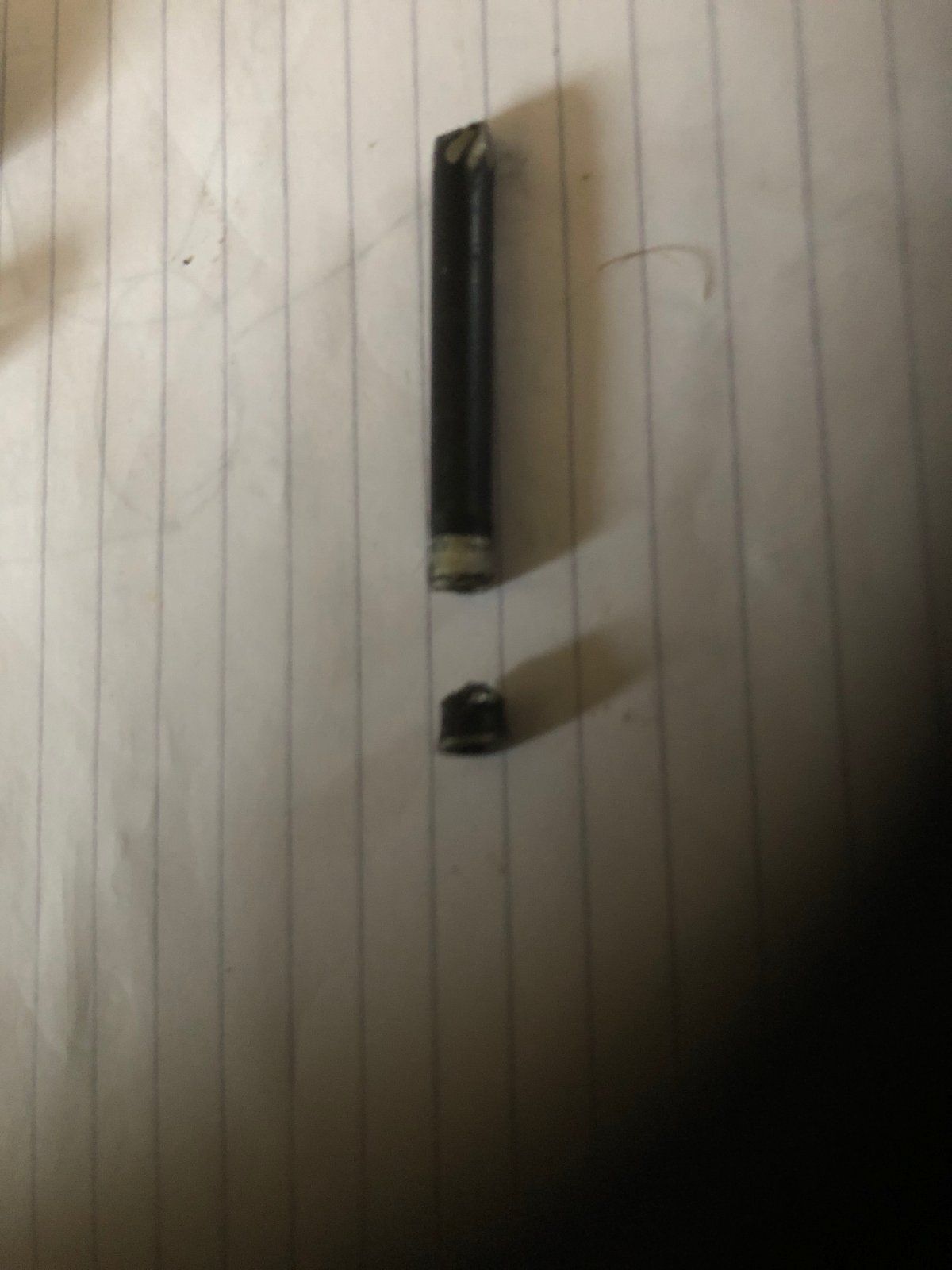

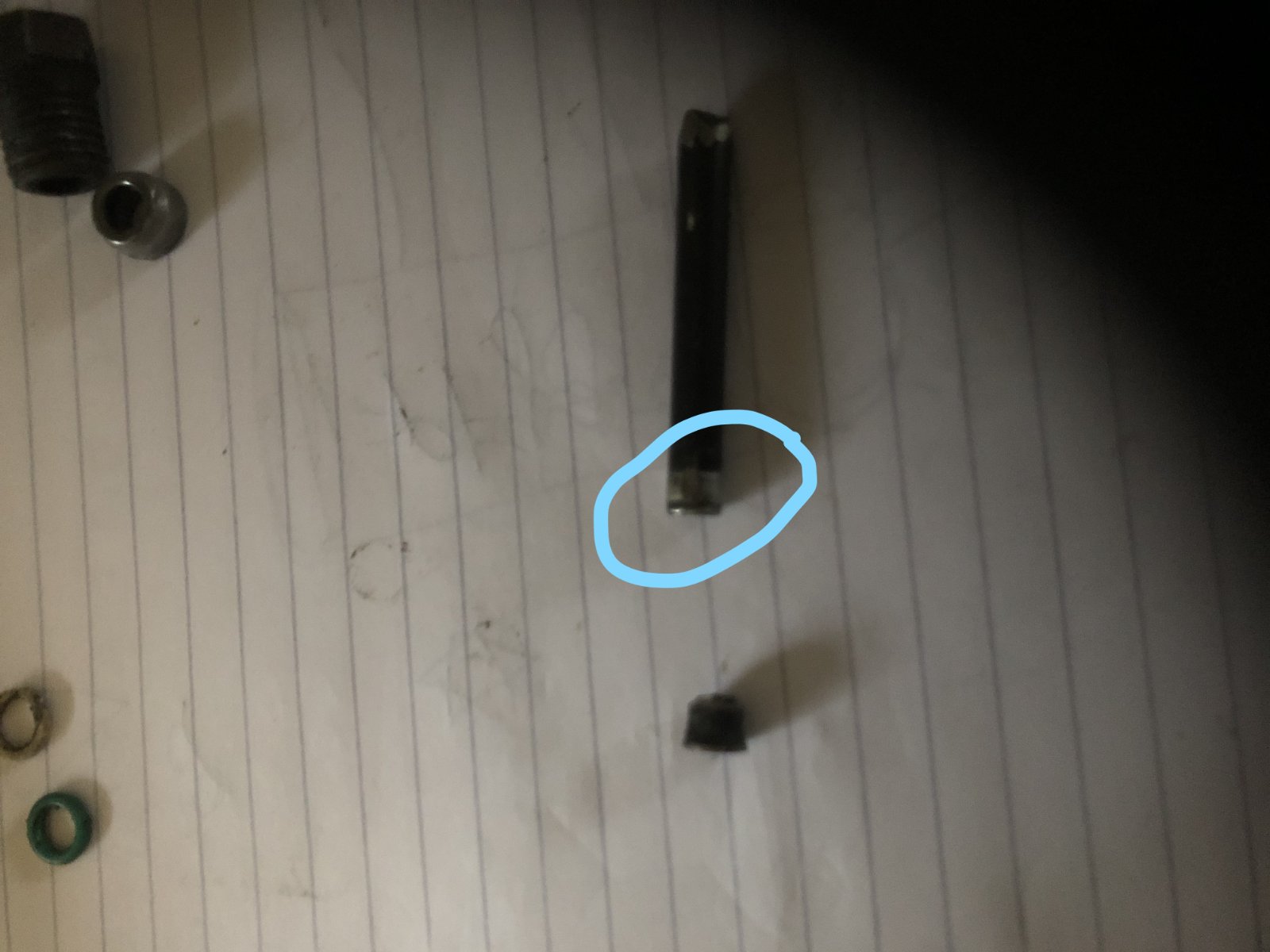

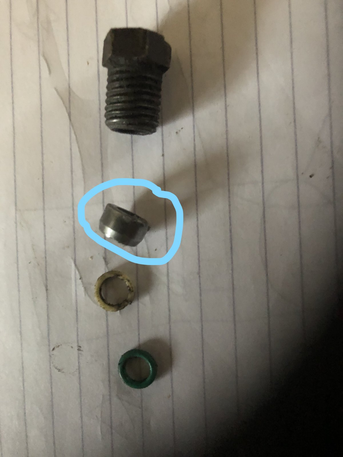

An update, I have removed the pipe and it is a tiny hole the size of needle where the LDS came out.
I have removed the flare ends and this is what I found:
The pipe end appears to have single flare or is it the pressure of the pipe being screwed in causing the flare.
The pipe end would also appear to have a citroen bubble as per xantia's etc.
As per photo
Circled is the citroen bubble and in the next photo metal 'seal' is forced over bubble flare.
Can anybody confirm my thoughts ?
Kenny

Nope
It resembles an adapter part for transferring the nut's axial clamping force over the smaller PTFE (I presume) back support washer for the green O-ring...
