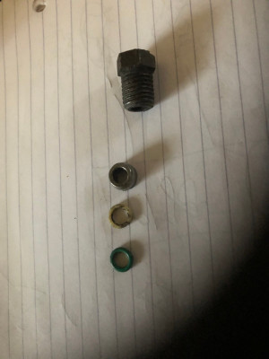

An update, I have removed the pipe and it is a tiny hole the size of needle where the LDS came out.
I have removed the flare ends and this is what I found:
The pipe end appears to have single flare or is it the pressure of the pipe being screwed in causing the flare.
The pipe end would also appear to have a citroen bubble as per xantia's etc.
As per photo
Circled is the citroen bubble and in the next photo metal 'seal' is forced over bubble flare.
Can anybody confirm my thoughts ?
Kenny

Nope :)
It resembles an adapter part for transferring the nut's axial clamping force over the smaller PTFE (I presume) back support washer for the green O-ring... 8-)
Only himself the stupid makes wrong, many are being confused by the clever :P

Re: Burst suspension pipe at rear
Unread post by KennyW »
Thanks for the reply,
Just a more complicated version of the Xantia and previous hydraulic citroens then !
Kenny
