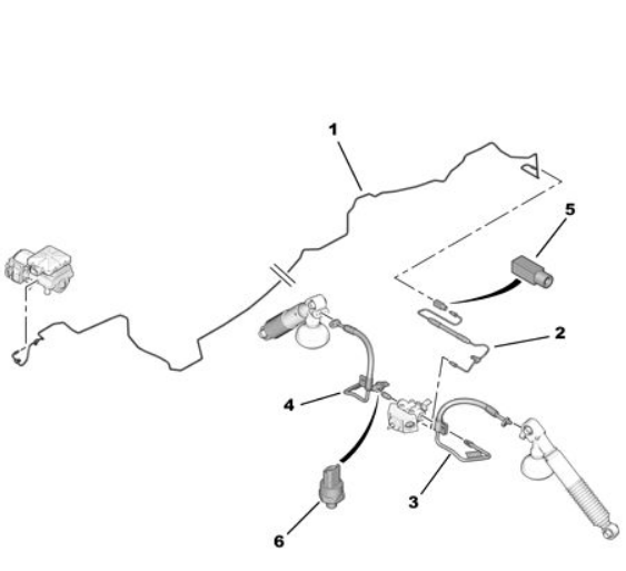

Well as the title states, I've got rupture in my supply pipe running from front to rear.
The fracture appears to be above the fuel tank. I can't get any closer to confirm. So it looks like fuel tank out to check and fix.
Marc, Can you confirm the part no's for the pipe. I have 5270vp and 5270 wp there's also and 2 way joint.
Here's the VIN VF7**************[VIN obfuscated, can be read by forum staff].
Kenny

Here's the rear supply piping Kenny:
5270VP is the part for item (2) £165.05
9807562180 is the part for item (1) £295.81
5280T3 is the part for the 2 way union item (5) £20.92
Prices as of today from Citroen inc. VAT.
Let me know if there's any other parts you need.
