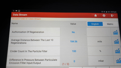

The cars live data before going on a little run to try and do a driving force regeneration was:
at tick over
dpf pressure sensor: 6 mbar
soot:3.38 g/l
ash/cinder in the particle filter 100%
after trying to perform a driving regeneration which failed it would not perform one i am assuming this will be because certain parameters are not met like the ash deposited in the dpf ash/cinder reaching 100%

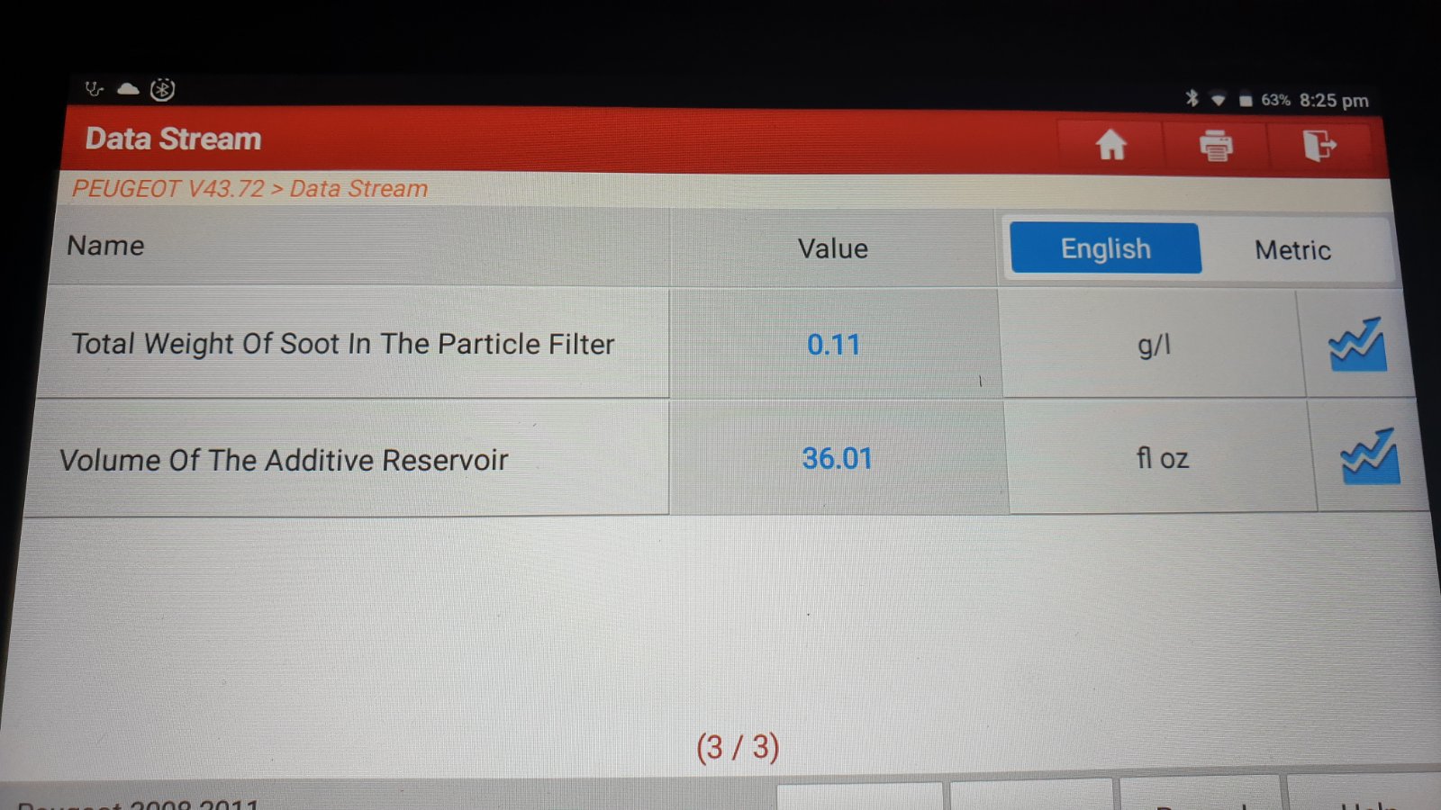

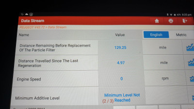

but on the way back home the car did a regen itself and after this the live data said
at tick over
dpf pressure sensor: 5 mbar
soot: 0.11 g/l
ash/cinder in the particle filter 100% (this did not change)
and distance travelled since last regeneration: 4.97 mile
i was going to have a go and try and get the scan tool to do a static regen but i have been reading online and when the ash/cinder load gets above 90% a force regen will not work

Here a link to the live data after a force regen
These are stationary data readings
These are driving data readings

heres a link to the refill of the additive tank hopefully it may help some one

Ok, so I know that the DV6TED engines have an expected Particle Filter life of 180k KM or 111k Miles approx, so the current issues would suggest it is at end of life.
koikidder
Posts: 26
Joined: 31 May 2020, 13:24
Re: 2010 1.6hdi 3008 additive level too low help needed
Unread post by koikidder »
GiveMeABreak wrote: 10 Sep 2020, 18:26 Ok, so I know that the DV6TED engines have an expected Particle Filter life of 180k KM or 111k Miles approx, so the current issues would suggest it is at end of life.
i just spent 10 minutes replying and i think i hit the wrong bloody button as its not showing up :lol:
yes you are right but after doing some reading on the pressure sensor data it is still saying its perfect so i have just told the ecu a new one is fitted so the data now reads 0% soot content and replacement needed at 111000 miles.
I think that if the dpf gets blocked that it will throw up a dpf pressure sensor code and i will then get it cleaned or replaced.
