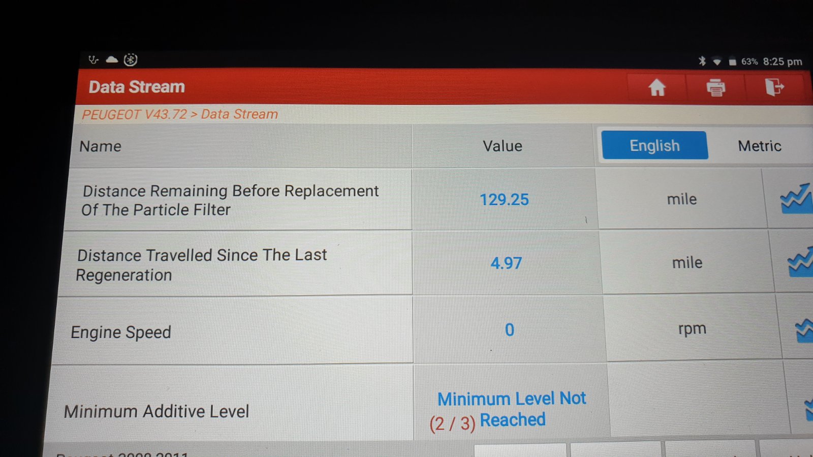

The cars live data before going on a little run to try and do a driving force regeneration was:
at tick over
dpf pressure sensor: 6 mbar
soot:3.38 g/l
ash/cinder in the particle filter 100%

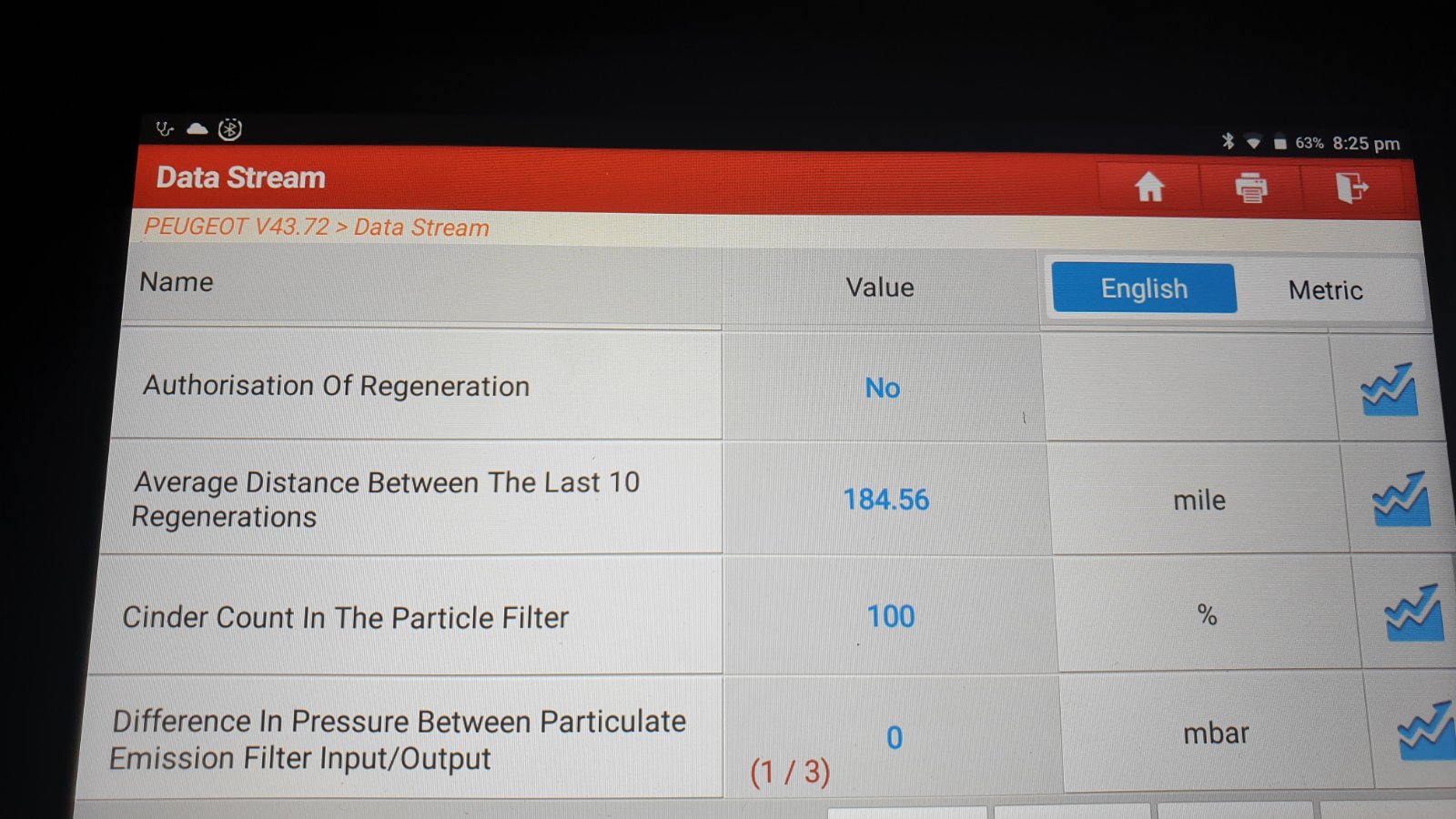

after trying to perform a driving regeneration which failed it would not perform one i am assuming this will be because certain parameters are not met like the ash deposited in the dpf ash/cinder reaching 100%
but on the way back home the car did a regen itself and after this the live data said
at tick over
dpf pressure sensor: 5 mbar
soot: 0.11 g/l
ash/cinder in the particle filter 100% (this did not change)
and distance travelled since last regeneration: 4.97 mile
i was going to have a go and try and get the scan tool to do a static regen but i have been reading online and when the ash/cinder load gets above 90% a force regen will not work

yes you are right but after doing some reading on the pressure sensor data it is still saying its perfect so i have just told the ecu a new one is fitted so the data now reads 0% soot content and replacement needed at 111000 miles.
I think that if the dpf gets blocked that it will throw up a dpf pressure sensor code and i will then get it cleaned or replaced.
