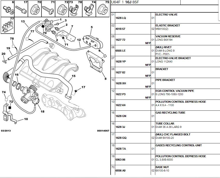

Every time I have changed an EGR valve it was low down on the back of the engine, loads of stuff to remove to get at it usually a couple of secret bolts too.

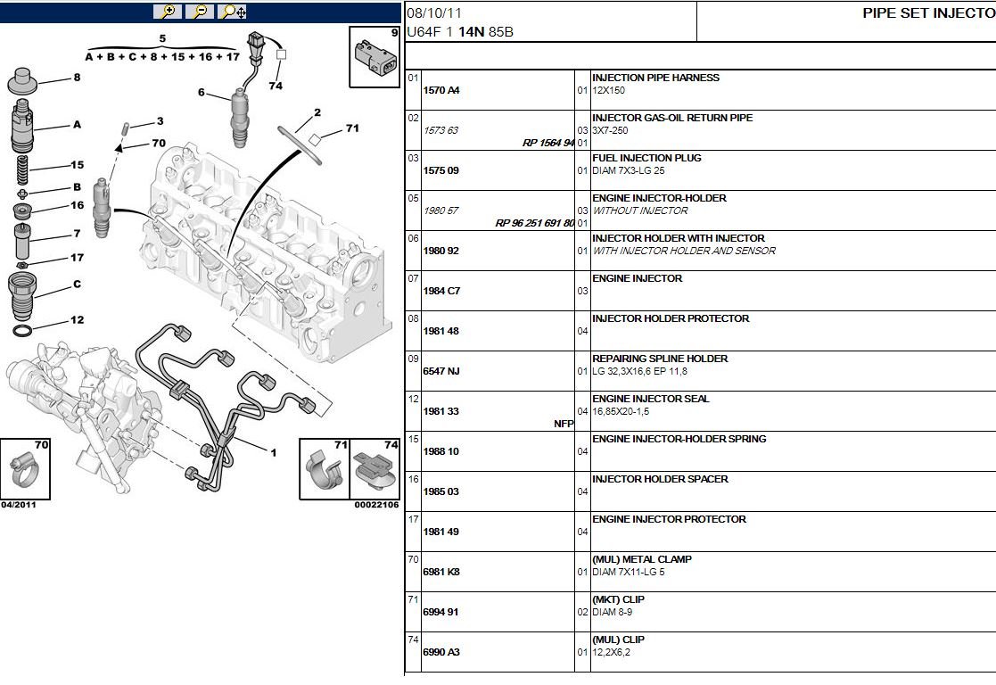

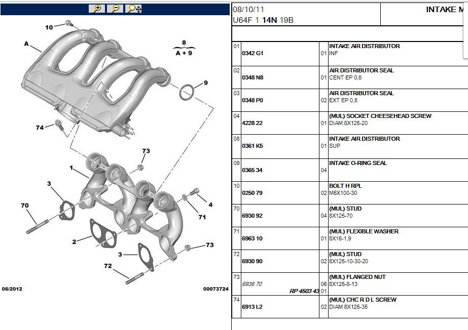

Looks like the EGR might be screwed into the intake manifold?
Injector pipes were only available as a complete set
Apparently still available, but at £96 a set. You might be able to get one off a scrapper, but this engine is pretty long in the tooth now, so perhaps not...

Does look like screw-in (with sealing rings) from the photo above.

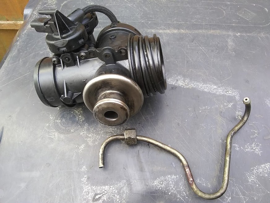

Have you really got a split steel injector pipe? Most unusual.

I thought it was the pipe bringing fuel to the injector pump that split?

Right, managed to twist the egr off. It just unscrews but was pretty stuck. Managed to break the nozzle on the fuel housing lid in the process so have had to order another £16.89 for lid & clamp on ebay (pattern parts). Also bought a new Clip for egr (4.99 on ebay)
Luckily removing the egr left me enough space to remove the broken injector pipe. So pleased I didn't need to remove manifold
Very grateful to Casper from dispatchexpertscudo.org for telling me how to remove egr. I never would of worked out that it unscrewed.
Just waiting on the parts now. Will update when fitted. Hoping I haven't damaged engine. It gave a terrible death rattle before stalling.
Thanks Richard for the diagrams and parts info. That's a great help.
