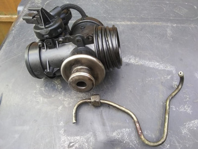

Looks like the EGR might be screwed into the intake manifold?

Right, managed to twist the egr off. It just unscrews but was pretty stuck. Managed to break the nozzle on the fuel housing lid in the process so have had to order another £16.89 for lid & clamp on ebay (pattern parts). Also bought a new Clip for egr (4.99 on ebay)
Luckily removing the egr left me enough space to remove the broken injector pipe. So pleased I didn't need to remove manifold
Very grateful to Casper from dispatchexpertscudo.org for telling me how to remove egr. I never would of worked out that it unscrewed.
