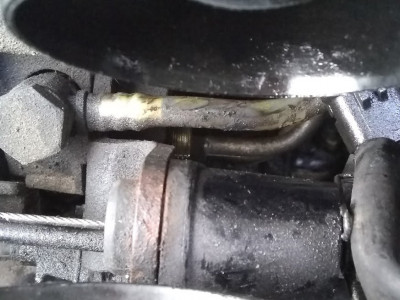

Would very much appreciate some help/advice on my diesel leaking problem. Was having a great time stealth camping in Scotland before I got a strong whiff of diesel and a small puddle appeared. I braved it and started my drive back. Managed 90 odd miles before she packed up and thankfully got home with Green Flag recovery. I've been out there this morning and found a metal pipe leading to the pump has totally split. I've enclosed a pic. Sorry for poor quality. Am i right in thinking this is an injector pipe? I am a novice mechanic but if it's just a case of changing a pipe i'd like to have a go myself. How easy is it to remove the MAF sensor? I can't see a clip on it.

Sorry just realised it's not a Maf it's part of the plastic inlet manifold. How is that removed please?

First things first - put you VIN up so we know exactly what engine you have - we'll need t his for part info anyway.

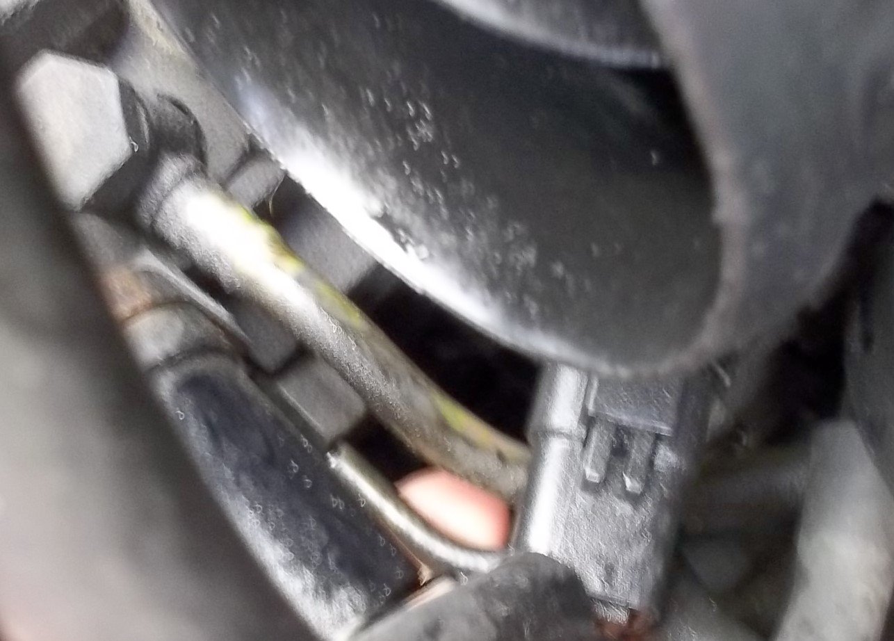

I've included a better photo. I've just managed to undo the nut.

I think it's a throttle body. Can't see any screws/torx etc. Does anyone know if they are just a push fit into the inlet? Really don't want to force anything until I know. I've located torx screws on the inlet itself but don't have the tools to remove back ones...so little space. Would make it possible to do though if I can remove the 'throttle body' on it's own.

Can you take a photo further out, can't make you exactly where you are looking?

Hi Richard, thanks for reply. I will take one in the morning. I now know from looking at parts on ebay it's the egr and i'm pretty sure it just pushes in.
x 1746
Re: Expert 1.9 Split pipe help please
Better photos needed, then we should be able to post the relevant parts diagram.
