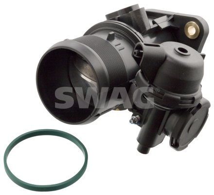

Hi. I had similar problems on my C5 for a long time. Garage checked EGR, changed solenoids and some sensors but no change.... P11AA back every few days for the last 20.000 km and black smoke sometimes lots of it when pushed hard.
Also consumption of diesel rised for cca 1l/100km
I had enough and did some research on my own and bingo! Problem with air leak when under pressure from turbo. Leakage was wery small but big enough to see some black oil sludge between air doser and manifold connection. If thick oil can come out how could than hold pressurised air... I solved this leak with putting some thin epdm rubber ring under the green square profile ring seal to push it out for 0.5 mm and now runs fine again. Also consumption felt down to normal.

You also had that weird noise? And problems with slow speed?Gregor wrote: 06 Jan 2021, 18:00 Hi. I had similar problems on my C5 for a long time. Garage checked EGR, changed solenoids and some sensors but no change.... P11AA back every few days for the last 20.000 km and black smoke sometimes lots of it when pushed hard.Also consumption of diesel rised for cca 1l/100km
Also can you make a photo what you fixed? The part

Re: Peugeot 5008 2.0hdi P11AA P0234 strange turbo noise
When you will take off that air dosier clean pressure sensor niple and temperature prrobe in it and chech if flap inside is moving ok. There will probably be a lot of sot inside housing. I suspect that that part of that strange sound is comming from this part also. Do your DS smoke black when pressed hard?
